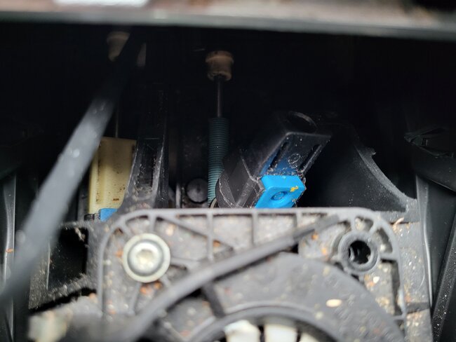

So, my car won't select gears, I have had a look and the rod that selects gears has come out of the little box on the bottom of the gear stick just wondering if there is an easy way to put this back in.

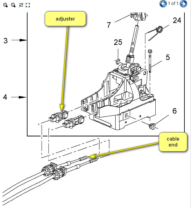

Your vehicle is equipped with the 6 speed F40 transmission.
It looks like either the holding bracket or selector cable end might be damaged.
See image 2.

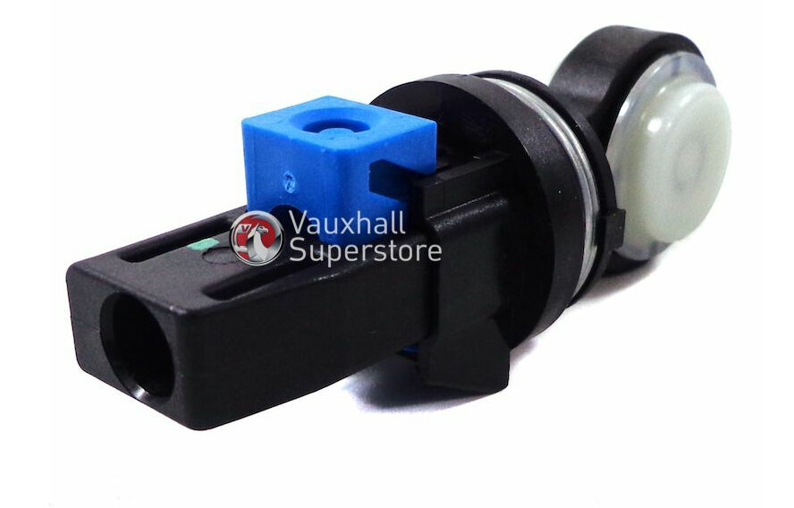

You can try and push back the adjuster bracket and reinsert the cable end.
You will need to depress the blue locking block, see image below.
A good link:
https://workshop-manuals.com/vauxhall/astra-j/transmission/transaxle/manual_transmission_f40-6/repair_instructions_on_vehicle/manual_gearbox_gear_lever_and_selector_lever_cable_adjustment/
A new adjuster is available from Opel/Vauxhall under part number 55597766.
