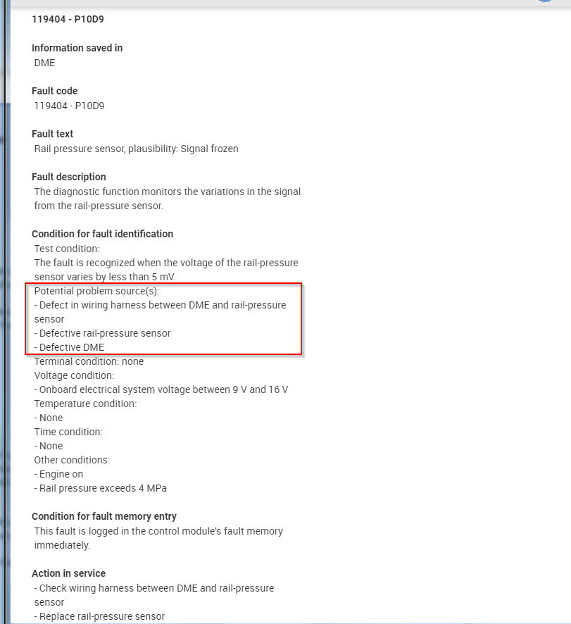

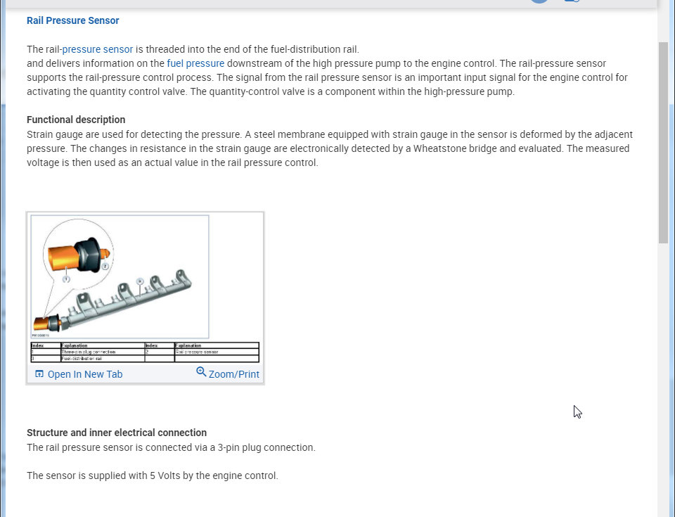

I attached the info on this code. If you replaced the pressure sensor then the other possible causes are wiring or the Digital Motor Electronic control module.

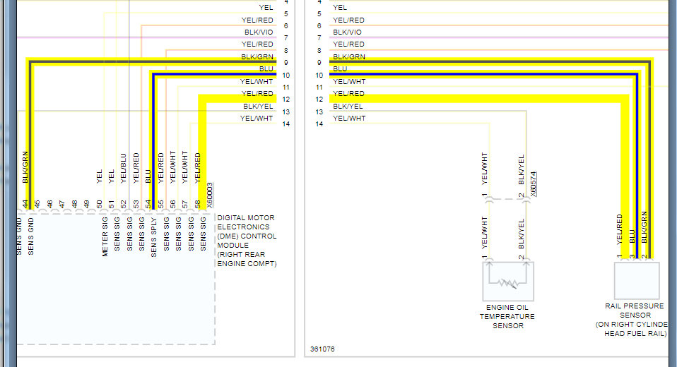

Take a look at this info. You need to monitor voltage from the sensor to the DME at the DME and see what it is on each wire. I attached the wiring diagram. Let me know what you find on each wire and that will tell us if the wiring is okay. If it is then the DME is the issue.

The P10D9 indicates there is less than 5 mv variation sent from the fuel rail pressure sensor. Basically, it appears frozen to the PCM. Did this happen since you replaced it? If it has, I have a feeling the sensor is bad. Other than the sensor, it could be a wiring issue or the DME itself could be bad. Confirm there is no corrosion or damaged pins at the connections.

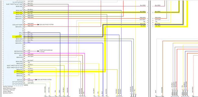

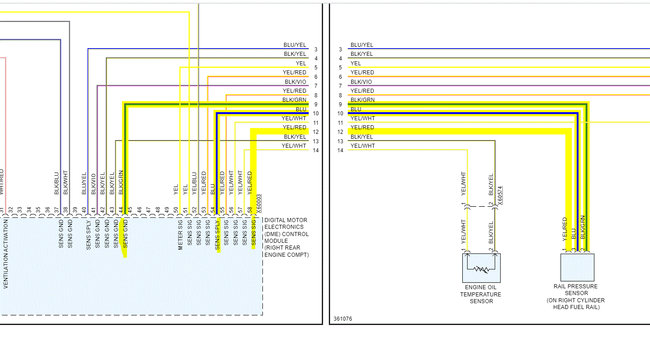

I have attached two pics below. One is for the low pressure fuel sensor (pic 1) and the other is the fuel rail pressure sensor. The schematics show the pin orientation at the DME. I would check to make sure there isn't an issue with the connection.
