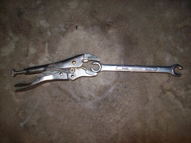

Hello, I am trying to replace my old steel brake lines along with the proportioning valve, and the soft lines going to the calipers on my vehicle. However, all the bolts are frozen in place and I cannot unscrew any of the lines. They are unscrewed at the master cylinder but cannot be undone anywhere else. I also cannot remove most of the clips where the hard lines connect to the soft lines. I was able to remove one of the clips that hold the hard line in place where it connects with the soft line, but cannot move the lines. How can I loosen everything up to remove them? Will I need to resort to just cutting all the lines out? I tried pb blaster but it does not help.

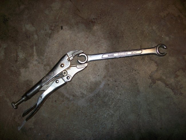

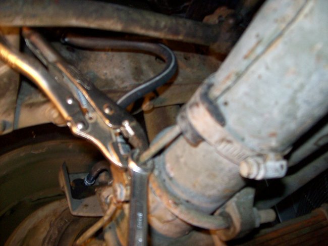

I found a method that works really well just to break them loose. Then you can continue the normal way with the wrench.
The trick is to use vise grip pliers!
Not on the nut on the wrench
Sorry this took so long.
In my pictures below (which I had to download new drivers in my computer to read them, dang Grand youngins!) My computer guy had to figure out what had changed, good thing I fix his Jeep!
I could not find a pair of small "needle nose" vise grips for the pictures, They work the best in a tight spot. The original kind can work too.
Position the pliers so they don't "bottom out" we only have to break the threads loose. Less than a 1/4 turn. Then even a regular wrench should back them the rest of the way out.
When you are "pulling" the flare wrench, you need to be back-holding the other part with a wrench too. Basically, this equalizes the pressure and the goodies in-between the wrenches should not move around which might bend or break something on down the line.
Sometimes a quick love tap to the flare wrench with a hammer will break the bond of the threads.

vise grips (regular or needle nose) will keep your flare nut wrenches from stretching and stripping and gripping really well!
Just have to break it loose, then you are home free!
