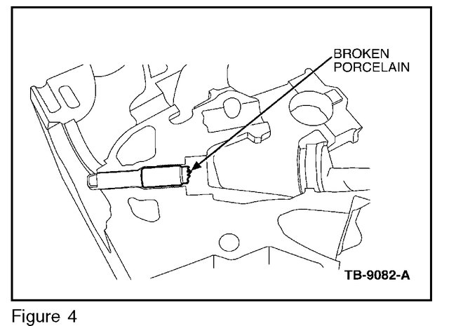

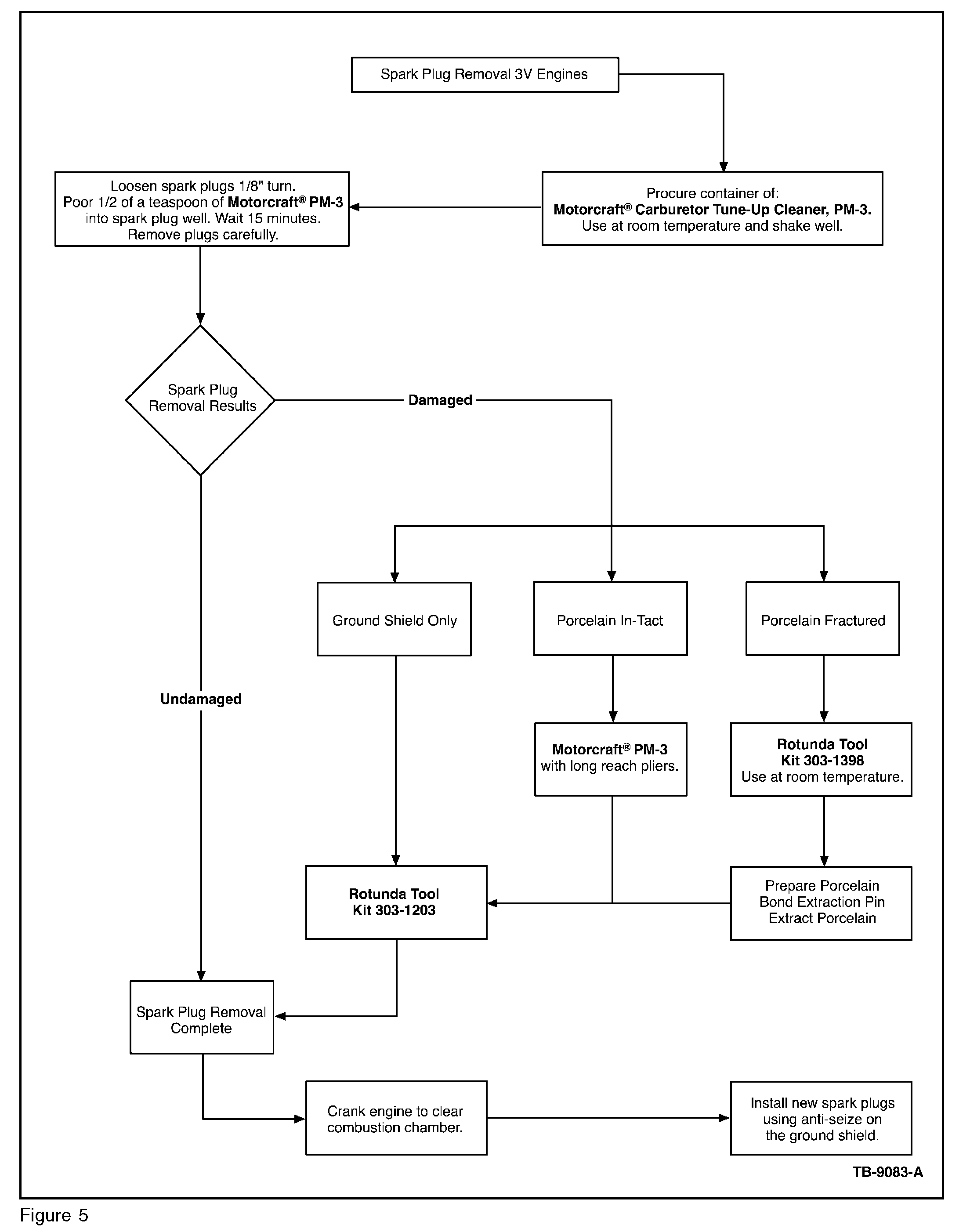

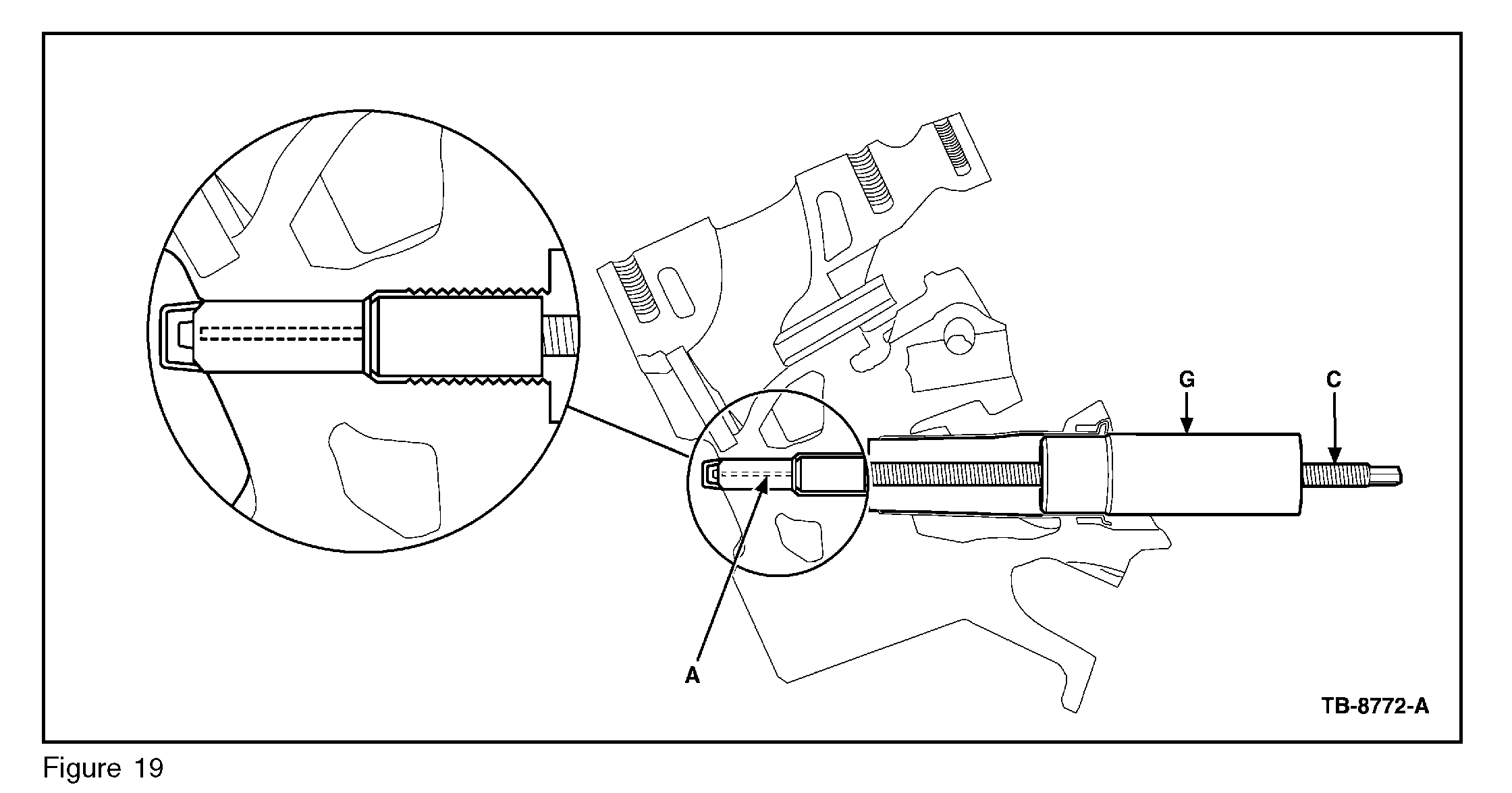

Changing #8 spark plug, plug crumbles, leaving bottom of plug below threads stuck. Got the porcelain out but now shell is stuck. Any ideas?
Jul 19, 2019 at 11:14 AM
SCGRANTURISMO
  • 4,897 POSTS
The bottom of the spark plug, where the threads are has fallen through the cylinder head, so it's not screwed into the head anymore? If this is the case you should be able to pull it up with a magnet. You are going to have put a heli coil in the spark plug socket once you get the spark plug out as well. Please get back to us if this is case.

If the threaded part is still in the cylinder head, you need to get a spark plug extractor to remove it. There is actually a tool that is made to remove that. Also, there is a technical service bulletin regarding removal of a broken plug. I am going to provide the directions from the TSB. The attached pictures correlate with the directions. However, you will need the proper tooling.

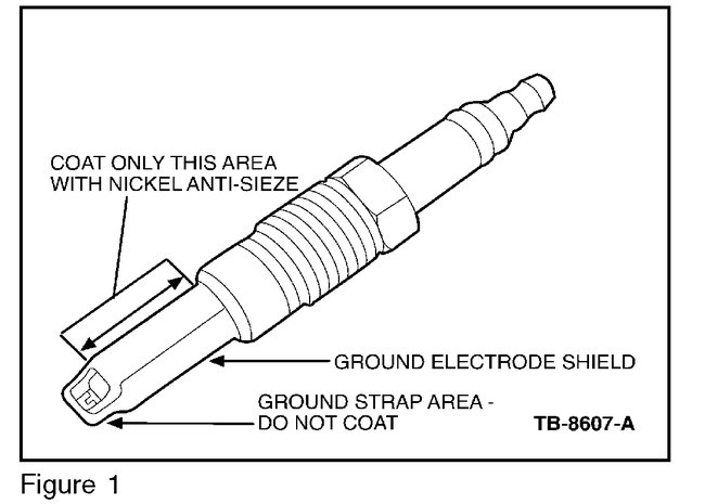

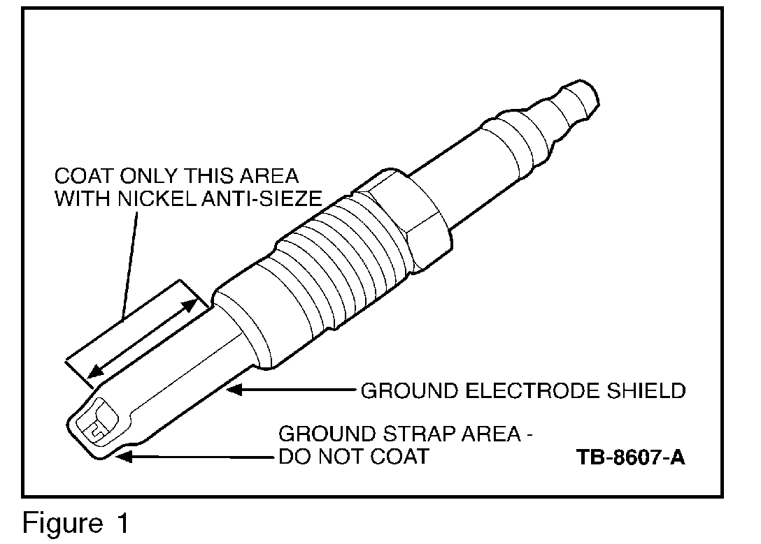

NEW PLUGS SHOULD BE INSTALLED USING A FILM COATING OF MOTORCRAFT HIGH TEMPERATURE NICKEL ANTI-SEIZE LUBRICANT ON THE GROUND ELECTRODE SHIELD. DO NOT COAT THE ELECTRODE STRAP. (Figure 1)
Separated/Broken Spark Plug Removal
If the spark plug separates after following the Spark Plug Removal Procedure, it will fail in one of three modes. Refer to the appropriate removal procedure as required.
pic 2

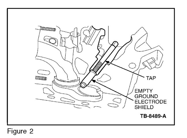

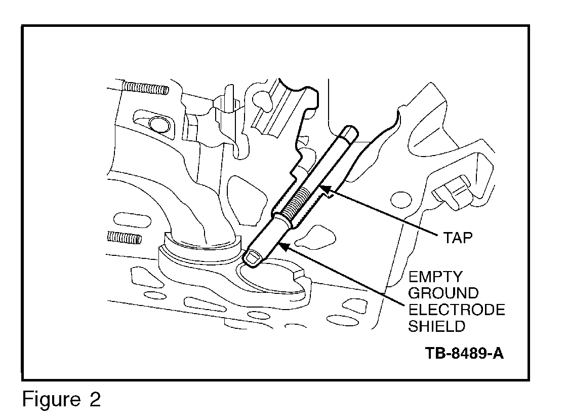

a. Mode 1: The ground electrode shield is left behind as an empty shell. (Figure 2)
pic 3

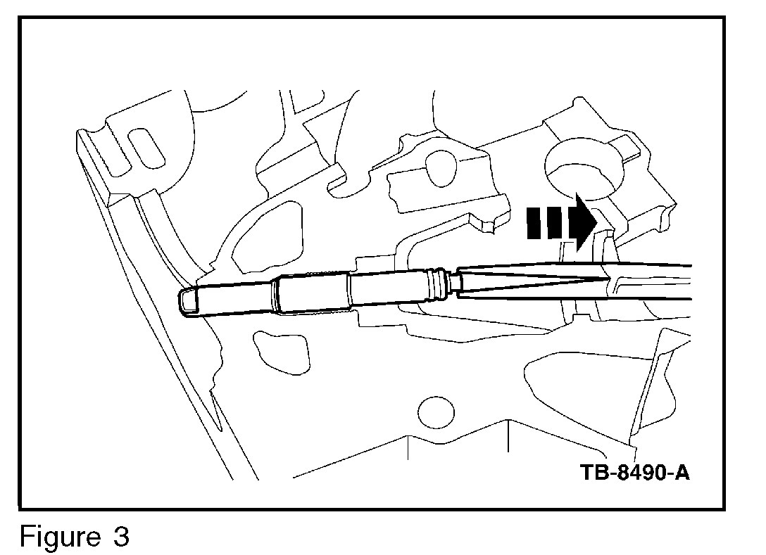

b. Mode 2: The entire porcelain insulator and ground electrode shield remains in the cylinder head. (Figure 3)
pic 4
c. Mode 3: The upper section of porcelain broke off with remaining porcelain left inside the ground shield. (Figure 4)

Flowchart of procedure. (Figure 5)

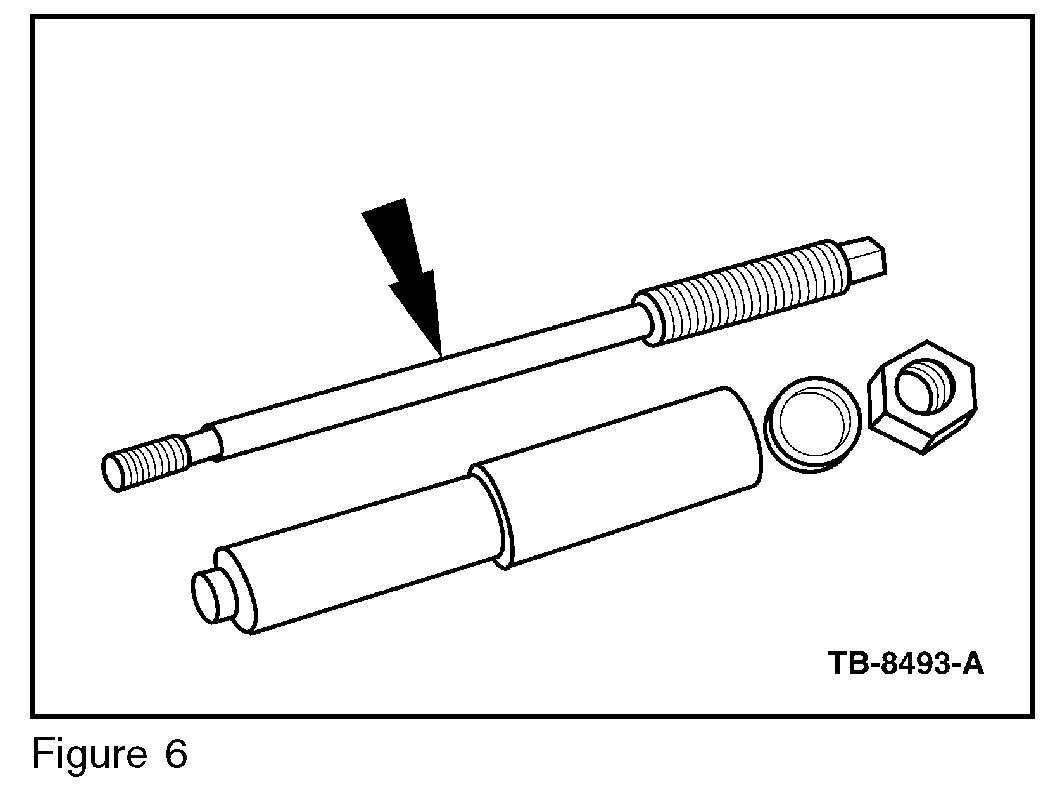

pic 6
Use Rotunda special service tool 303-1203 to remove an empty ground electrode shield from the cylinder head. (Figure 6)
NOTE
THIS TOOL IS ONLY DESIGNED TO WORK WITH AN EMPTY GROUND ELECTRODE SHIELD. IF PORCELAIN REMAINS, PROCEED TO MODE 2 OR 3 REMOVAL.
pic 7

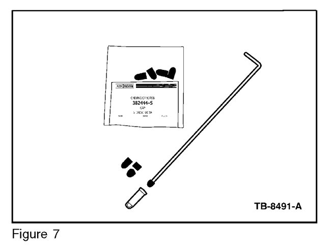

1. Modify vacuum cap to a 3/8" (10 mm) length for each ground electrode shield that needs to be removed. (Figure 7)
2. Use the installation rod (J) provided with service tool 303-1203 update to install the modified vacuum cap. Push the cap into the ground shield down to the electrode strap. This will plug and protect the combustion chamber from contamination. (Figure 7)

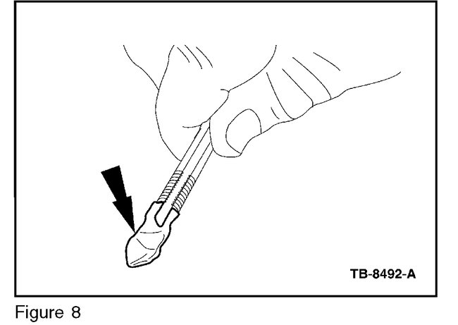

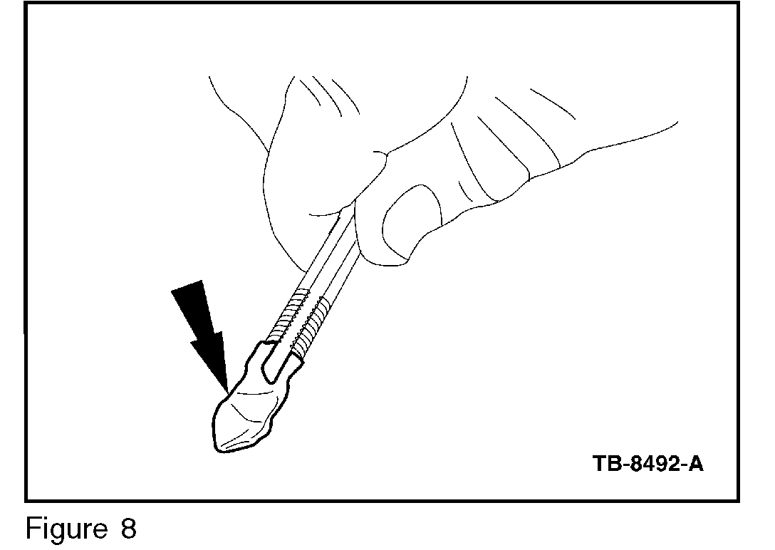

3. Thread-tap the ground electrode shield using a 9.0 x 1.0 mm plug tap (tap profile is about 3-4 reduced diameter threads on the tip end).
pic 8
a. Coat the end of the tap with general purpose grease. (Figure 8)
b. Turn the tap about 3 to 4 turns into the ground electrode shield. Back the tap up frequently to break chips and avoid cut material from coiling-up in the spark plug well. A tap socket adaptor (K) is provided with service tool 303-1203 update to connect the tap to a 3/8" socket drive.
CAUTION
DO NOT ATTEMPT TO REMOVE THE GROUND ELECTRODE SHIELD WITH THE TAP AND WRENCH. THE TAP MAY BREAK IF THIS IS ATTEMPTED.

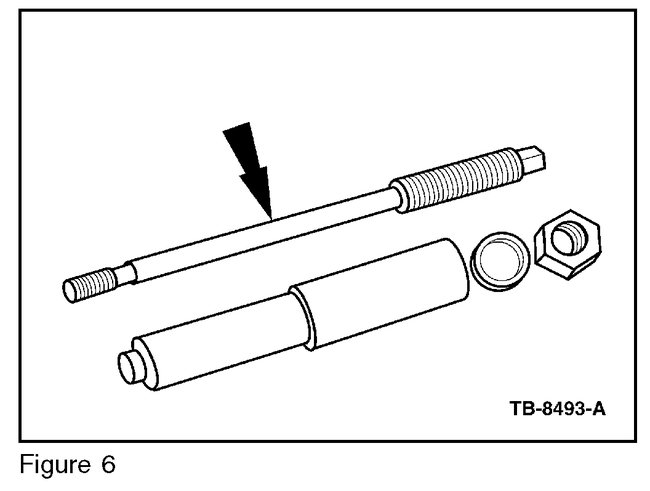

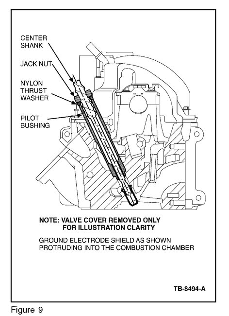

4. Thread Rotunda special service tool 303-1203 into the ground electrode shield. (Figure 9)
a. Install the stepped end of the tool pilot bushing into the spark plug well ensuring it bottoms out.
b. Screw the center shank into the ground electrode shield. Do not over tighten the shank, to prevent thread stripping.
c. Install the nylon washer and jack nut until finger tight.
d. Turn the jack nut until the ground electrode is freed from the cavity and withdraw the tool assembly.

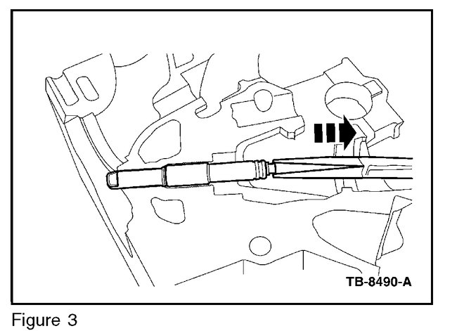

Mode 2 Procedure:
1. Add an additional 1/2 teaspoon Motorcraft Carburetor Tune-Up Cleaner fluid into spark plug well and allow 15 minutes of soak time.
2. Using long-reach nose pliers grasp and remove the porcelain with an up and down motion taking care not to fracture the porcelain.
3. Refer to Mode 1 Procedure to remove the remaining ground electrode shield from the cylinder head.
Mode 3 Procedure:
CAUTION
DO NOT DRIVE PORCELAIN DOWN INTO THE GROUND SHIELD WITH A PUNCH AS FRAGMENTS MAY ENTER THE COMBUSTION CHAMBER.
pic 10

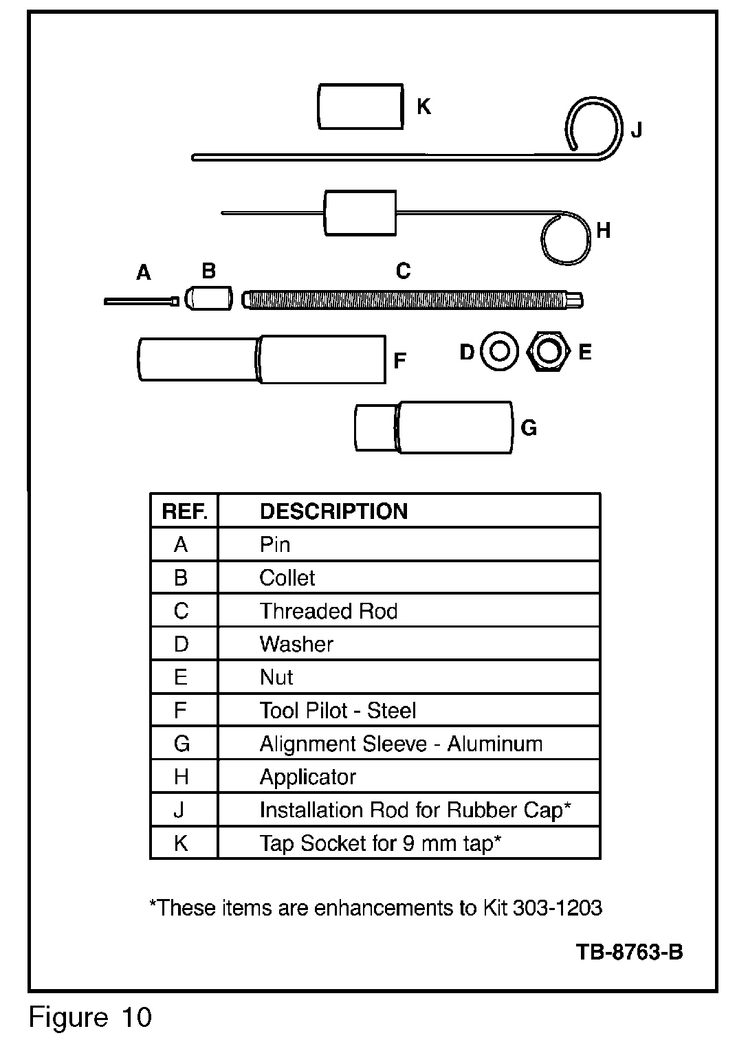

Use Rotunda special service tool kit 303-1398 to remove porcelain broken inside the ground electrode shield. (FIGURE 10)

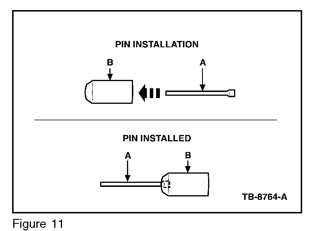

2. Spray Motorcraft Metal Brake Parts Cleaner into the porcelain hole for 2-4 seconds using the straw nozzle supplied with the brake cleaner can.
pic 11
pic 12

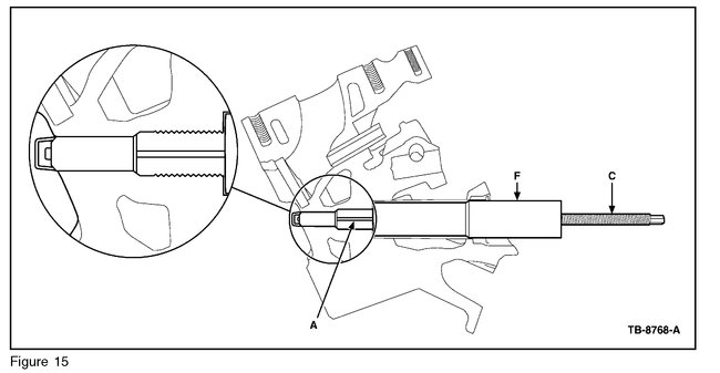

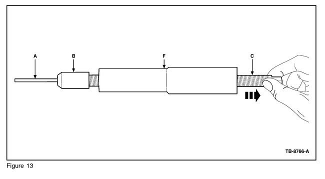

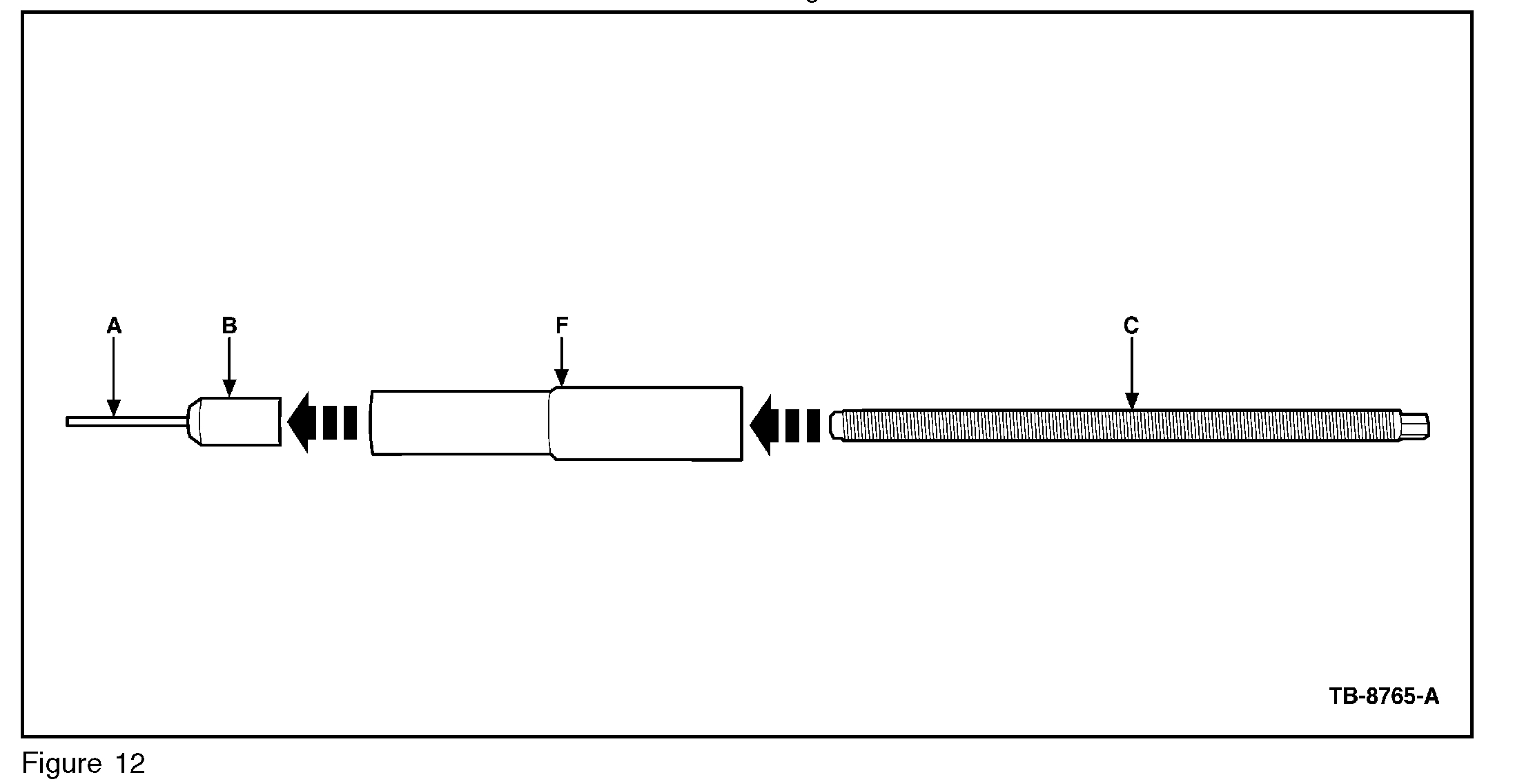

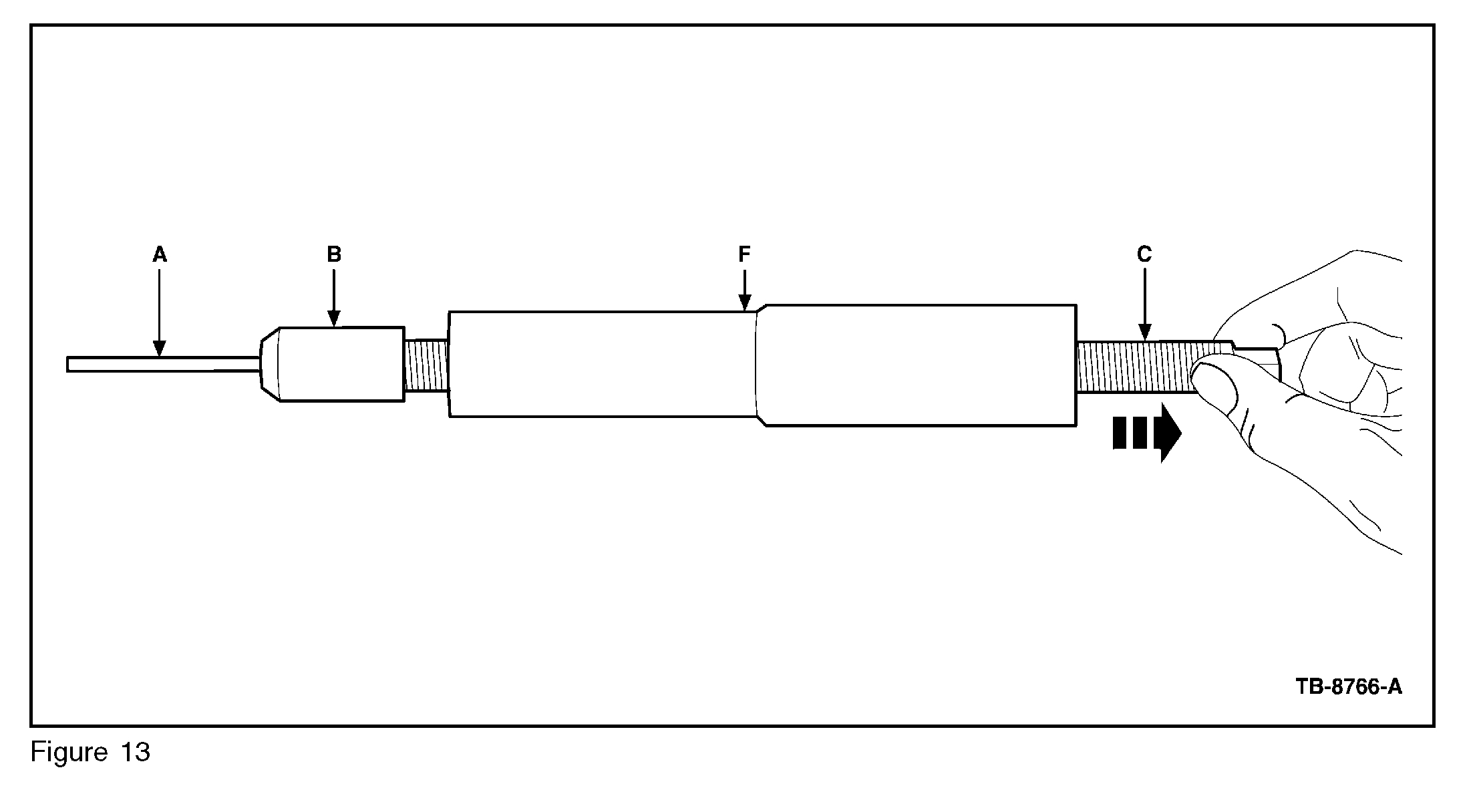

3. Insert a pin (A) into the collet (B). Screw the collet onto the threaded rod (C). Install the assembled collet, pin, and threaded rod into the steel tool pilot (F). (Figures 11 and 12)
pic 13
pic 14
4. Retract the collet and pin into the steel tool pilot, protecting the pin. (Figures 13 and 14)
NOTE
PIN TIP DAMAGE OR BENT PINS WILL PREVENT INSERTION INTO THE PORCELAIN.

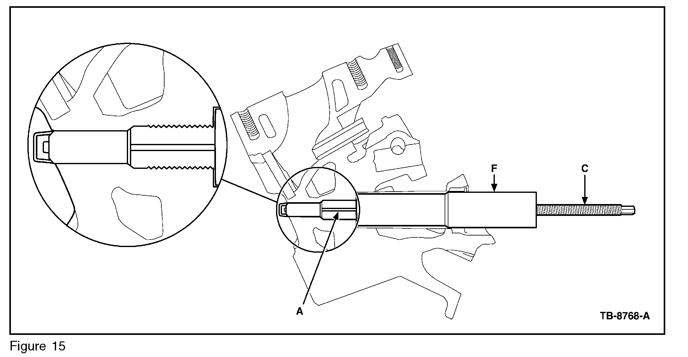

pic 15
5. Insert the completed assembly into the spark plug well and fully engage the pin into the porcelain. (Figure 15)

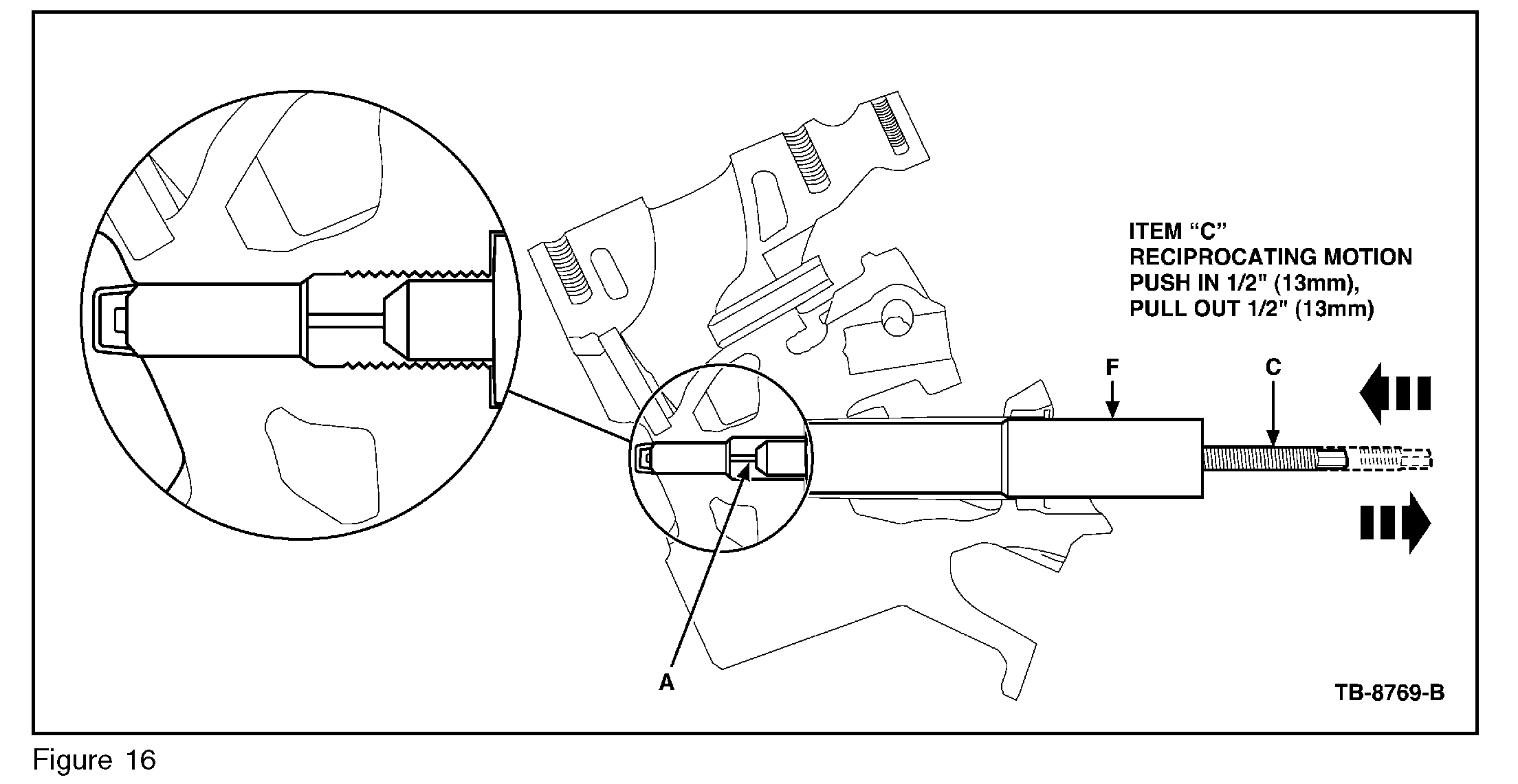

6. Spray Motorcraft(R) Metal Brake Parts Cleaner 2-4 seconds between the spark plug well and steel tool pilot. The steel tool pilot must be lifted up approximately 1/2" to allow brake cleaner to flood the porcelain and pin.
pic 16

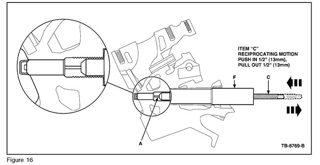

7. Scrub the porcelain inside diameter by moving the threaded rod up and down vigorously. Take care making sure the pin does not disengage the porcelain. (Figure 16).
8. Repeat Steps 6 and 7.

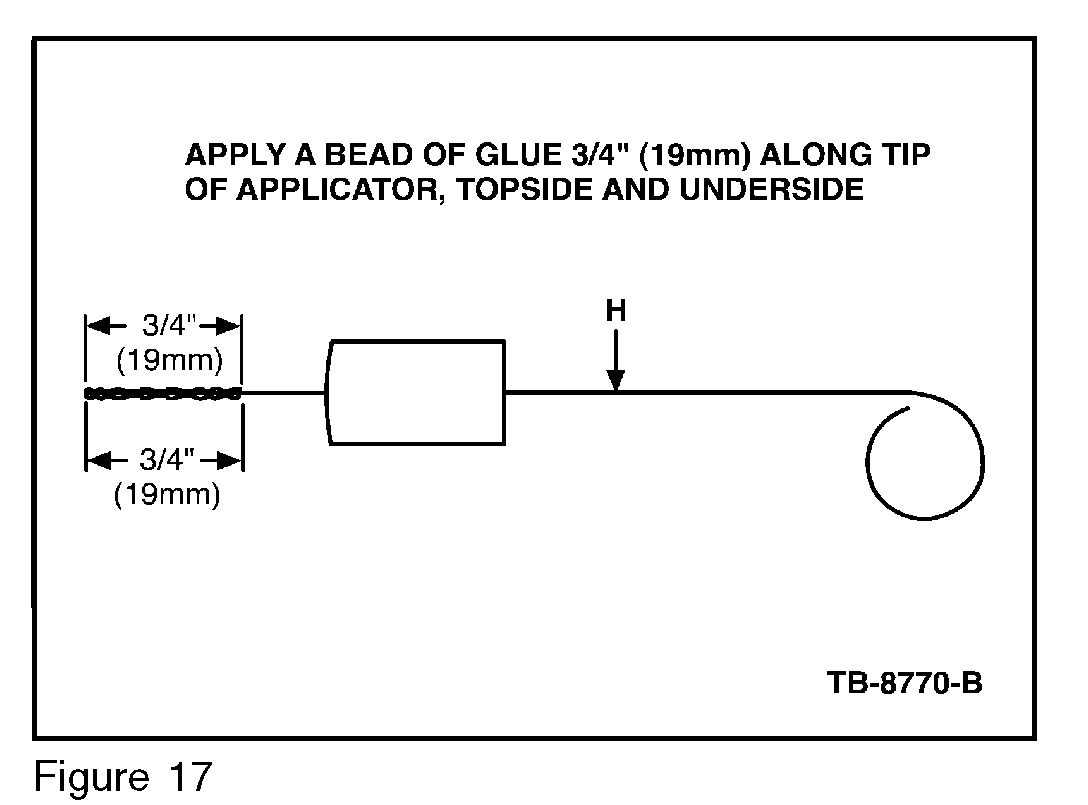

pic 17
1. Apply two 3/4" (19 mm) long stripes of Loctite(R) 638(TM) to opposite sides of a clean and dry applicator (H). Excessive amounts of Loctite(R) 638(TM) are being used if it drips off the applicator. (Figure 17)
2. Insert applicator into the porcelain and move applicator up and down 1/2" (13 mm) while turning to spread the Loctite 638TM on the inside of the porcelain. (Figure 18).
3. Add additional Loctite(R) 638(TM), repeating Steps 1 and 2.
4. Clean the applicator with Motorcraft(R) Metal Brake Parts Cleaner before the bonding agent starts to cure.
5. Reassemble a dry and clean collet and pin assembly.
6. Apply two 3/4" (19 mm) long stripes of Loctite(R) 638(TM) to the pin. Excessive amounts of Loctite 638TMare being used if it drips off the pin.
7. Retract the collet and pin into the steel tool pilot to protect the Loctite(R) 638(TM) coated pin.
8. Insert the completed assembly into spark plug well and fully engage the pin into the porcelain with a twisting motion to spread the bonding agent.
9. Add additional Loctite 638TM, repeating Steps 6-8.

Porcelain Removal - Extraction
1. After a minimum of one hour curing at 70 °F (21 °C), install the steel pilot tool over the threaded rod.
2. Install the washer and jack nut until finger tight against the tool pilot bushing.
CAUTION
ONLY THE STEEL PILOT TOOL IS ACCEPTABLE FOR USE IN PORCELAIN REMOVAL.
3. While holding the end of the threaded rod with a wrench, tighten the jack nut until the porcelain is free of the ground electrode.
4. Refer to Mode 1 Procedure to remove the remaining ground electrode shield from the cylinder head.
