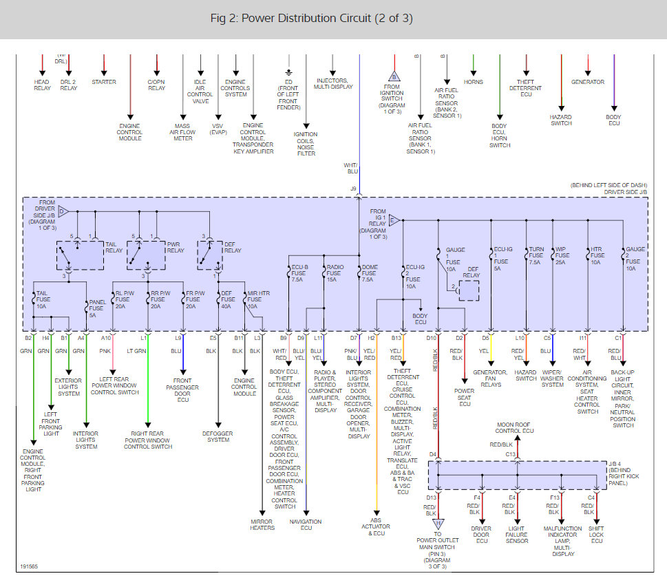

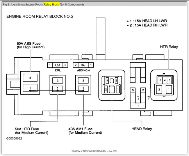

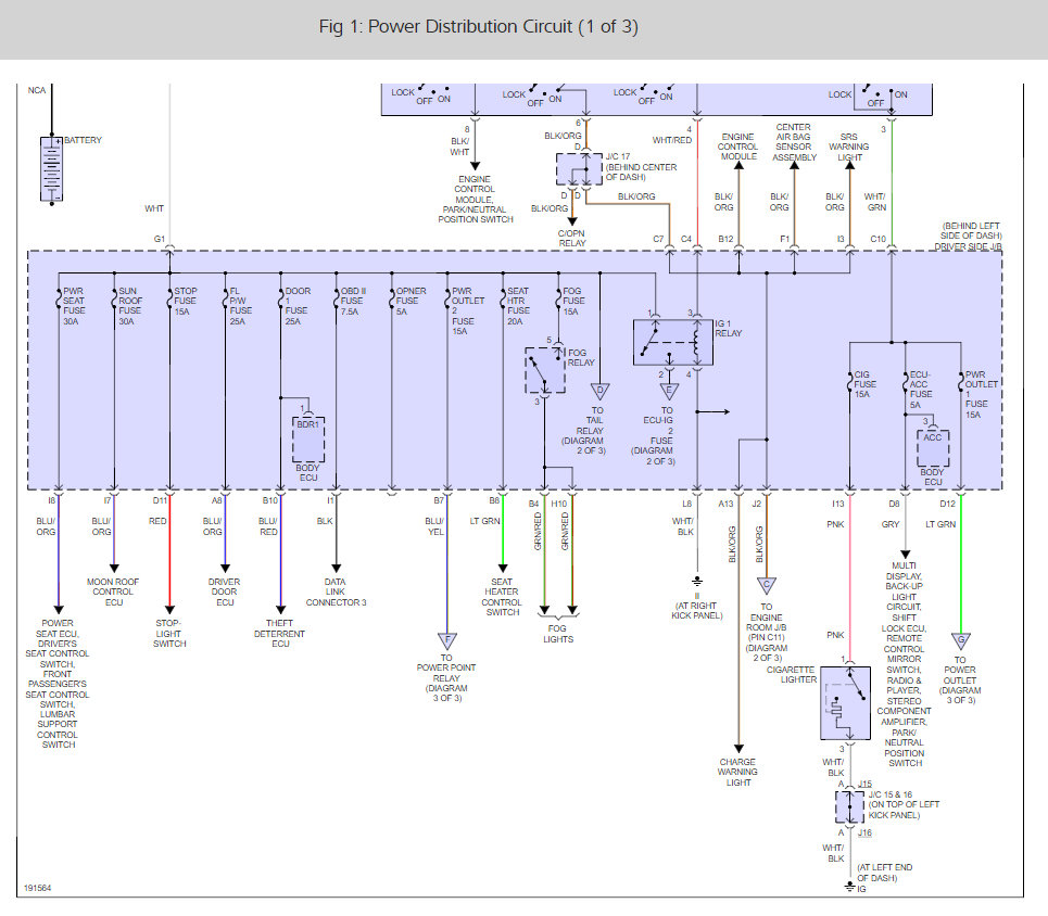

The 40 ACC fuse inside of the fuse box inside of the car it's good but when I remove the fuse and test it with a test light no power is coming to that fuse where is the one in the engine that goes to that one no power is going to the 40 ACC fuse inside of the car
Oct 30, 2017 at 9:27 AM
  • 55,711 POSTS

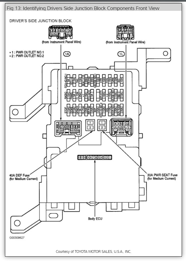

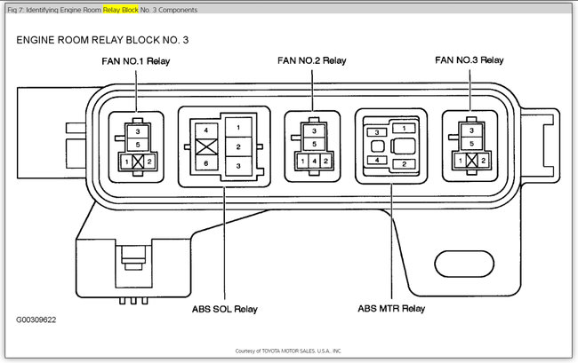

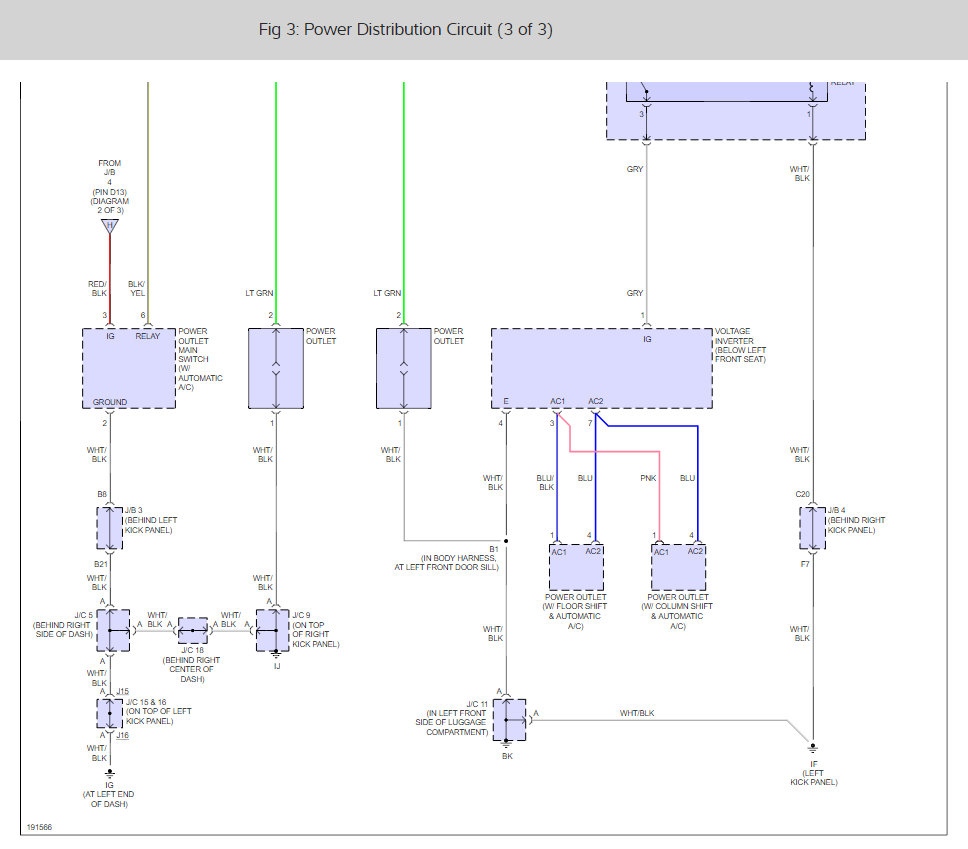

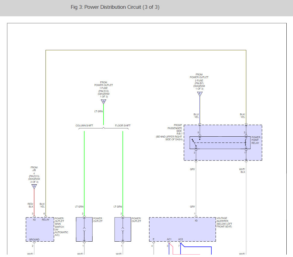

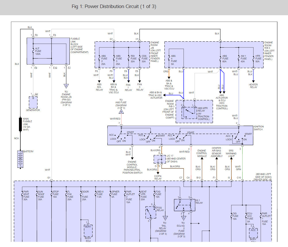

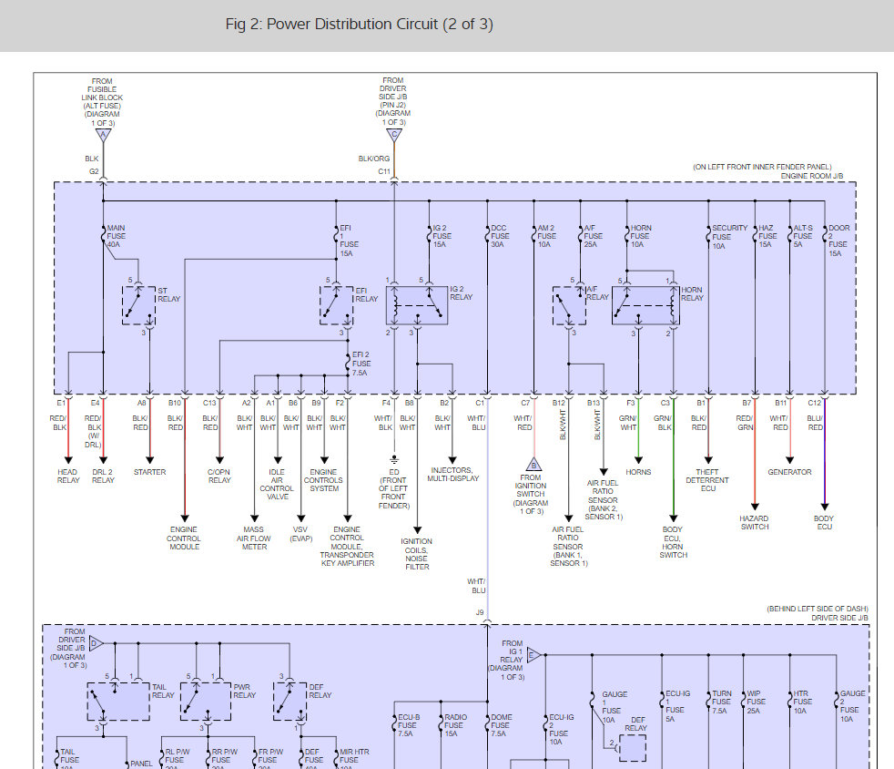

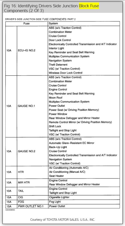

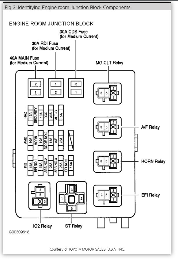

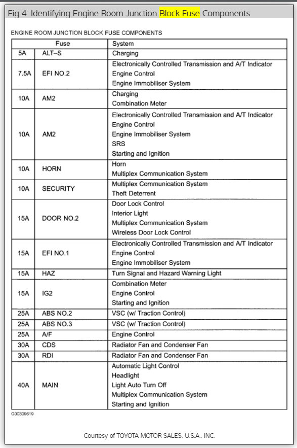

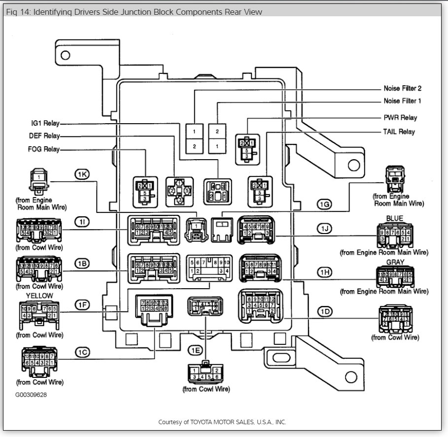

I cannot find a 40 amp ACC fuse. Here are some power distribution wiring diagrams can you see which fuse you are talking about?
Here are some fuse panel diagrams as well.
Please let us know what you find. I'm interested to see what it is.
