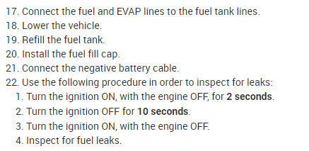

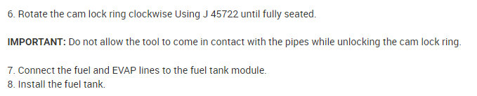

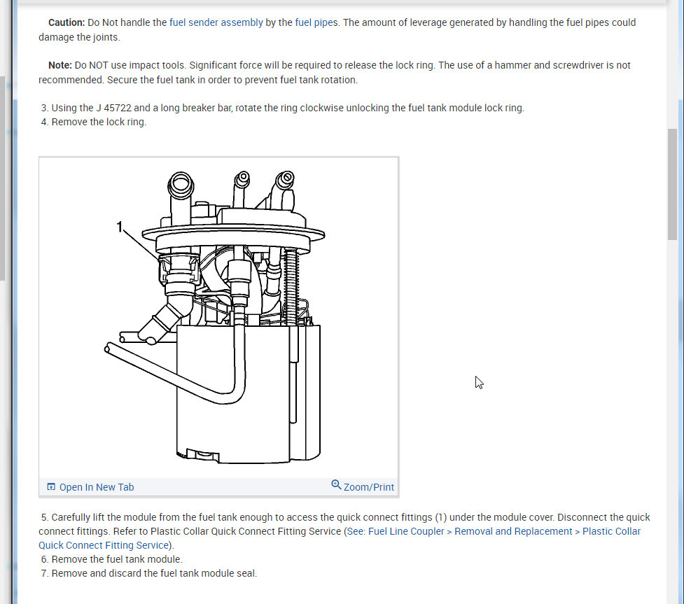

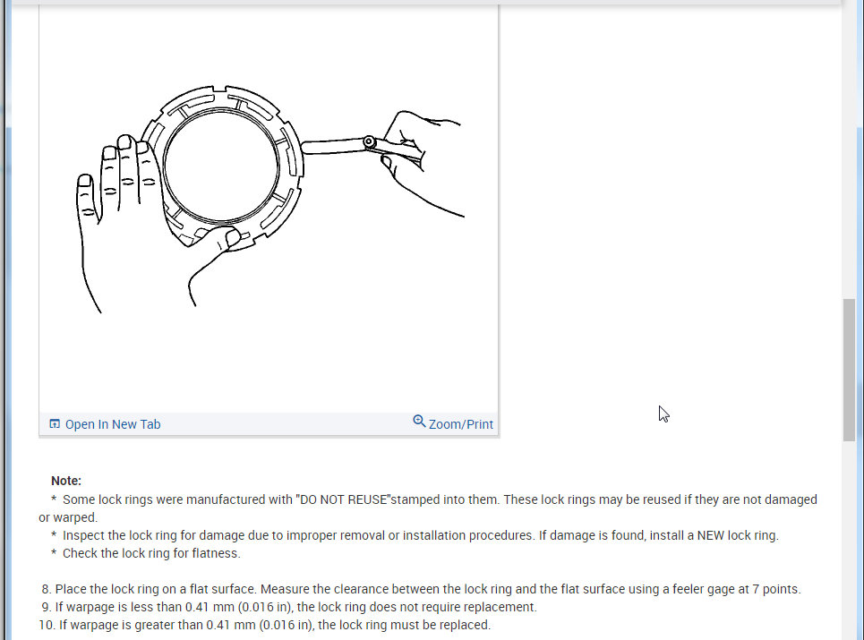

The fuel pressure is low I need to replace the fuel pump. I just don't know what else I can do myself.
Oct 31, 2019 at 3:50 AM

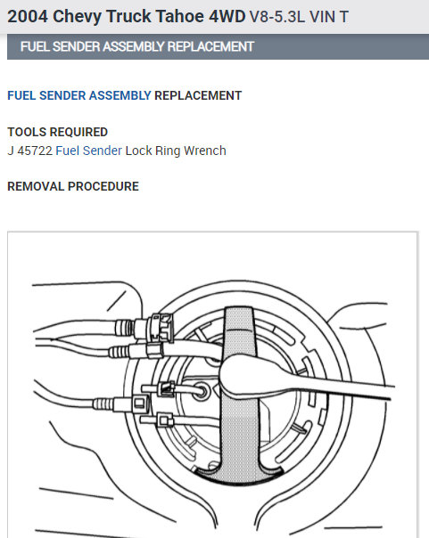

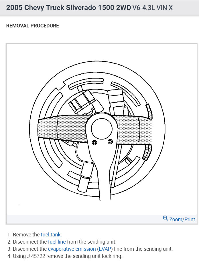

Here is a guide and a video that will help with this:
https://www.2carpros.com/articles/how-to-replace-an-electric-fuel-pump
https://www.youtube.com/watch?v=VuGxQgWDP-0

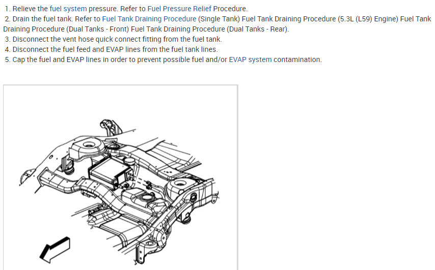

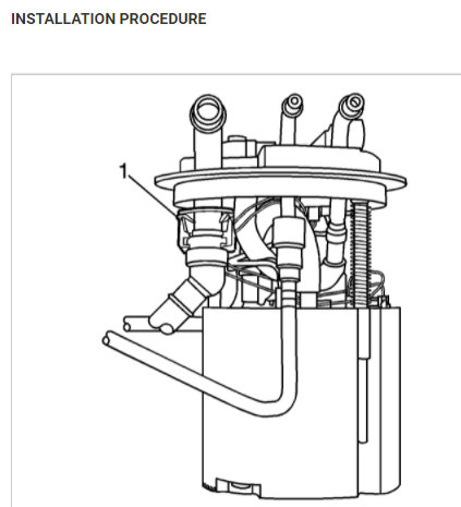

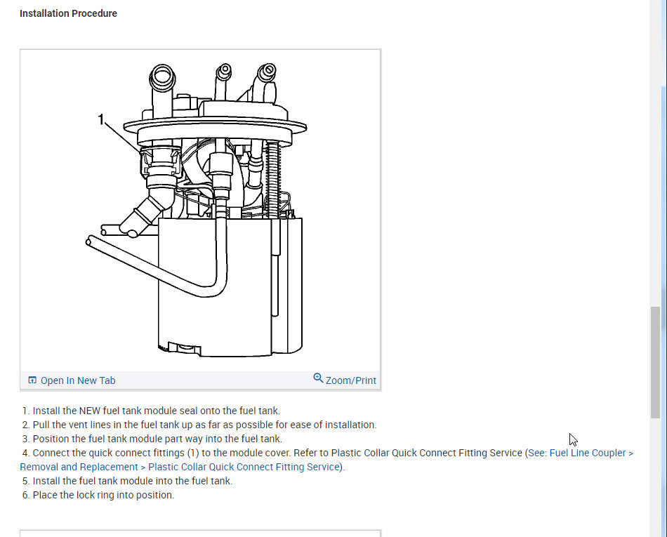

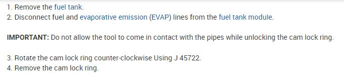

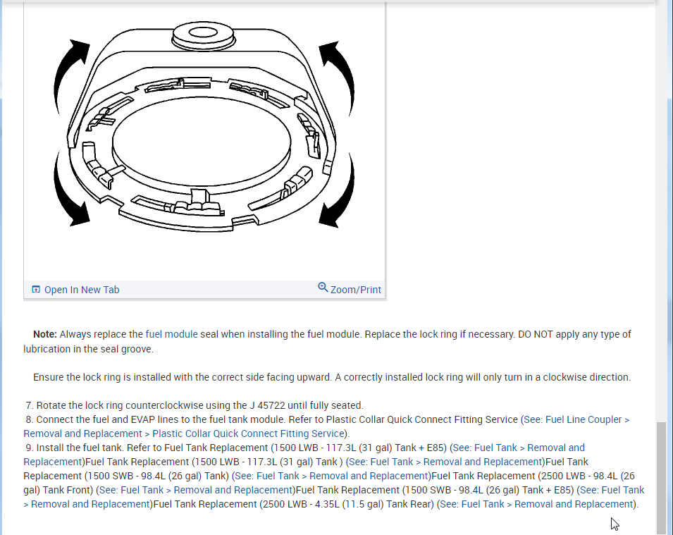

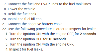

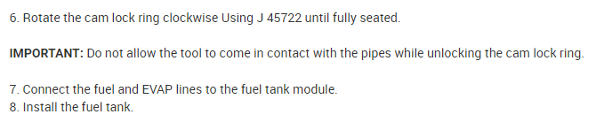

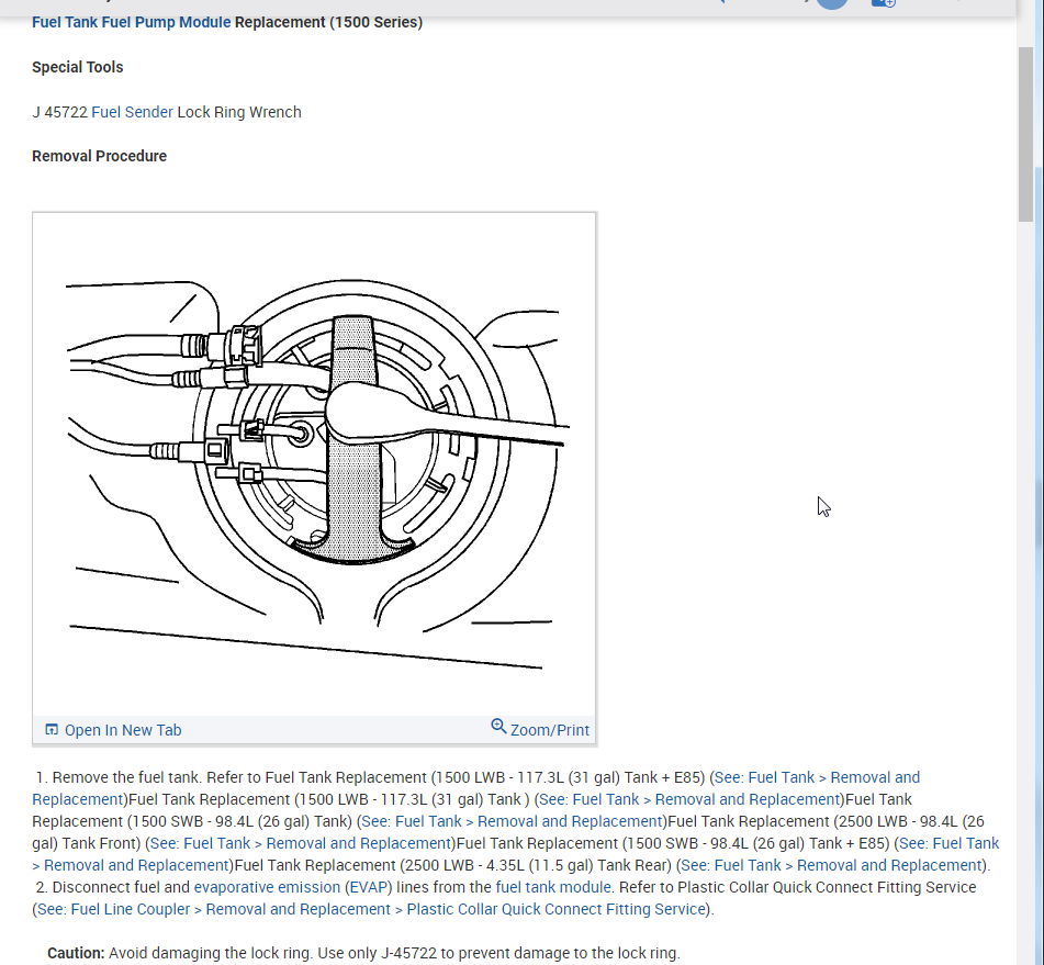

Below you will find the process from the manual that will give detail as well that will help with this. Please let us know if you have other questions. Thanks

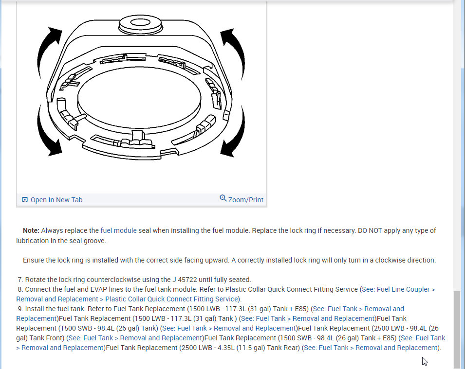

Here is a guide to help you step by step with instructions in the diagrams below to show you how on your car.

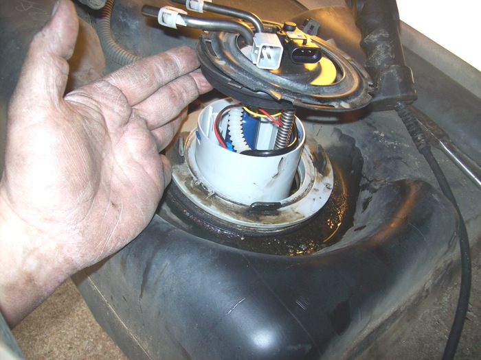

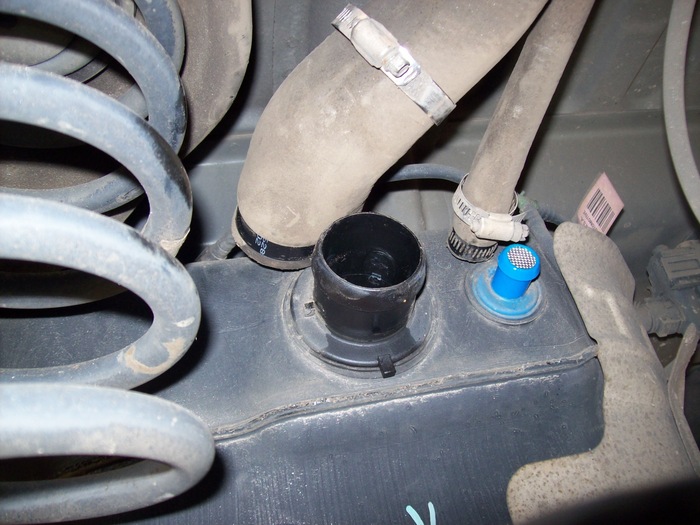

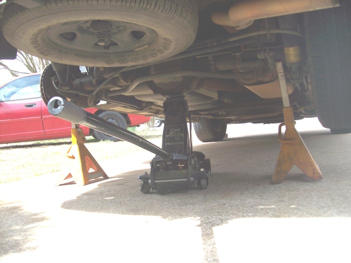

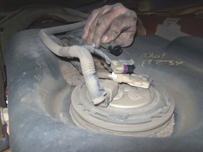

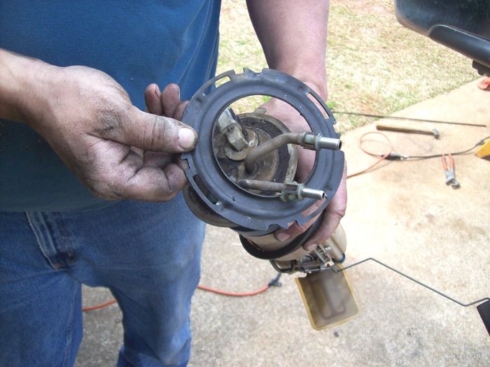

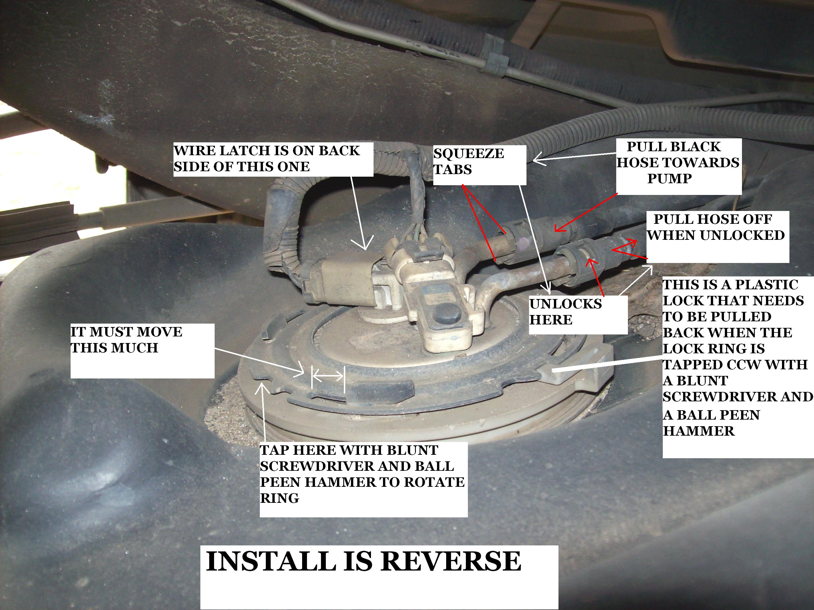

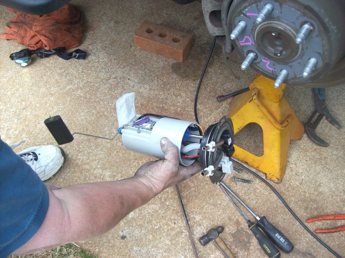

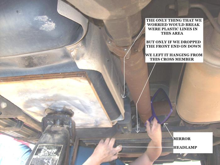

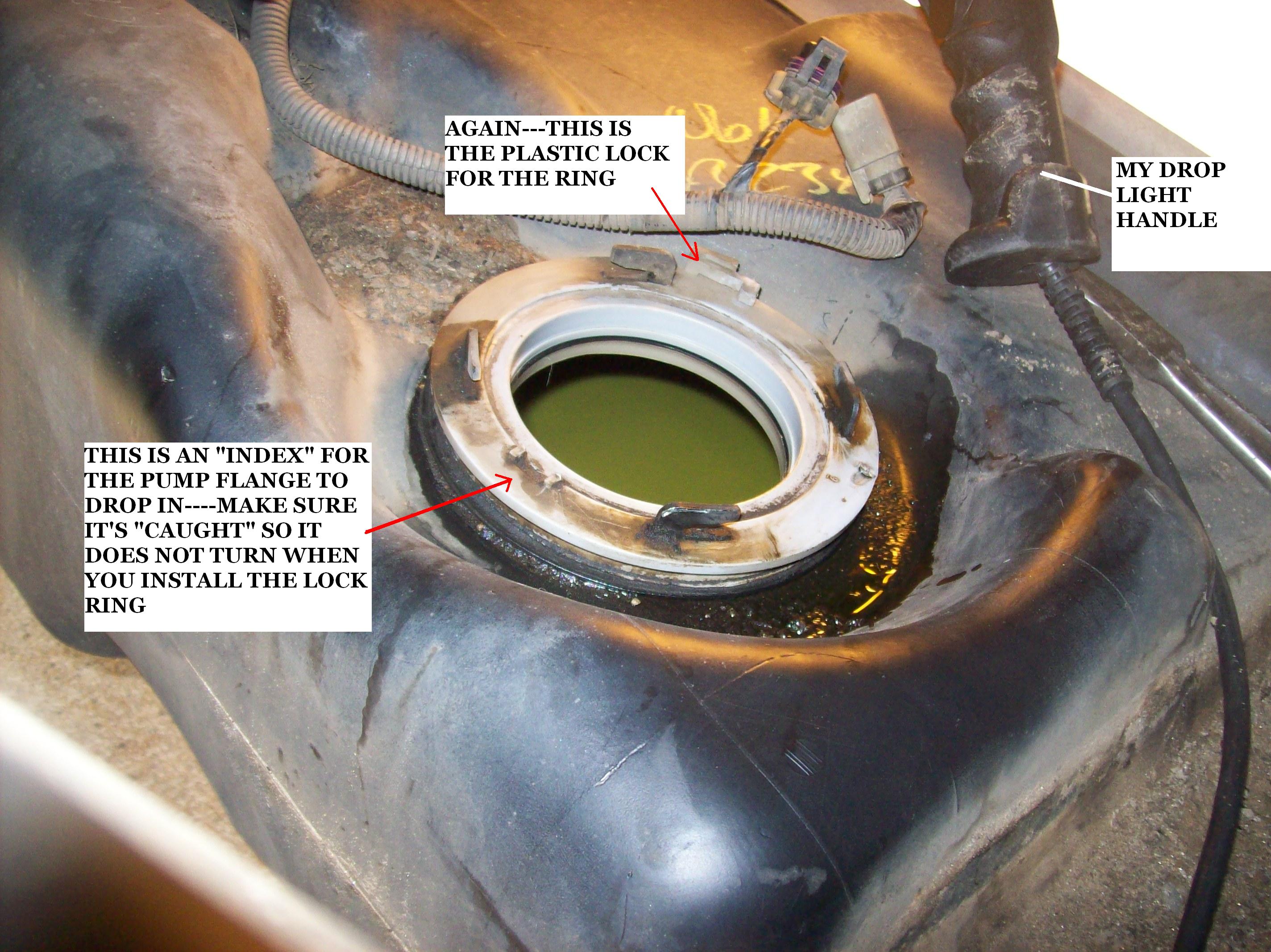

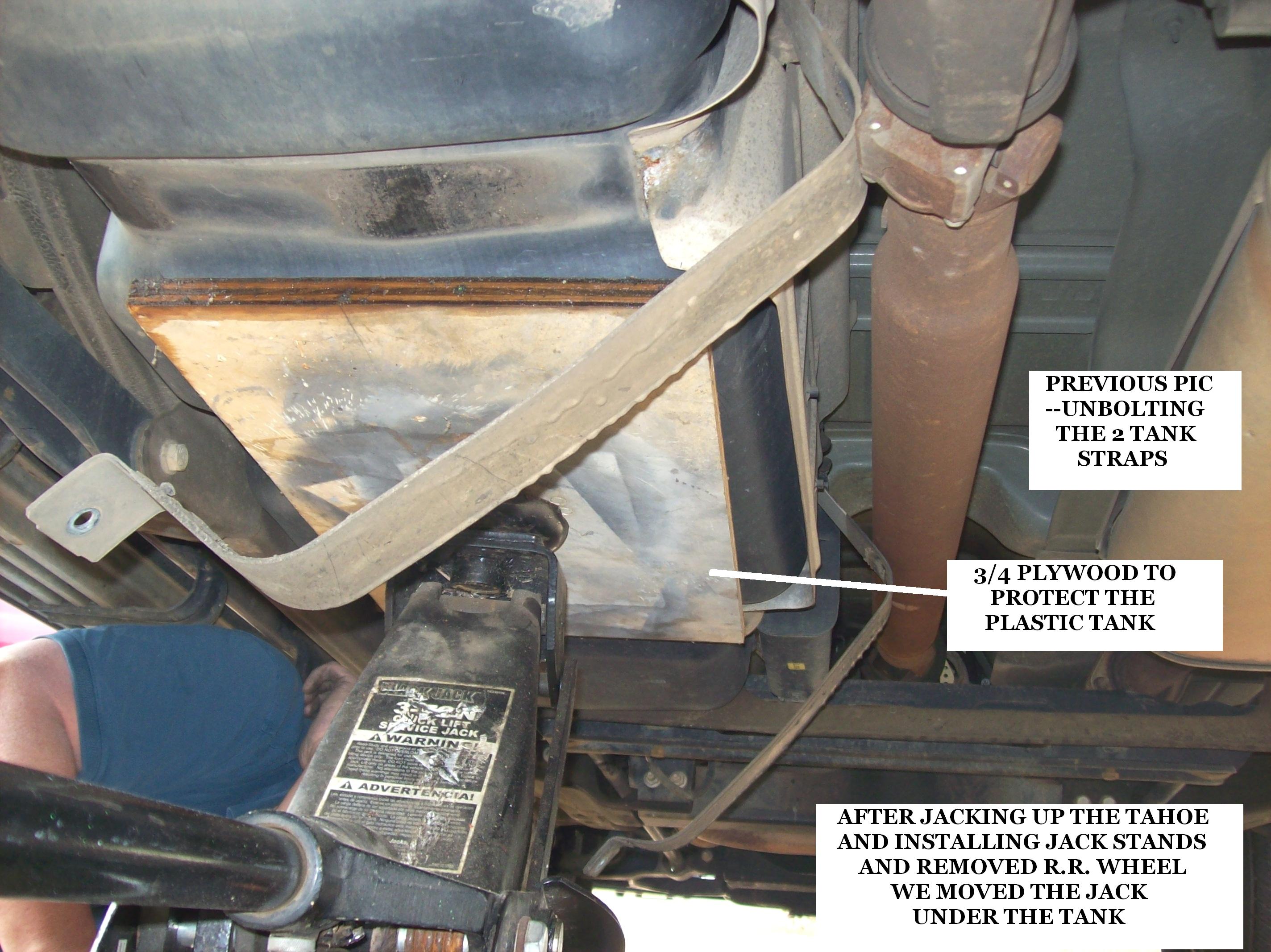

fuel pump w/ lifetime warranty $65 on ebay. bro-n-law and me never done this task before being safe in my driveway, rear end on jack stands!. about 3 hours did this about two weeks ago i made about 50 pics of the process----also slowing' me down----here's a few. Check out the diagrams (Below). Please let us know what you find.

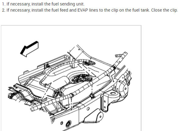

DANNY L
  • 5,648 POSTS
Hello, I'm Danny.

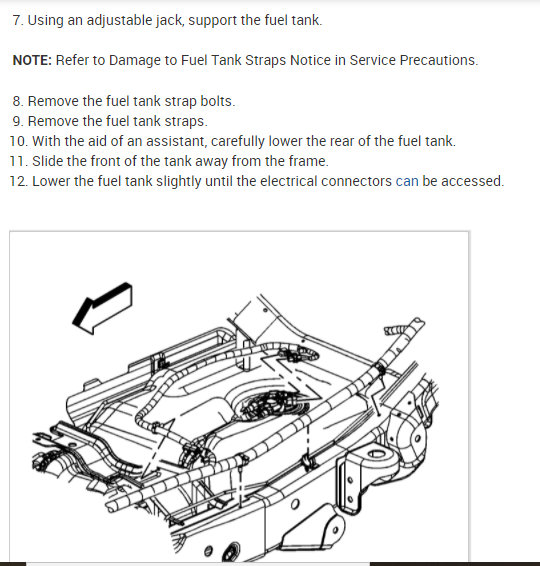

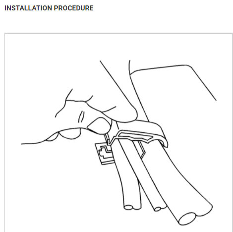

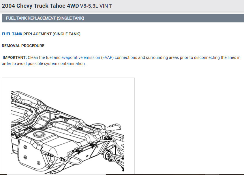

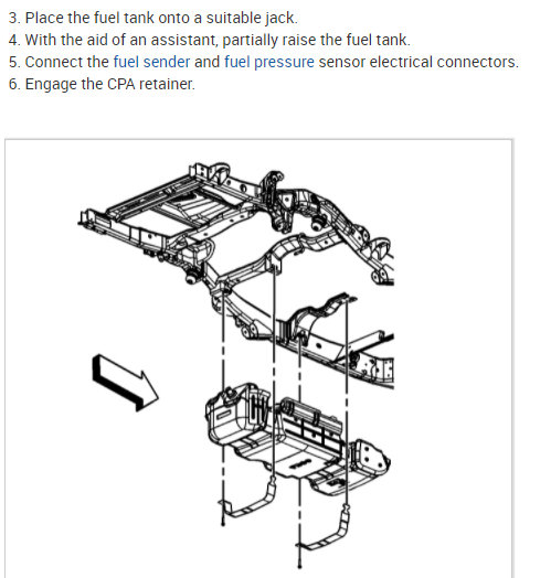

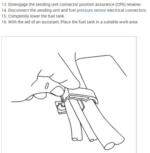

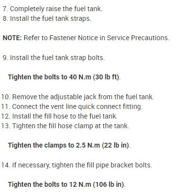

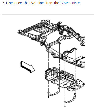

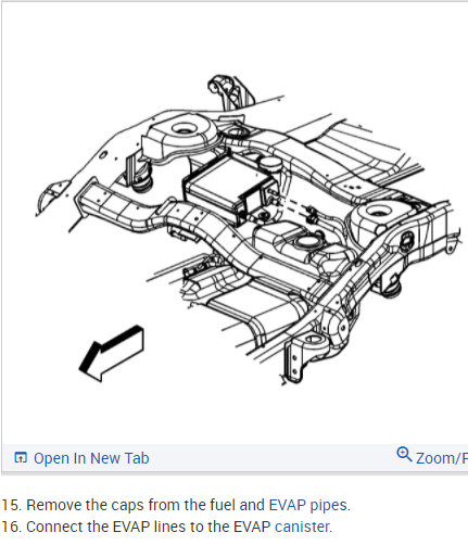

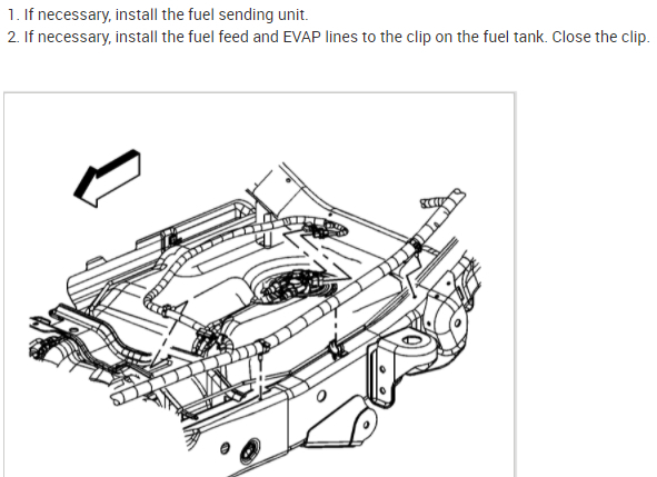

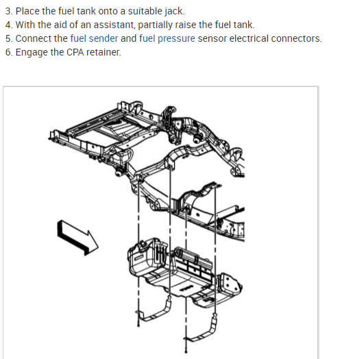

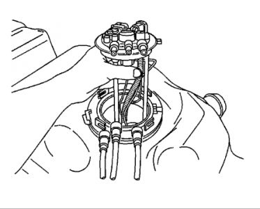

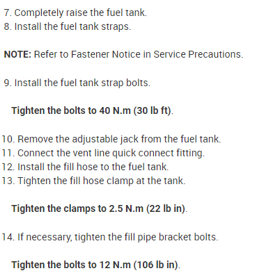

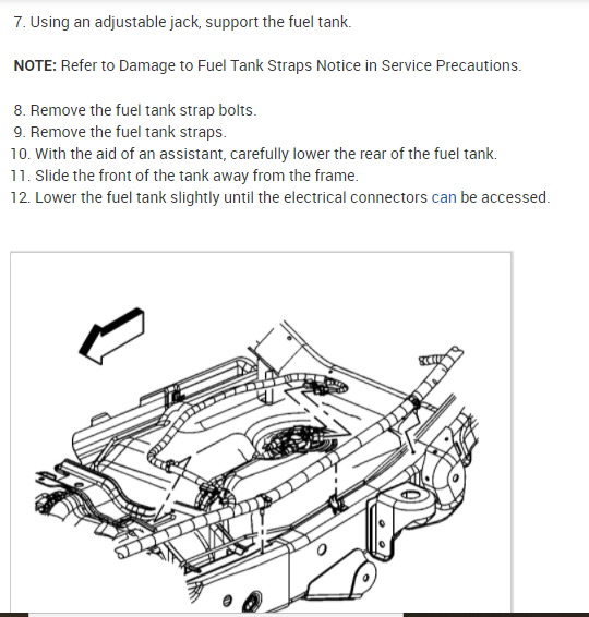

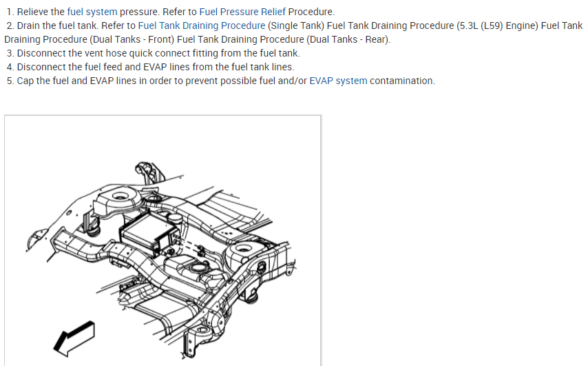

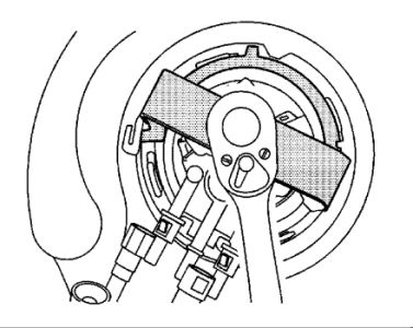

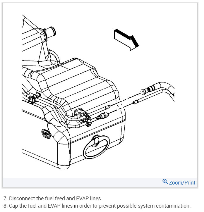

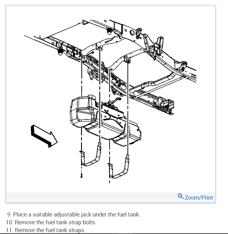

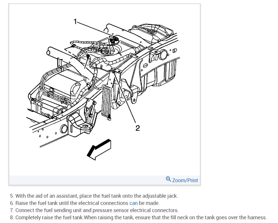

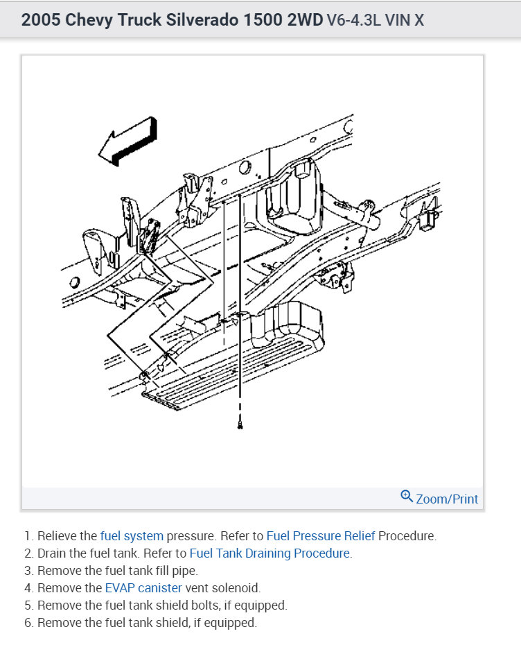

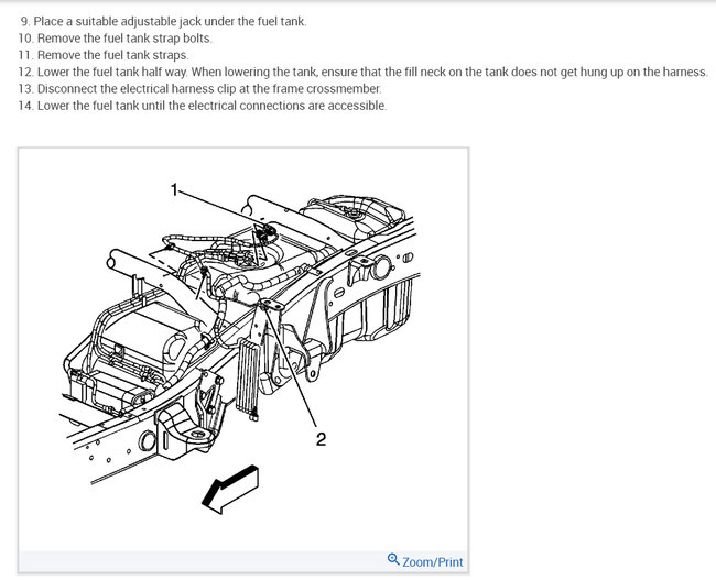

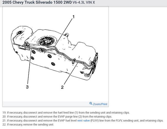

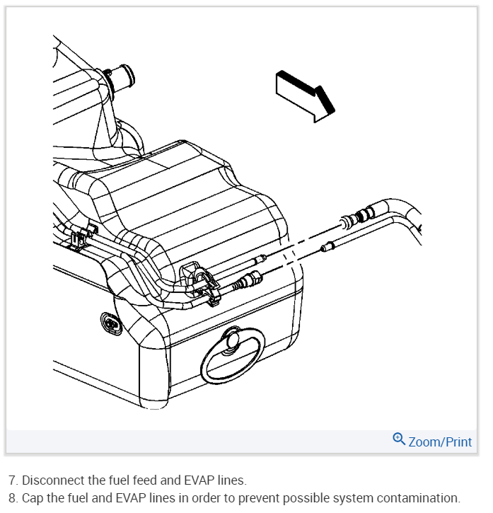

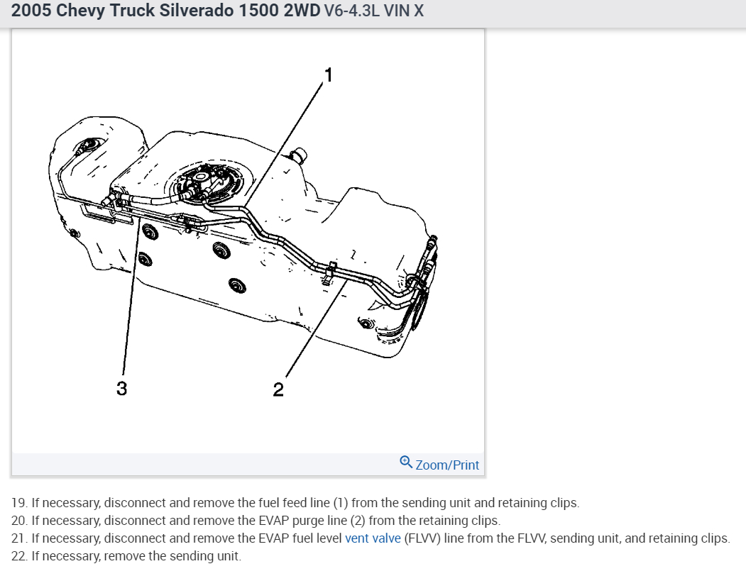

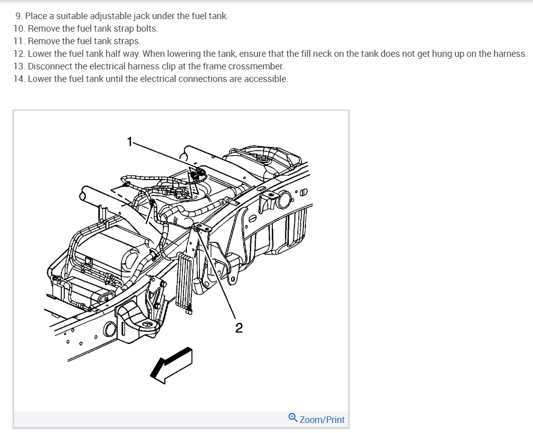

Here is the information you requested. You will have to drop the gas tank to gain access to the in-tank fuel pump. Here is a tutorial showing what is involved for replacement:
I've attached a pictures below of how to remove and replace the fuel tank and fuel pump. Hope this helps and thanks for using 2CarPros.
Jun 2, 2021 at 7:29 AM (Merged)

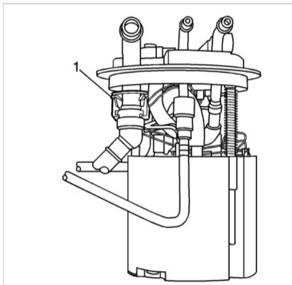

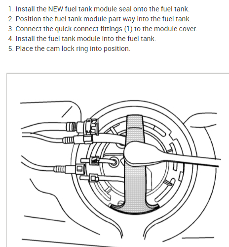

Here is a guide that will help with this:
Plus below you will find the process from the manual on how to replace this pump. Please let us know if you have other questions. Thanks

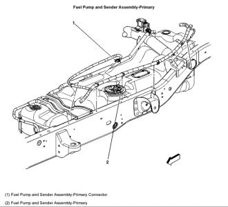

ALBATE
I would like to know how to replace my fuel pump on my 2003 chevy tahoe flex vinZ where it is located and how do i replace it. any help with this would be greatly appreciated.
Thank You
  • 75,992 POSTS

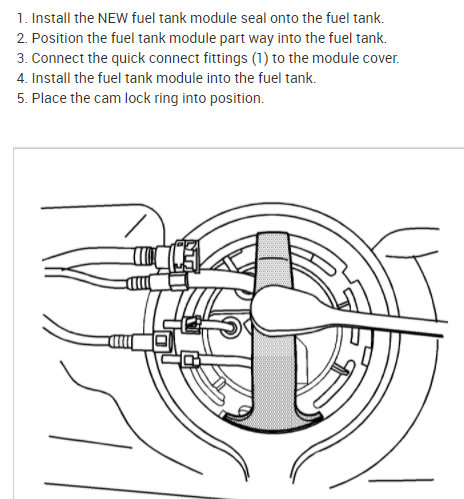

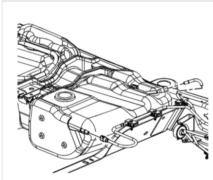

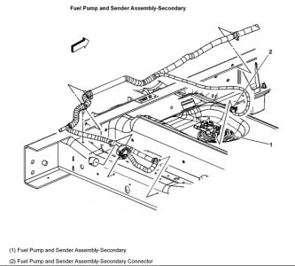

Hi,Welcome to 2carpros and TY for the donation. Component Locations
https://images.2carpros.com/forum/automotive_pictures/12900_fpl1_1.jpg
https://images.2carpros.com/forum/automotive_pictures/12900_fpl2_1.jpg

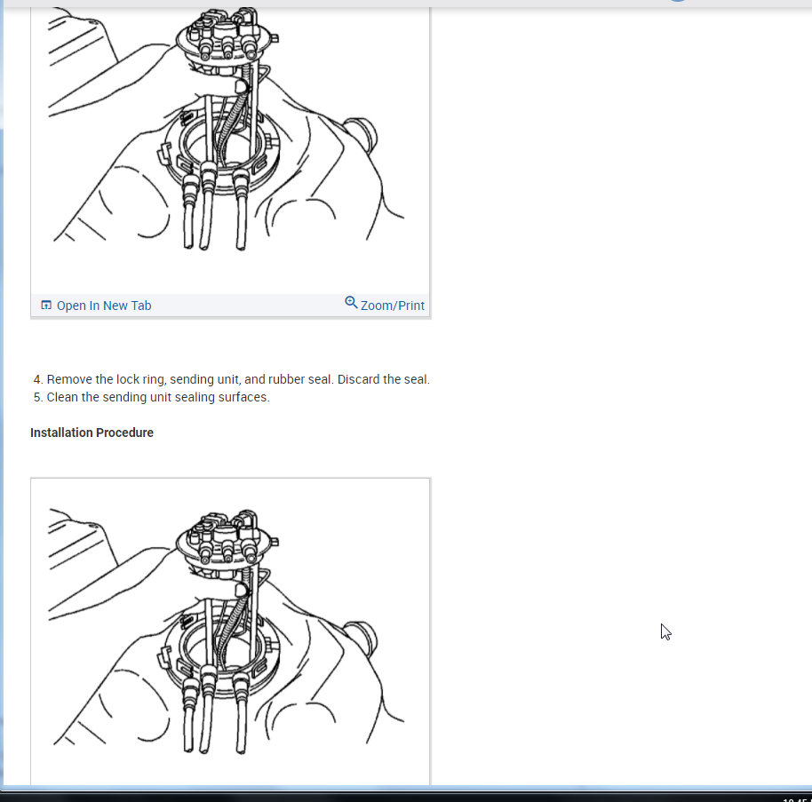

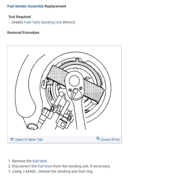

Fuel Sender Assembly Replacement Tool Required J44402 Fuel Tank Sending Unit Wrench. Removal Procedure
https://images.2carpros.com/forum/automotive_pictures/12900_fp1_31.jpg
1.Remove the fuel tank. 2.Disconnect the fuel lines from the sending unit, if necessary. 3.Using J 44402 , remove the sending unit lock ring.
https://images.2carpros.com/forum/automotive_pictures/12900_fp2_13.jpg

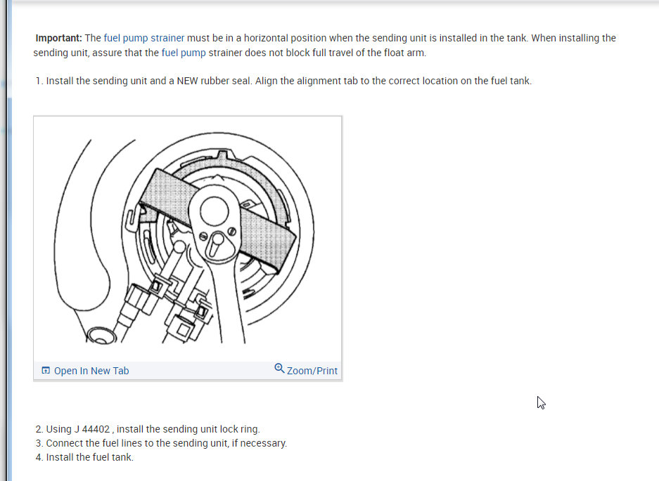

4.Remove the lock ring, sending unit, and rubber seal. Discard the seal. 5.Clean the sending unit sealing surfaces. Installation Procedure
https://images.2carpros.com/forum/automotive_pictures/12900_fp2_14.jpg
Important: The fuel pump strainer must be in a horizontal position when the sending unit is installed in the tank. When installing the sending unit, assure that the fuel pump strainer does not block full travel of the float arm. 1.Install the sending unit and a NEW rubber seal. Align the alignment tab to the correct location on the fuel tank.
2.Using J 44402 , install the sending unit lock ring. 3.Connect the fuel lines to the sending unit, if necessary. 4.Install the fuel tank. https://www.2carpros.com/kpages/auto_repair_manuals_alldata.htm

The fuel pump is in the tank and is part of a module ase the includes the sending unit. Aft er the tank is dropped far enough dis connect the electrical lines and the fuel lines, finsh dropping it and replace the unit. then reinstall the same way it came out. Replace the filter at the same time and use a delco or delphi pump unless you want to do it again.

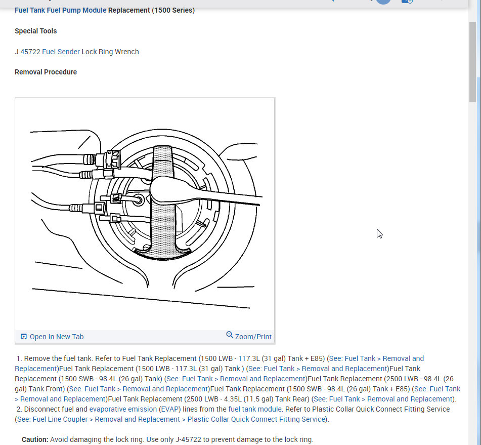

Here are a guide and a video that will help with replacing this:
Below you will find the process from the manual that will give the rest of the detail that you need to get this replaced.
