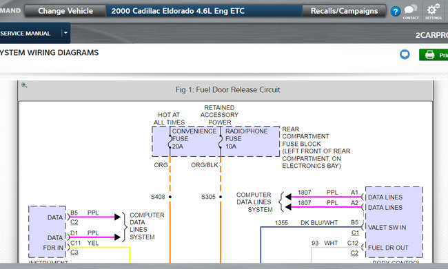

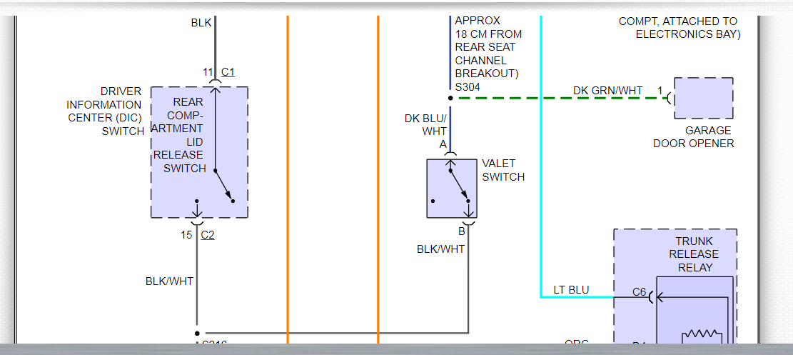

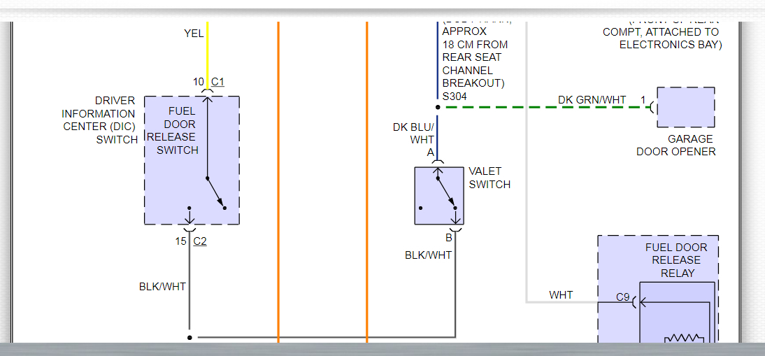

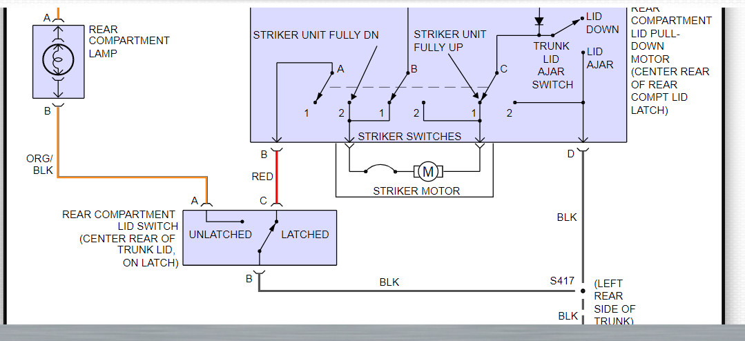

I can't access my trunk or fuel door with my key fob or from dash board buttons. I checked fuses in trunk and valet button, no bad fuse in trunk Valet not on.
May 13, 2019 at 8:26 AM
SCGRANTURISMO
  • 4,897 POSTS

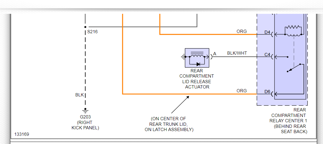

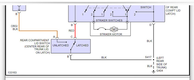

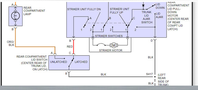

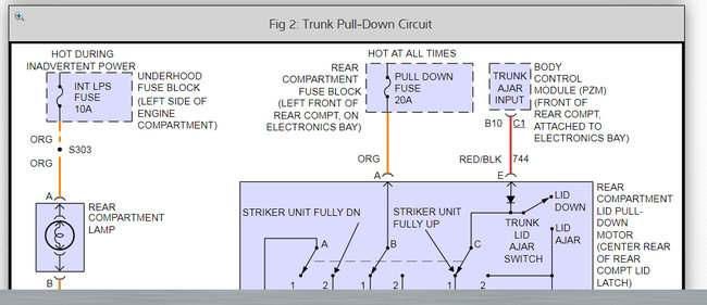

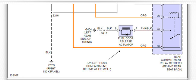

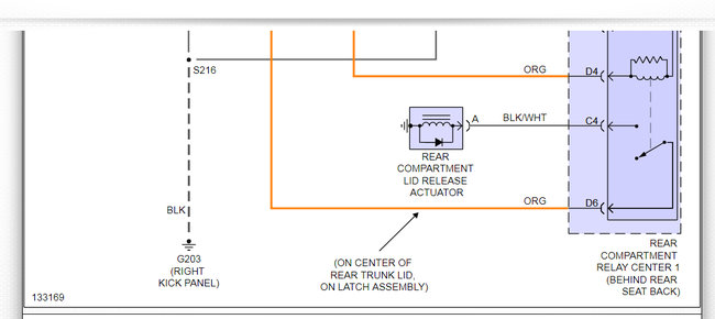

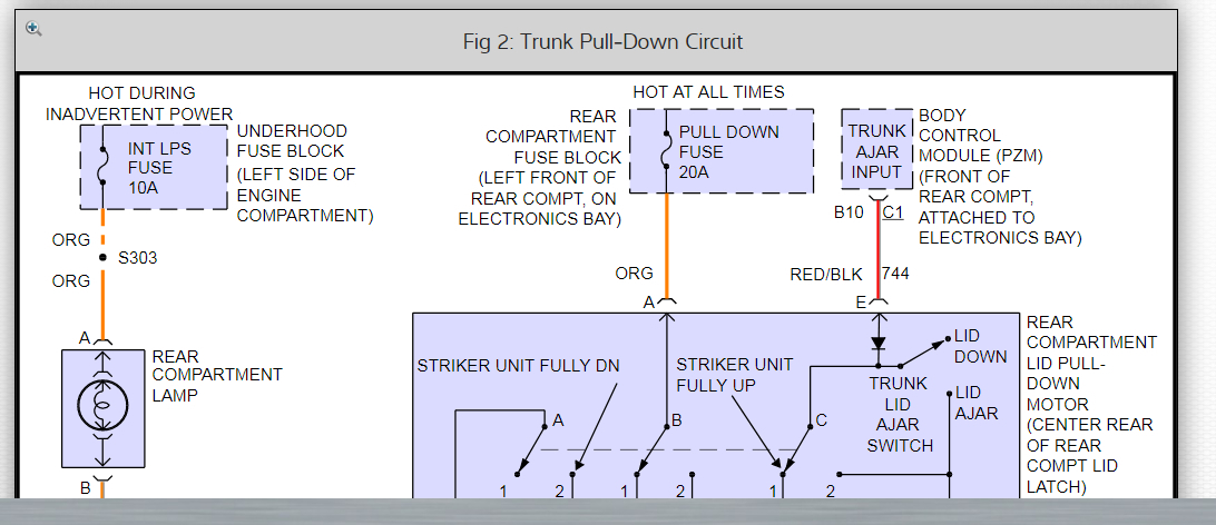

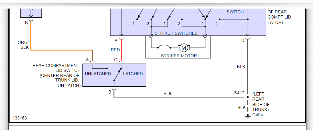

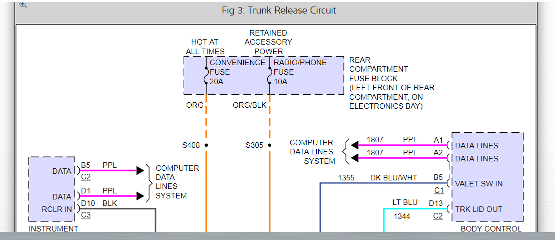

This could be a problem with ground #404, which is located in the left rear of the trunk. Please check this ground and make sure there is no corrosion, clean, tight, and making a good metal to metal connection. This ground is responsible for completing both the trunk and fuel door circuits, as you can see in both of the system wiring diagrams that I have included in the diagrams down below. Please go through these wiring diagrams, check the ground and get back to us with what you find out.
