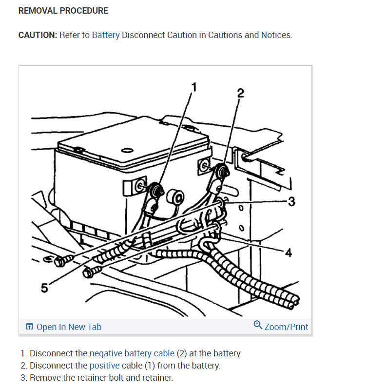

Went to start my car turn key lights on all lights inside car on turn to start and nothing. Figured it was a loose terminal so I wiggled it and something started making a noise so I stopped. now when I go to hook up battery terminal it sparks can’t even hook it up.
May 30, 2021 at 11:18 PM
Good morning,

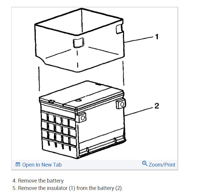

This sounds like either the battery terminal is bad, that is corrosion on the terminal, or the battery itself is the issue.
https://www.2carpros.com/articles/how-to-replace-a-car-battery
I would clean the battery terminal ends and if that does not work, replace the battery.
