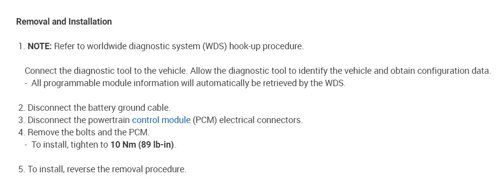

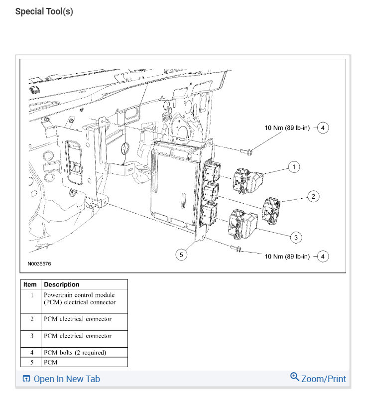

i have changed everything that I could change on the evap system and the P0443 code won't stay off and i am getting codes for the EGR and all my oxygen sensors now as well. I have changed the purge solenoid and the cannister valve and the EGR valve. I have tried to clear it out, but it keeps coming back on.

Yep, this happens when the PCM goes out, here is a generic guide to help you step by step with instructions in the diagrams below to show you how on your car:
https://www.2carpros.com/articles/how-to-replace-a-vehicles-main-engine-computer-pcm-ecm-ecu
Check out the images (below). Please let us know if you need anything else to get the problem fixed. I don't think this PCM needs to be programmed.
