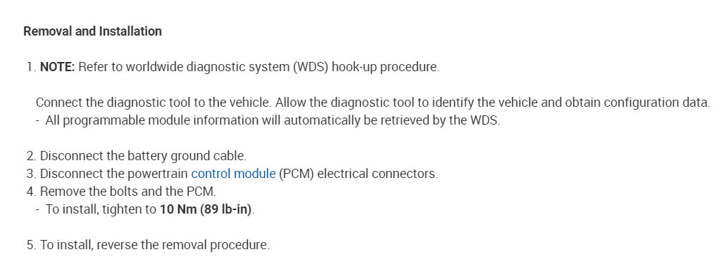

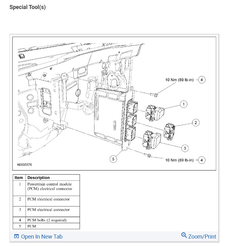

Yep, this happens when the PCM goes out, here is a generic guide to help you step by step with instructions in the diagrams below to show you how on your car:
https://www.2carpros.com/articles/how-to-replace-a-vehicles-main-engine-computer-pcm-ecm-ecu
Check out the images (below). Please let us know if you need anything else to get the problem fixed. I don't think this PCM needs to be programmed.
