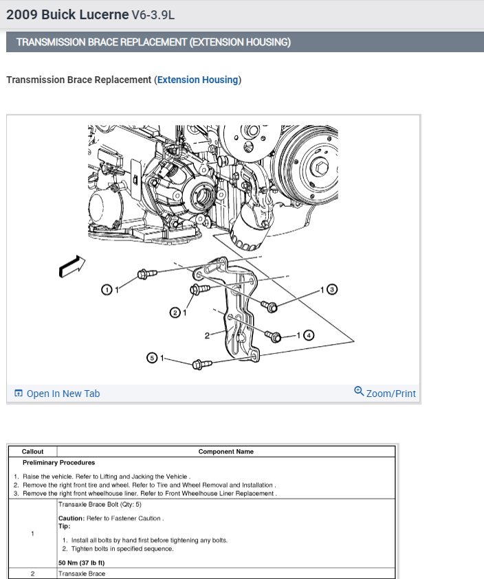

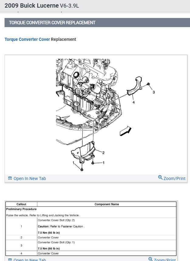

Starter removal, how to remove the two small bolts on the starter?
2009 BUICK LUCERNE
175,000 MILES • 3.9L • V6 • 2WD • AUTOMATIC
MARK LEE

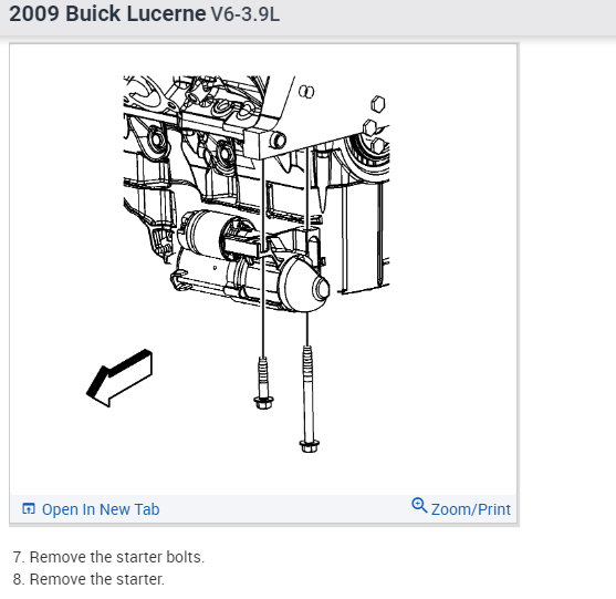

Located starter removed two bolts are too small to remove. Also took nut off Front Motor mount near starter jacked up engine, still can't remove.
Aug 17, 2022 at 10:17 PM
SQM
  • 6,383 POSTS

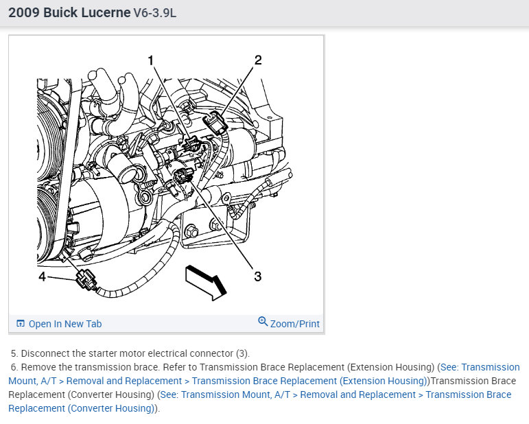

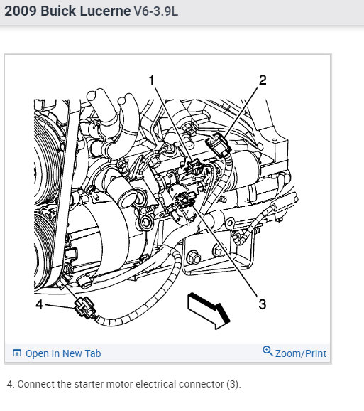

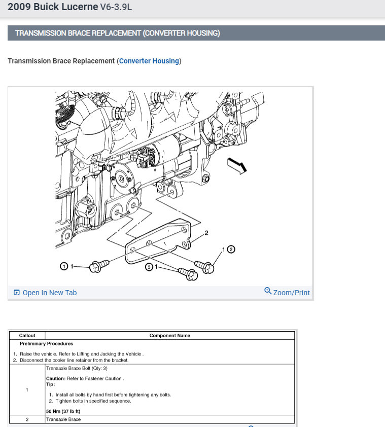

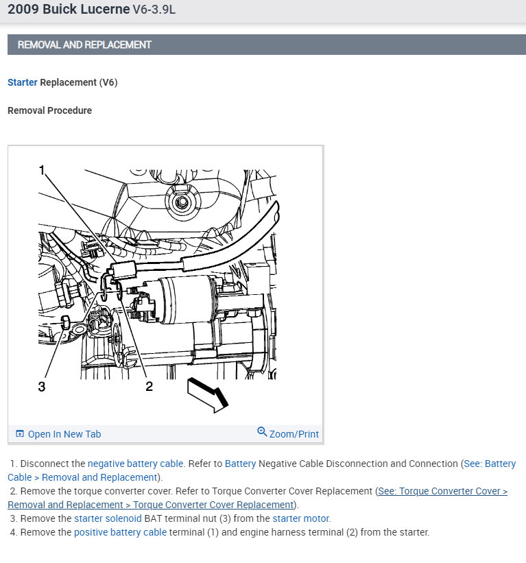

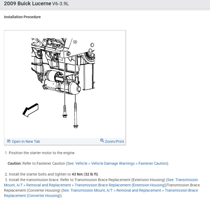

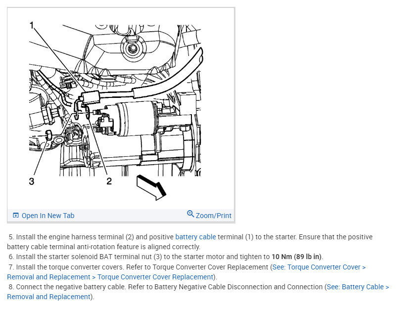

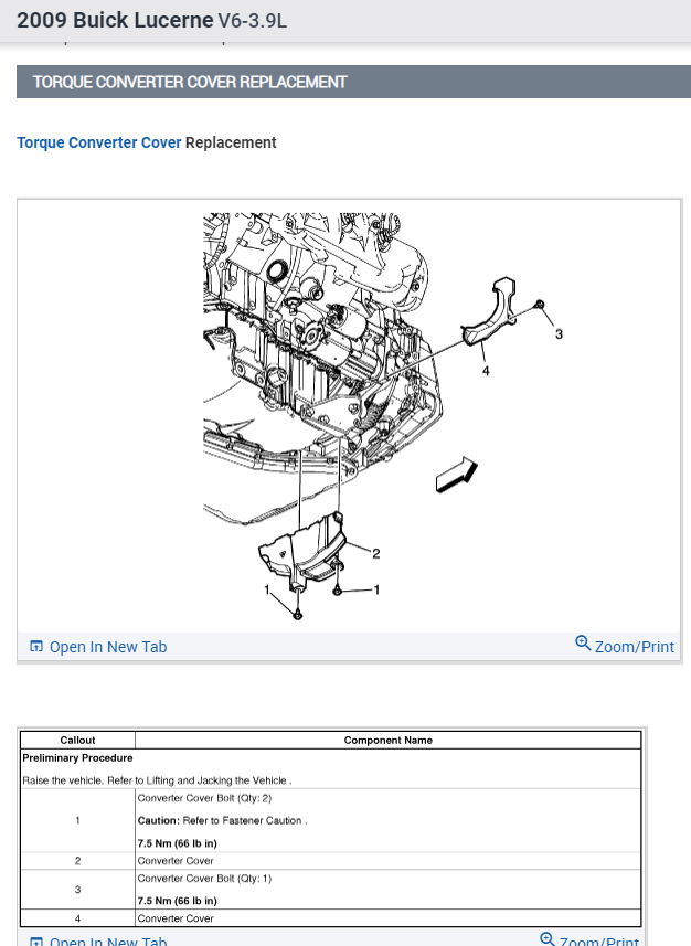

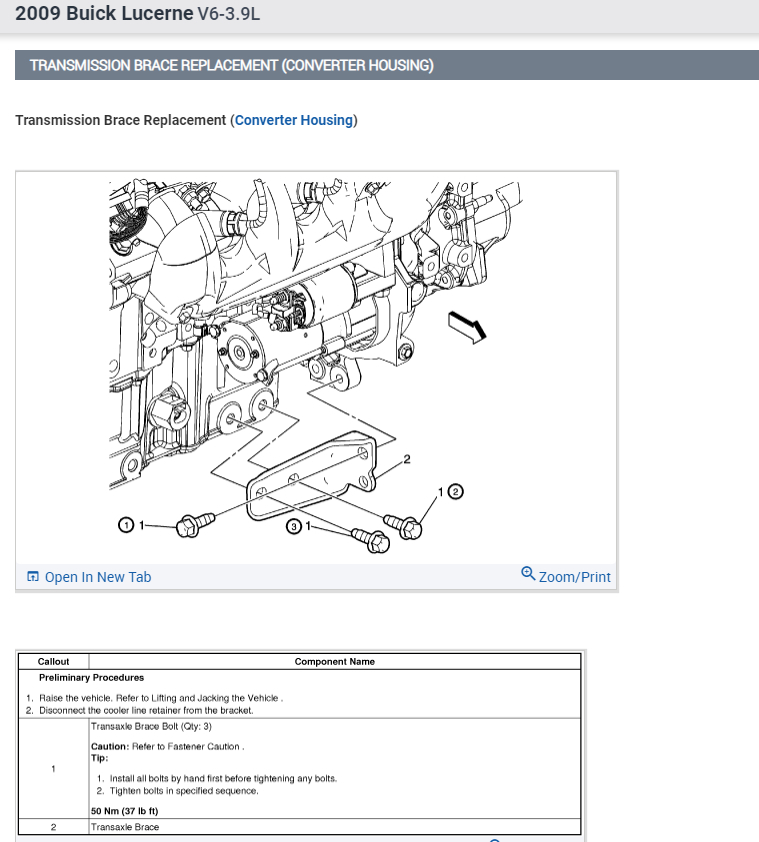

In order to replace the starter, you will have to remove the torque converter cover as well as the transmission brace.
This will allow enough room to remove the starter:
I have attached the replacement procedure below.
Let me know of any questions.
