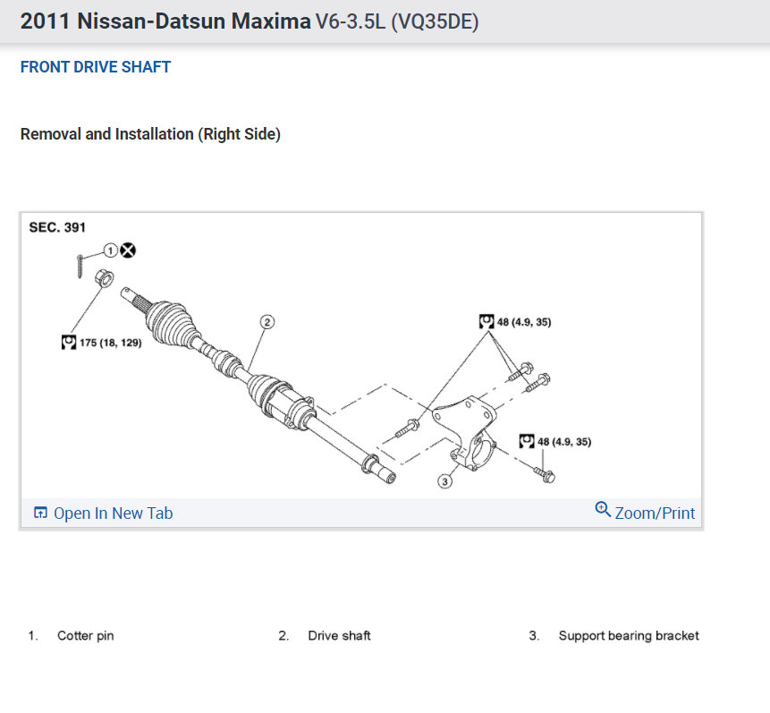

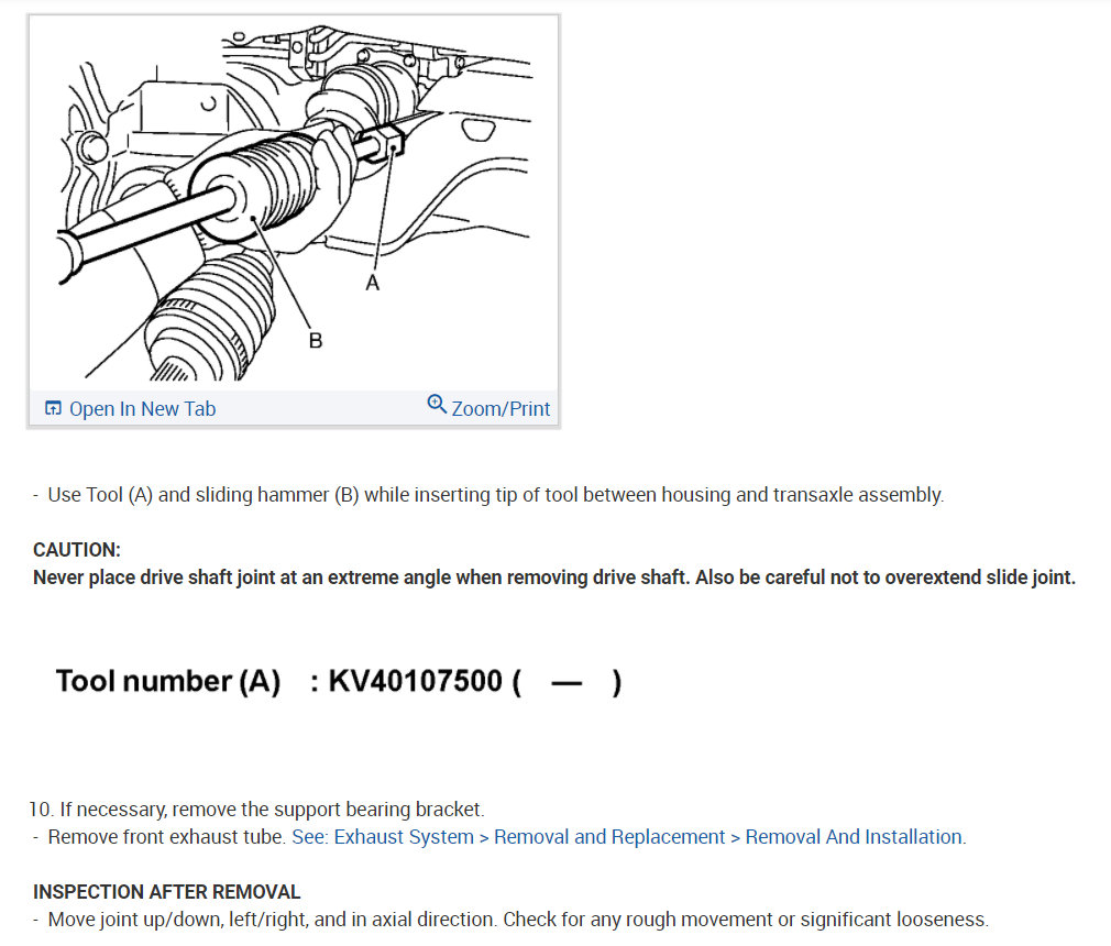

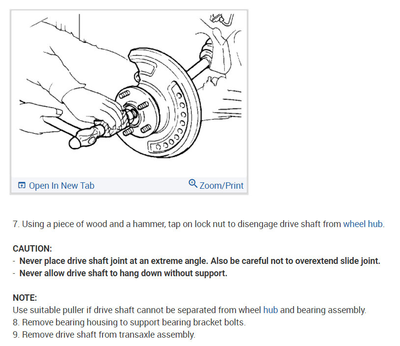

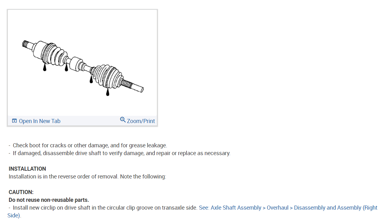

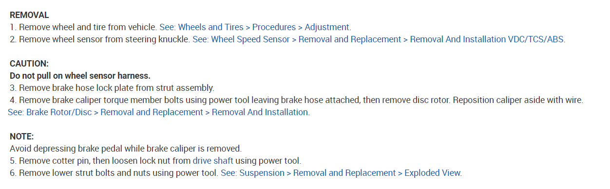

Right front axle wont come out, it has came partly out but can't get out behind boot.
Jan 18, 2021 at 9:24 AM
  • 55,636 POSTS
Yep, this can be tough we use a large pry bar. Here is a video to help you step by step with instructions in the diagrams below to show you how on your car:
