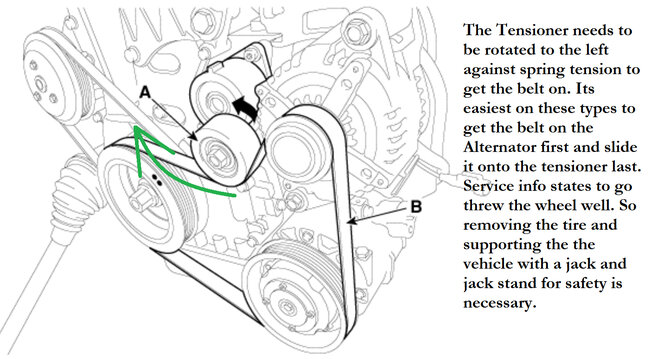

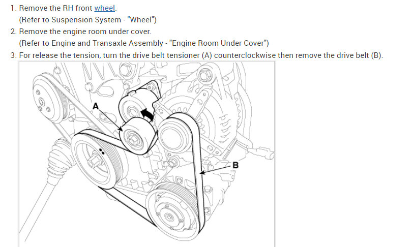

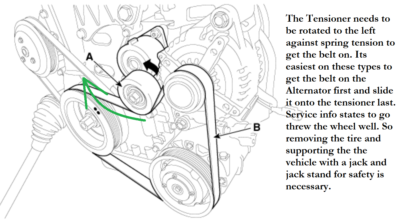

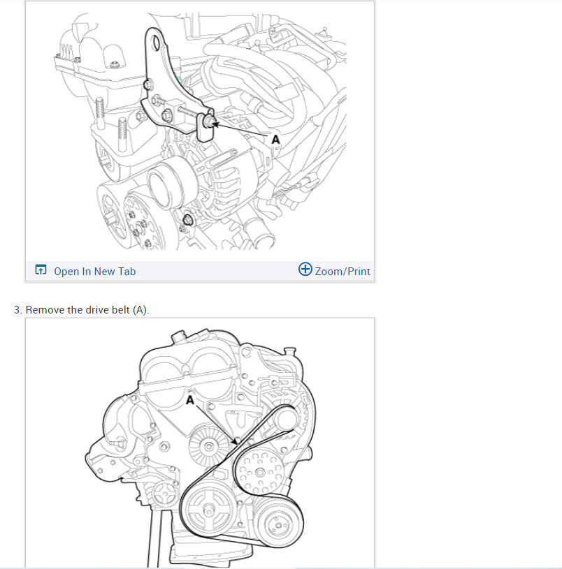

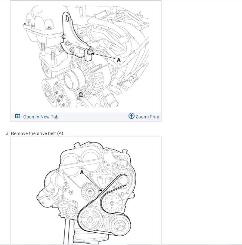

Can't get alternator belt on.
Jan 3, 2024 at 6:59 PM
AL514
Experienced Mechanic
5,686 POSTS
Hello, do you have an automatic belt tensioner for the drive belt or the adjustable type on the bracket that sits above the Alternator? I'll post diagrams of both.
