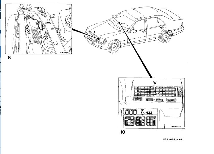

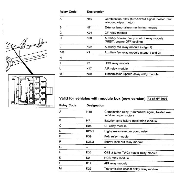

I cannot find the relay for secondary fan motor for the car listed above.
Feb 23, 2017 at 9:52 AM
Experienced Mechanic
55,561 POSTS
Hey TMONIQUE52,
It looks like it could be one of two places, here is a diagram and guide to help you fix the problem.
Please run some tests and get back to us so we can continue helping you.
Best, Ken
