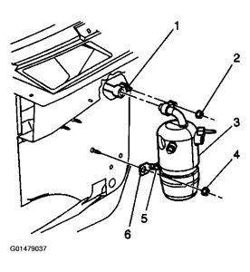

My AC seems to be working okay. I get it to about 42-44 degrees on setting 2, when I turn it up to setting 5 it seems to lose is coolness. I have been using a candy thermometer to test it and it just does not seem to get cold enough. My wife's Grand Caravan get to about 36 degrees. It takes my truck a good amount of time to reach 42 to 45 degrees. How cold should it get and how do I locate the low pressure side so I can recharge it if needed? What else could cause it not to get colder?

  • 55,423 POSTS
Hi, It sounds like the system is a little low on Freon. Here is a diagram on where the low side port is which is on the side of the accumulator, and here is a guides that will help you charge the system correctly:
https://images.2carpros.com/forum/automotive_pictures/198357_Graphic_462.jpg
https://www.2carpros.com/articles/air-conditioner-how-to-add-freon Please use 2CarPros anytime, we are here to help and tell a friend. Best, Ken
