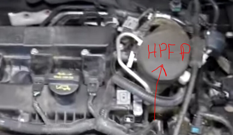

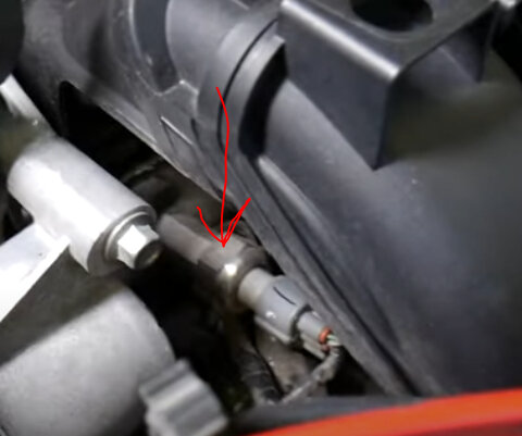

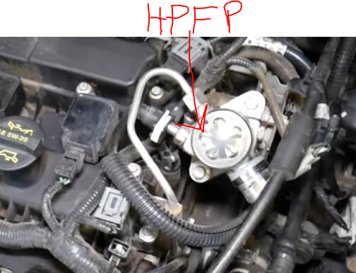

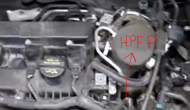

Having an issue with the vehicle stalling out and rough starting got a lean fuel code worked it out to most likely fuel pressure sensor but on problem it’s not on top of the fuel rail and I cannot find it. Would you be able to help explain where I could find it and there’s a second with images as well?
Jun 6, 2025 at 12:33 PM
  • 110,244 POSTS
I believe this vehicle has a high-pressure fuel pump located under the hood. See pics 1 and 2 below. Pic 1 is with the cover on and pic 2 is removed. If that is the case, the fuel rail pressure sensor is located under the intake manifold toward the front of the engine. See pic 3.
Note, the sensor I indicated is one of two sensors. There is a low-pressure sensor on the steel fuel supply line behind the engine. It identifies the pressure being provided by the low-pressure pump in the fuel tank. If you follow the steel fuel line from the HPFP behind the engine, you will find that one.
