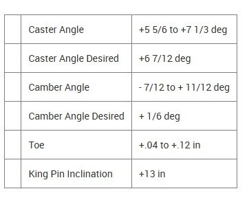

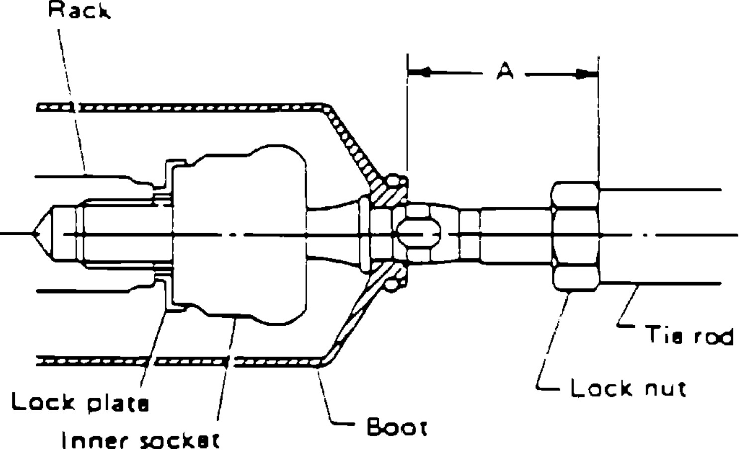

I'm trying to replace my tie rod ends on the front end of my car, but I cannot find the alignment specs. I'm needing the maintenance from the center of the car to the end of the tire rod for each tire rod. If you guys could help me out with that, I would greatly appreciate it.

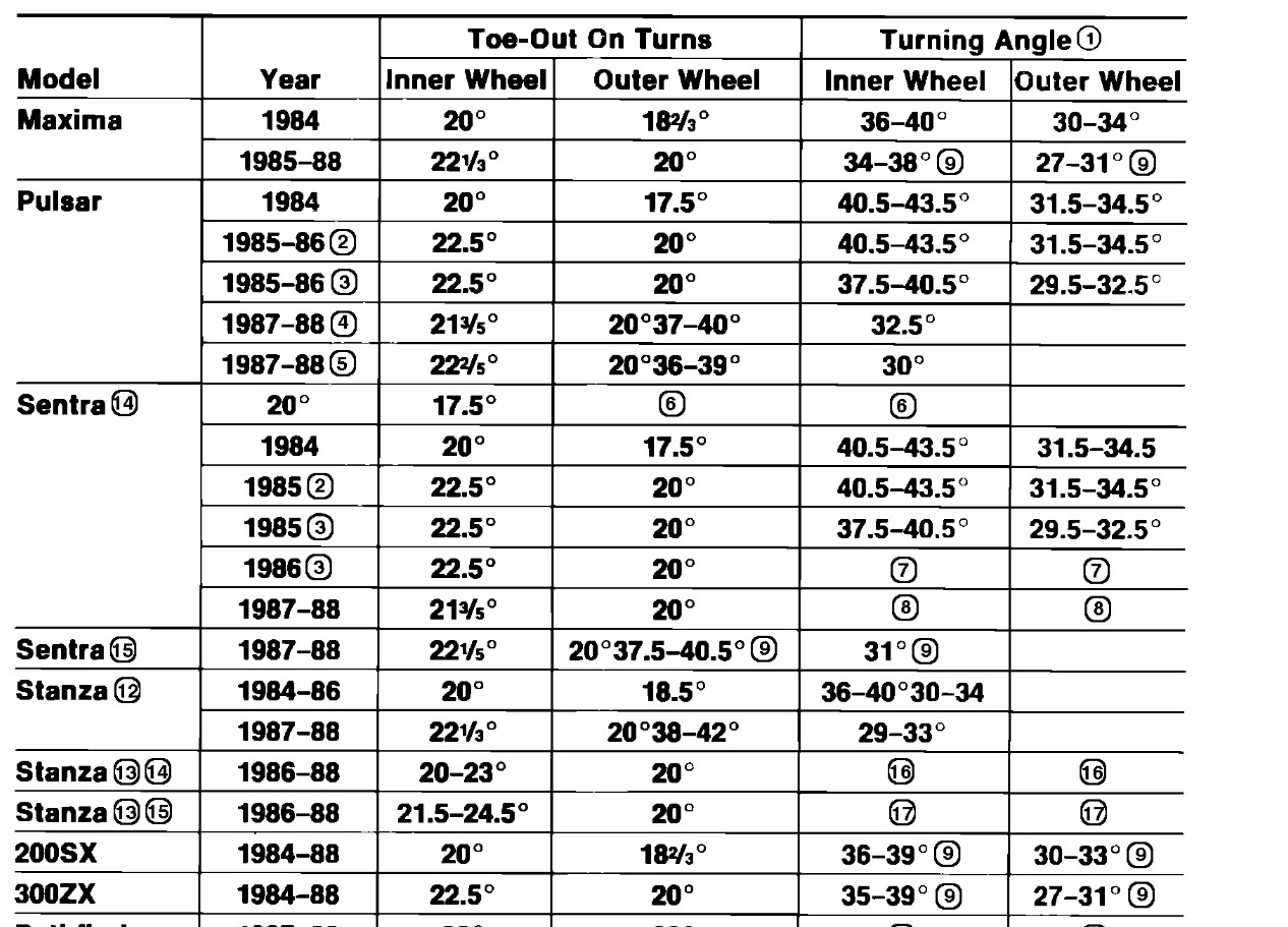

These are the alignment specifications for one with stock suspension. The tie rod extension in the second picture should measure 1.689 inches on a 300Z. The last image is the turning angles. On your car these are checked and set with the engine running at an idle and 25 pounds of force on the steering wheel rim.
