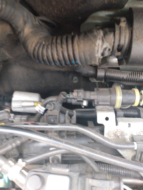

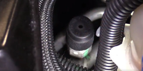

I can't find the low-pressure port to charge the A/C.
May 20, 2022 at 8:11 AM
SQM
  • 6,383 POSTS

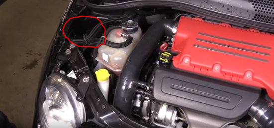

The low-pressure port is located close to the passenger side fender, under the hood.
See attached pictures for reference.
Here is a helpful guide on recharging the AC system:
https://www.2carpros.com/articles/air-conditioner-how-to-add-freon
Let me know of any questions.

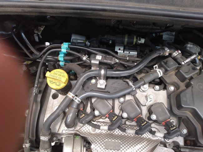

This is not the same engine that's in mine. the coolant jug is on the driver's side. all I could find is two ports none would fit the hose from the Freon can.
May 20, 2022 at 8:52 AM
SQM
  • 6,383 POSTS
Can you tell me or upload pictures of where you found those 2 ports?
May 20, 2022 at 8:57 AM
BRANDONC75
  • 6 POSTS

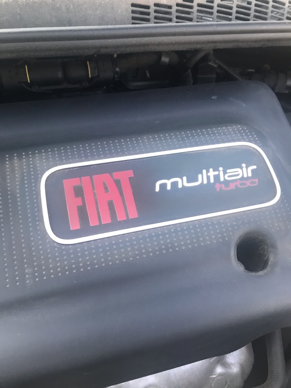

One is behind the cover that you take off.
May 20, 2022 at 9:16 AM

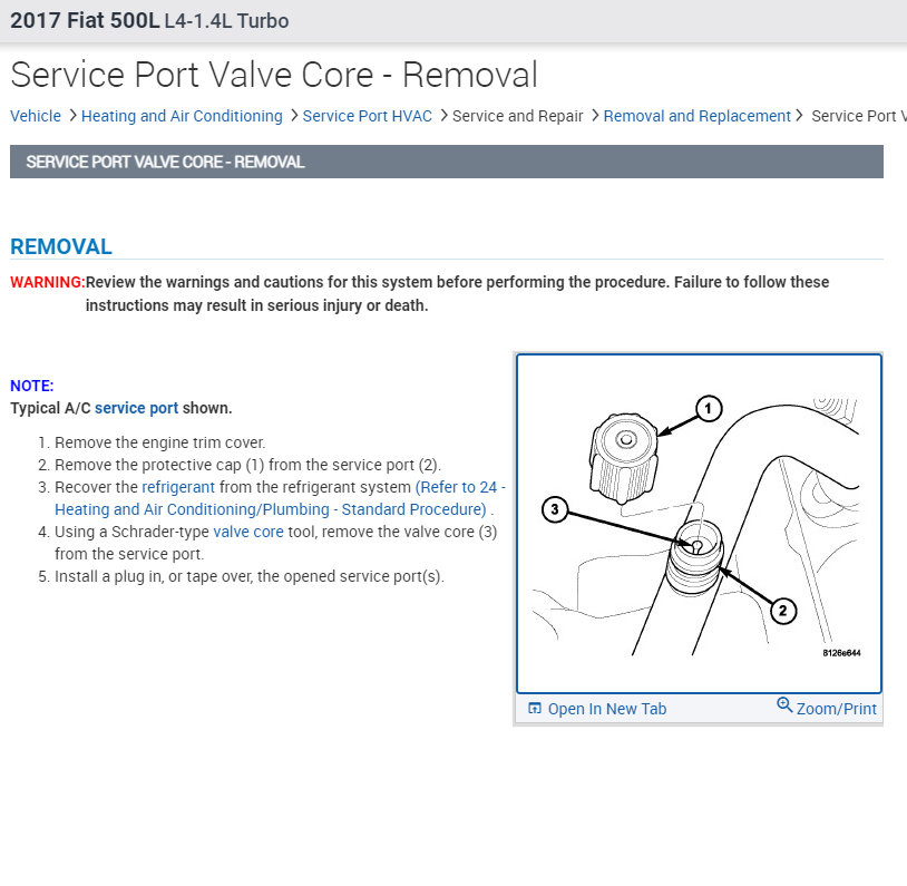

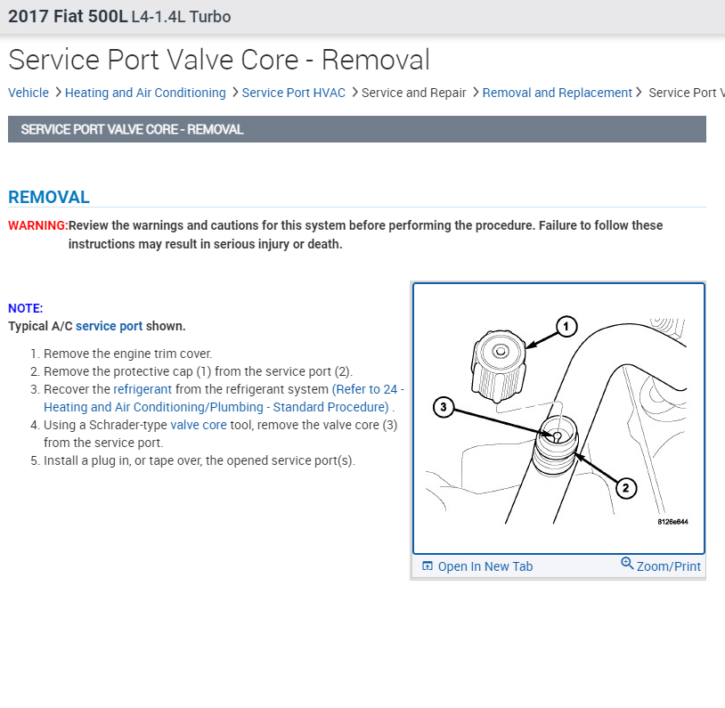

According to Alldata the low side service port should be the one under the engine cover. See below.
May 20, 2022 at 9:28 AM
BRANDONC75
  • 6 POSTS
Okay, thanks. I will look I must have missed it when I looked earlier.

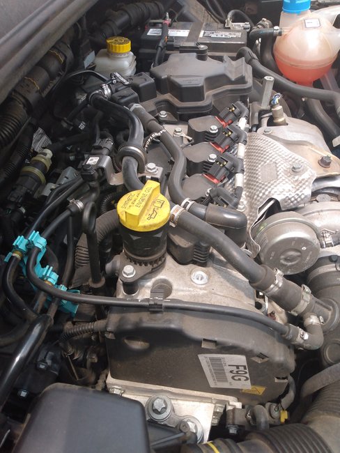

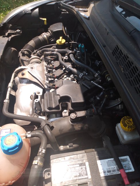

This is what the engine looks like. I still can't find it, lol.
May 21, 2022 at 3:35 AM
SQM
  • 6,383 POSTS
I am trying find other diagrams but there is just not enough info available.

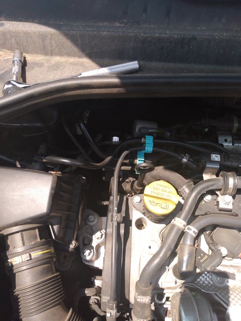

Can you take a few more pictures of the top of the engine area from different angles? It should be towards the back of the engine closer to the firewall.
May 21, 2022 at 4:21 AM
BRANDONC75
  • 6 POSTS

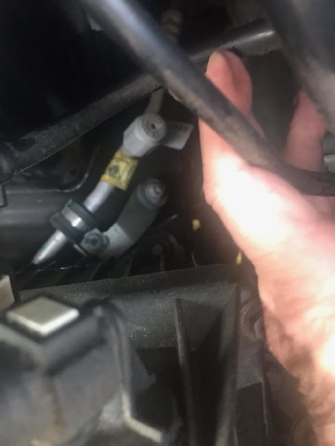

Yes, the only ones I see are the two ports with the grey caps on it that won't fit. I've looked everywhere.
