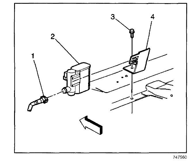

I cannot add fuel while the engine is running I have to shut the engine off to add the fuel.
Apr 6, 2018 at 1:53 AM
Good morning.
Do you mean the nozzle keeps kicking off when trying to fuel?
Apr 6, 2018 at 4:19 AM
OLDSMOBILE BRAVADA
Yes, but if I shut the engine off the handle does not kick off and the tank fills up fine. This has really got me puzzled.
Apr 6, 2018 at 7:45 AM
The only thing that controls that is the vent valve in the evap system. it is under the truck on top of the frame rail. you need to remove the spare tire to get easier access.
