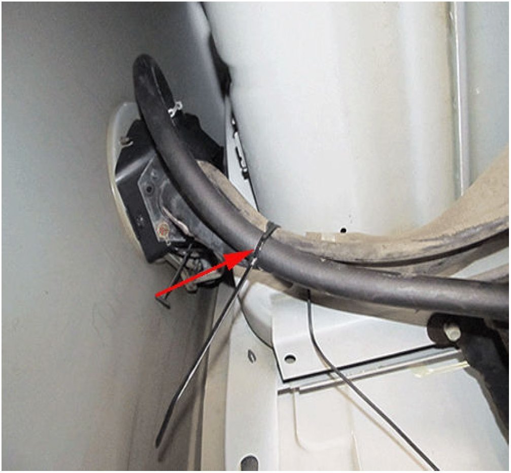

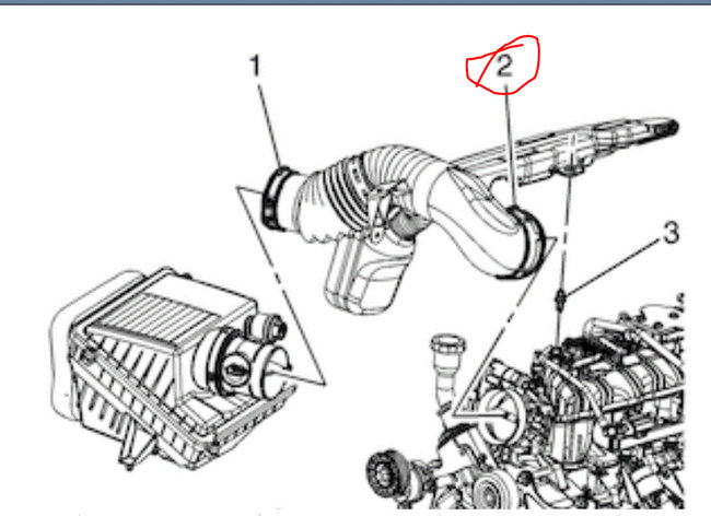

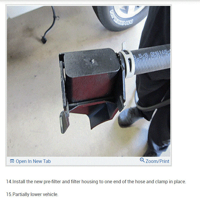

As far as the MAF, have you replaced it? The MAF incorporates the IAT (intake air temperature sensor). Also, have you checked the air intake tube where it mounts to the throttle body? There were issues with them cracking and allowing unmetered air to enter the engine. See pic 1 below.

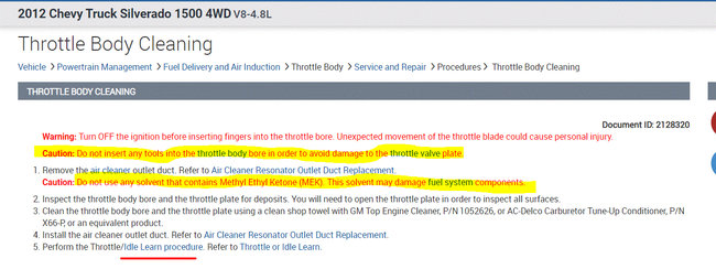

Next, if you sprayed a lot of throttle body cleaner into it, that could have caused issues for the spark plugs. Also, when you open the throttle plate by hand, you have to perform an idle relearn procedure.

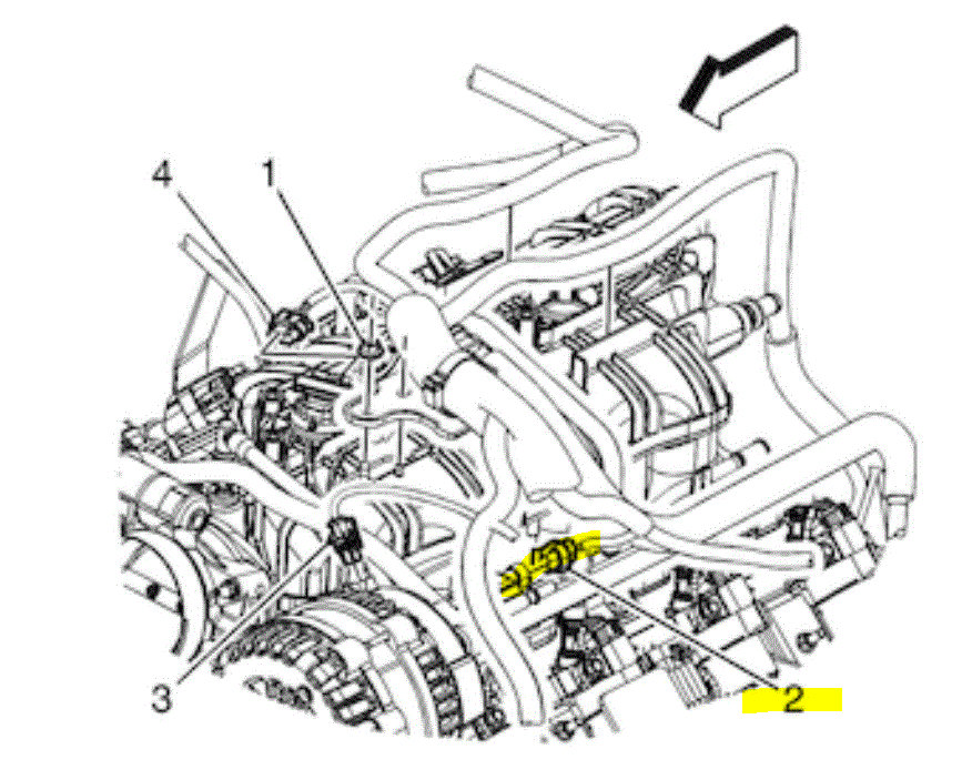

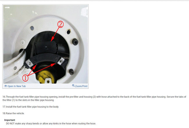

Do me a favor, take a look through the manuals directions for cleaning the throttle body. (see pic 2 below). Pay attention to what I highlighted and check the product you used.

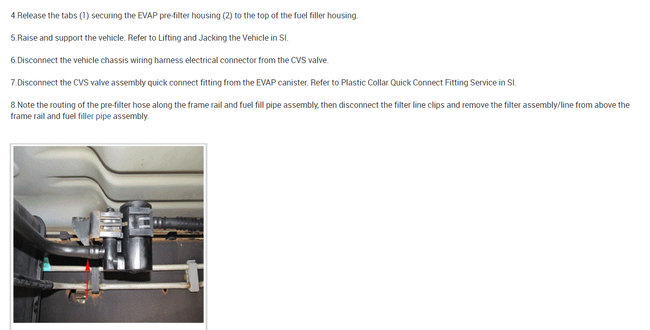

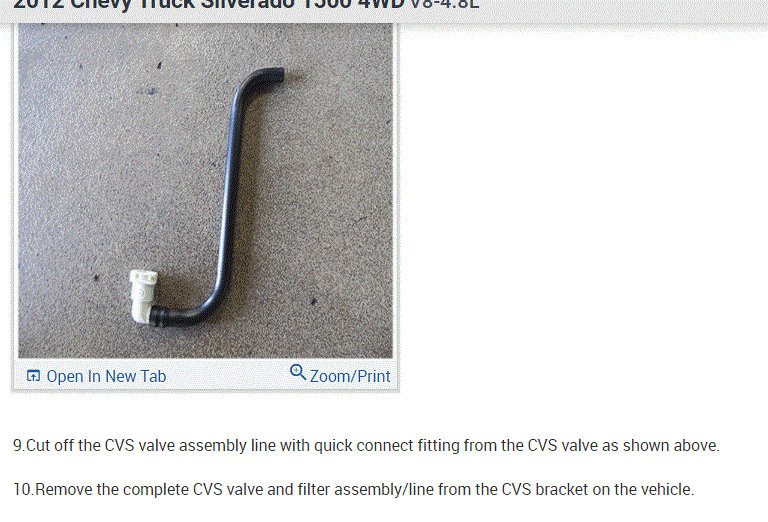

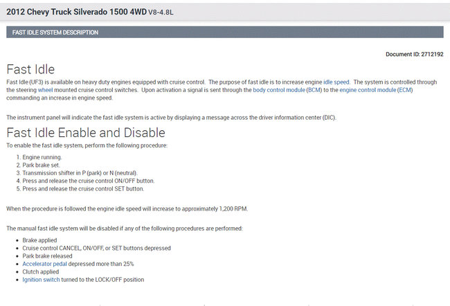

If you look at pic 3, it explains the idle relearn procedure.

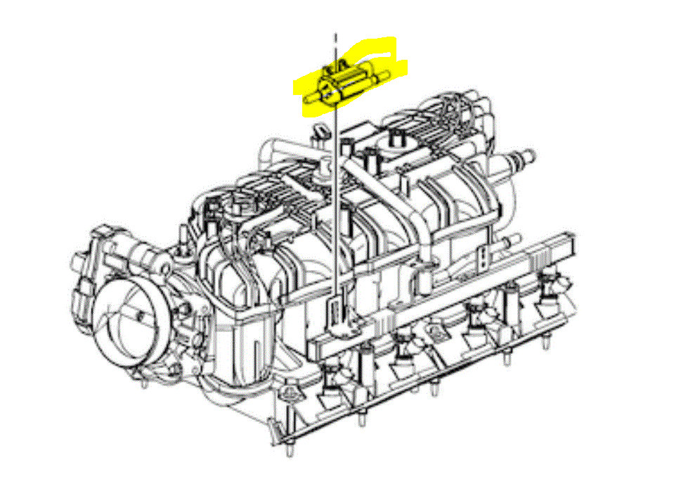

Where are you smelling gas? Does it seem like it's running rich or do you smell it from a different place? It could be an issue with the EVAP system causing a vacuum leak.
Do me a favor. Check the EVAP purge solenoid. I attached two pics below to help you locate it. Check the line to and from it. Make sure nothing is disconnected or damaged. When that solenoid opens, it allows fuel vapor to enter through the intake. It comes from the charcoal canister. The solenoid itself may be damaged causing a vacuum leak (lowering RPMs) and the fuel smell.

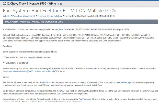

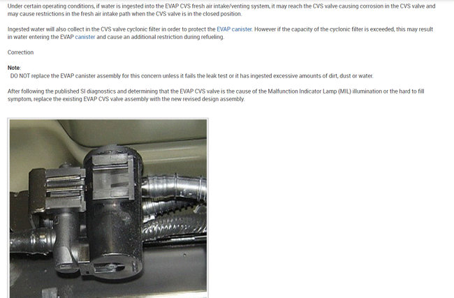

I’ll check that!! Do you think it might be the charcoal canister? I also noticed that I have a hard time filling it with gas because it’s not venting properly it takes forever to fill up because I can’t hold it open all the way it keeps stopping like it’s full. I saw online that they get plugged up.

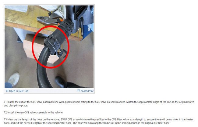

  • 110,241 POSTS

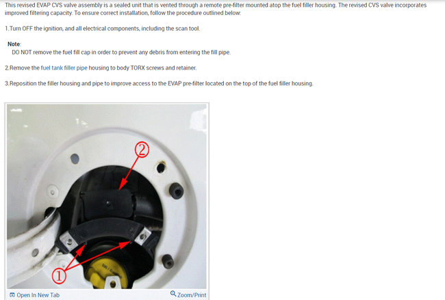

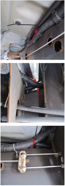

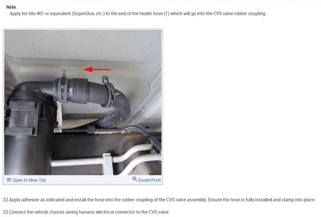

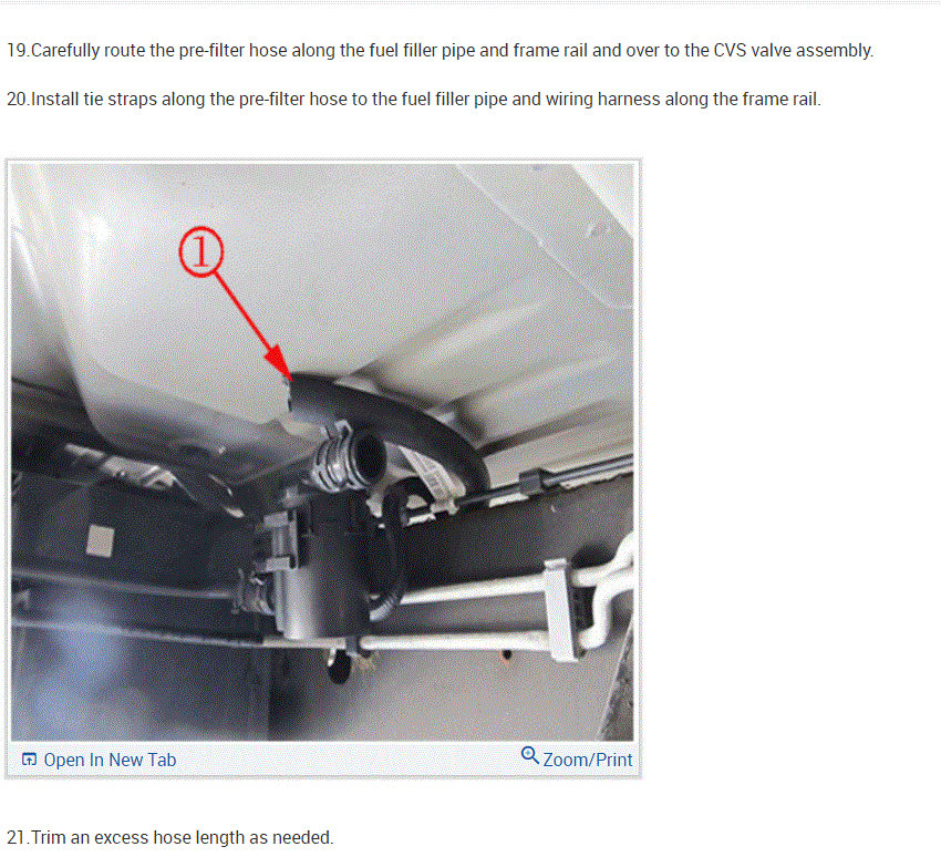

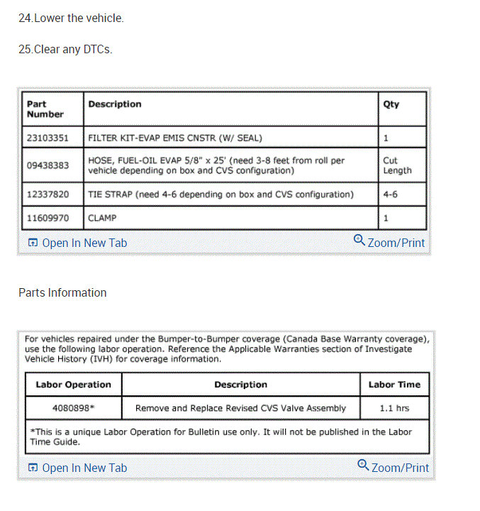

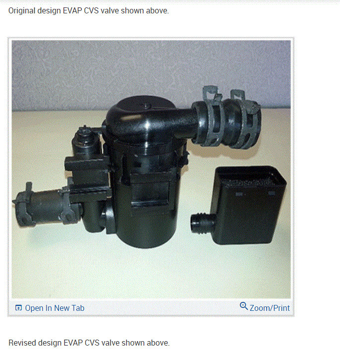

I found an interesting technical service bulletin you may find of interest. It deals with the fuel tank slow filling.
See the pics below and let me know if you feel this could be relevant.

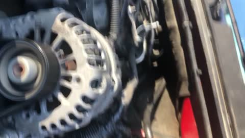

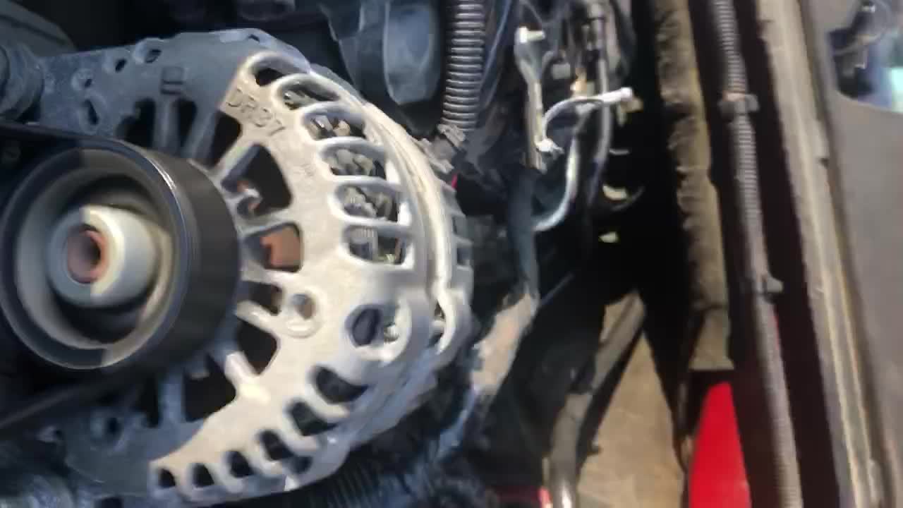

I went back and those codes went away, but I got new codes P0011 and P0443 and then the engine sounds like this and it quit running right after.
Apr 2, 2021 at 8:36 AM

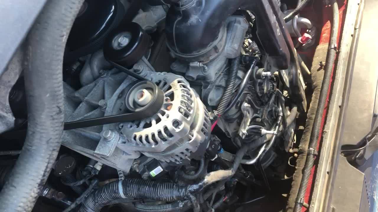

TJVAN518
  • 15 POSTS
Another video.
Apr 2, 2021 at 8:37 AM

In the first video, it sounds like an exhaust leak. I can't identify anything in the second.

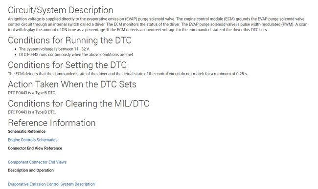

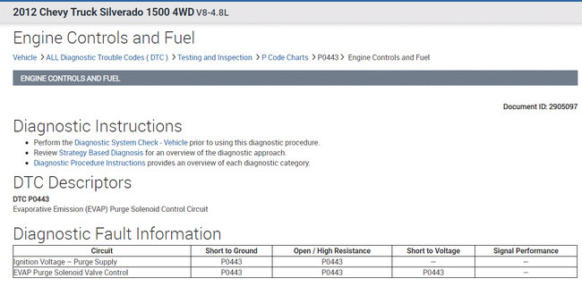

The 443 is related to the purge solenoid. I asked about that earlier. Are you certain it is working?

  • 110,241 POSTS

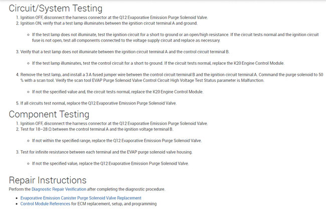

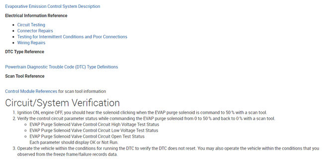

As far as the purge solenoid, you can't check it that way. You need to confirm power to it (using a scan tool that can actuate) and you check resistance in the actuator.
If you look at the attachments, I included the diagnostics and tests for the purge solenoid. Take a look through them and see if it is something you feel comfortable doing. If you need additional information, let me know.

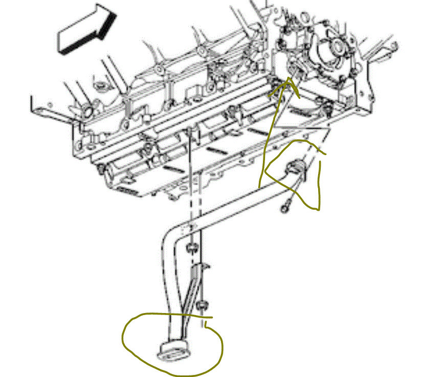

That is odd. You mentioned earlier that there was white smoke. If you check the engine oil, is it clean, full, and no evidence that coolant is mixing with it? Also, does it smell like gas could be mixing with it?
As far as dirt in the engine, if you replaced the oil pump, I have to assume the pick-up tube in the oil pan was checked to make sure it was clean, correct? And where the pick-up tube attaches to the pump was properly secured, correct?
See pic below for the two areas I'm questioning.

  • 110,241 POSTS
If you are losing oil pressure intermittently, that is a big concern. The only thing I can think of is the pump wasn't installed correctly, the pick-up tube isn't sealing, or something is blocking the pick-up tube.
