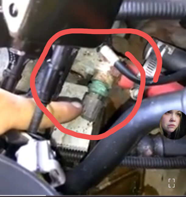

What is the name of the part the temperature sensor screws into?
1997 FORD TAURUS
200,000 MILES • 3.0L • V6 • 2WD • AUTOMATIC
KEVIN.GUERRETTE

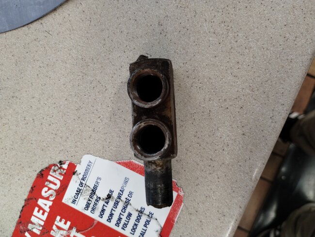

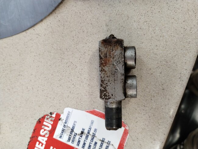

Hi all, I have the car listed above GL with the Vulcan 3.0 ohv v6. The pipe the coolant temperature sensor screws into broke and I can't find the name of the part anywhere nor can I find the part. Does anyone have any ideas?
Aug 26, 2023 at 12:09 PM
  • 55,456 POSTS
That is called the heater pipe extension fitting. Please let us know if you need anything else to get the problem fixed.
