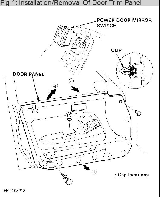

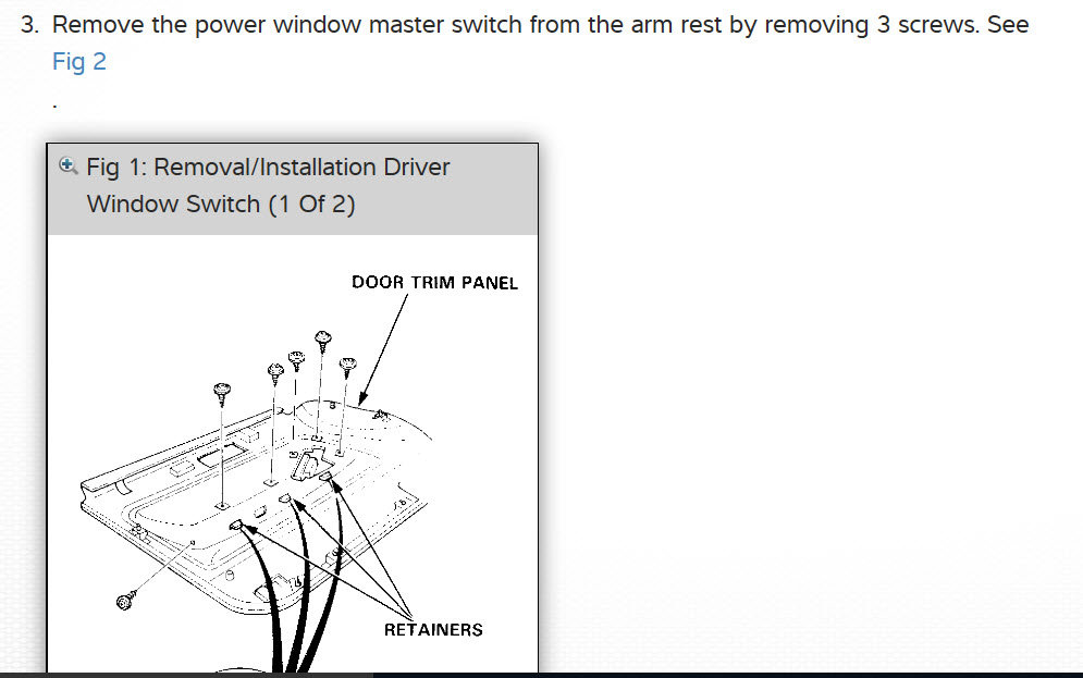

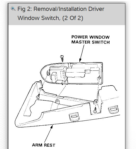

After removing the left front door switch from its mounting I cannot pull it lose from its connector. can you help?

you have to pull the door panel off first. See pictures.
