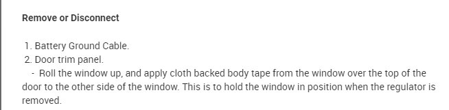

door latch on the side of the front door is closed which doesn't allow that door to be closed.
Nov 20, 2021 at 7:22 AM
There could be an easy fix for this which is to just open the door handle on the inside of the vehicle. The exterior handle will not flip the latch, but the inside will. So, give that a try and let us know if that opens the latch.
If not, then we may need to open the door panel and see what is happening when you operate the handle.
Here is a guide that will help with this:
https://www.2carpros.com/articles/door-panel-removal
https://www.2carpros.com/articles/car-door-hood-or-trunk-will-not-close
Please run through this and let me know what you find, and we can go from there. Thanks
