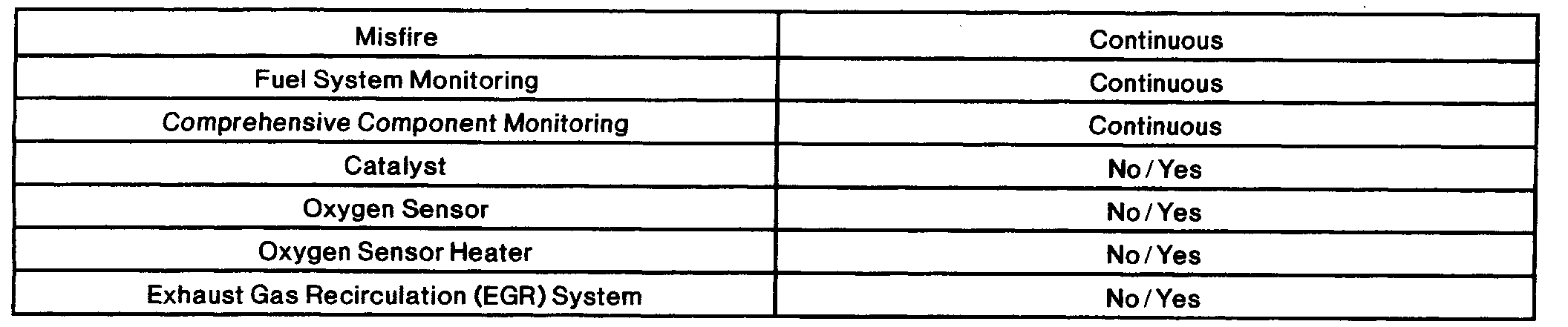

have no check engine light, but i cant get the EGR or catalyst drive cycles to clear.

How many miles have you driven and under what conditions? I have to be honest, at present, I have a vehicle I'm driving to clear the system test and after 140 miles, I still have two incomplete. It is a frustrating condition especially not that I have nearly 3 hours into driving and the customer wants the vehicle back. I can't get it through emissions with two incomplete.
So with that, tell me what was done to the vehicle for you to clear codes. That way I can check if anything specific is needed for a drive cycle on you particular vehicle.
Otherwise, here is the general information on drive cycle on your vehicle. The attached pic correlates with the directions.

OBD II Monitors
See pic 1
INSPECTION/MAINTENANCE TESTING - OBD II SYSTEM READINESS MONITORS
In some areas of the country, it may become a legal requirement to pass an Inspection/Maintenance (I/M) test of the OBD II system. Before I/M testing can proceed, the OBD II Drive Cycle must be performed and all of the diagnostic monitors completed successfully. During the mix of city and highway driving involved in the OBD II Drive Cycle, the diagnostic monitors will test certain parts of the OBD II software and hardware used to control vehicle emissions. While some of the monitors will run to completion and indicate a YES or NO, others such as misfire or fuel system will continuously run.
