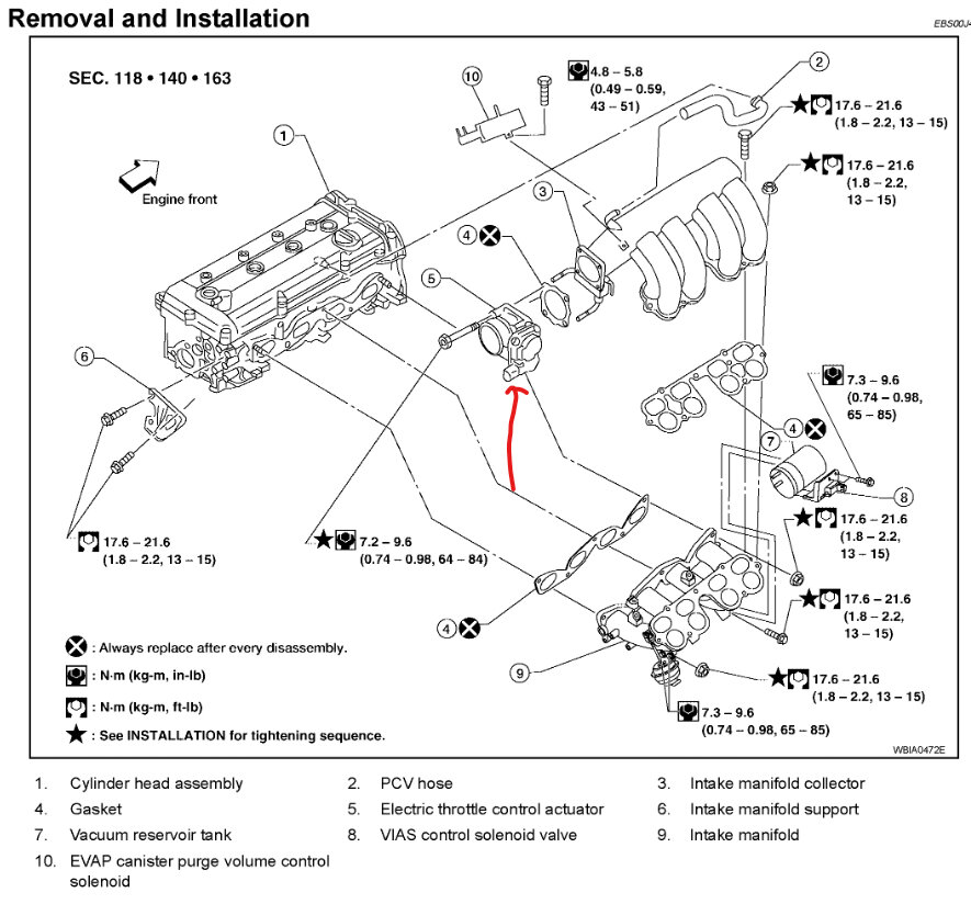

Does not accelerate after sudden stop or sudden slow down?
2006 NISSAN ALTIMA
315,000 MILES • 2.5L • 4 CYL • 2WD • AUTOMATIC
PMHAROON327
If while driving and suddenly brakes or suddenly slow down the speed, car can't accelerate for 15 seconds and after 15 seconds it comes to normal acceleration mode. this issue only while sudden decrease in speed.

The car is going into limp mode, we should run the codes to see if any are stored but we had a car that had this problem in the shop, and we serviced the throttle bore which fixed it. Here are to guides to help which you should go over, and I have included how to remove the throttle bore in the images below:
and
https://www.2carpros.com/articles/reduced-power-limp-mode
This guide can help walk you through the steps to do the service:
