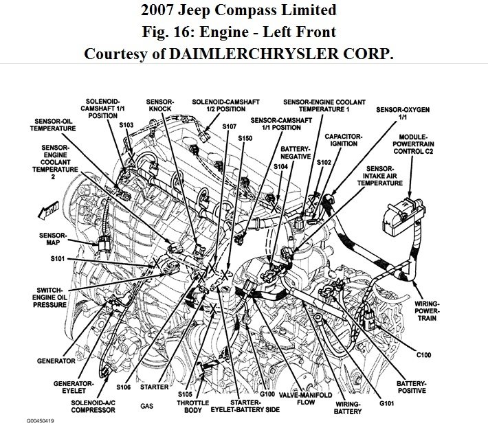

canshaft positioning sensor
2007 JEEP COMPASS
102,000 MILES
CHYSSY
I dont know where the camshaft positioning sensor is located. I had it diagnosed today but dont know where it is to change it.

The camshaft position sensor is at the rear of the engine on the cylinder head. Here is a guide and the diagrams below so you can see how the job is done.
https://www.2carpros.com/articles/camshaft-angle-sensor-replacement
