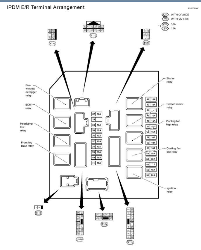

Truck ran okay, went out next morning will not start.
Sep 20, 2020 at 3:52 AM

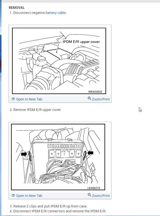

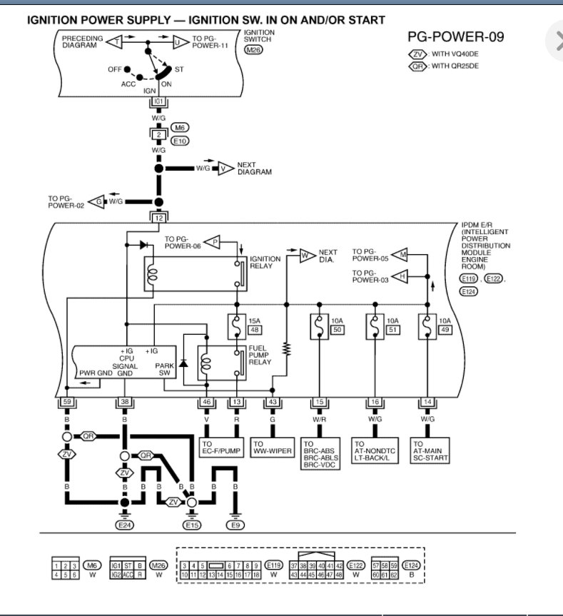

The fuel pump relay is part of the IPDM. I attached the info on this. Does the fuel pump turn on when you turn the key? If it does, we need to check pressure as the relay is working.
Let's start with this and go from there.
