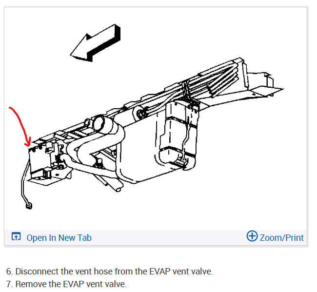

Where is the canister vent valve solenoid located?
2020 CHEVROLET MALIBU
6,000 MILES
JOSE MERCADO
MEMBER
1 POST
Canister vent valve solenoid location needed.
Dec 25, 2024 at 12:04 PM
Experienced Mechanic
55,684 POSTS
The canister vent valve solenoid is at the rear of the car by the charcoal canister itself. Here is the location, check out the images (below). Let us know if you need anything else.
