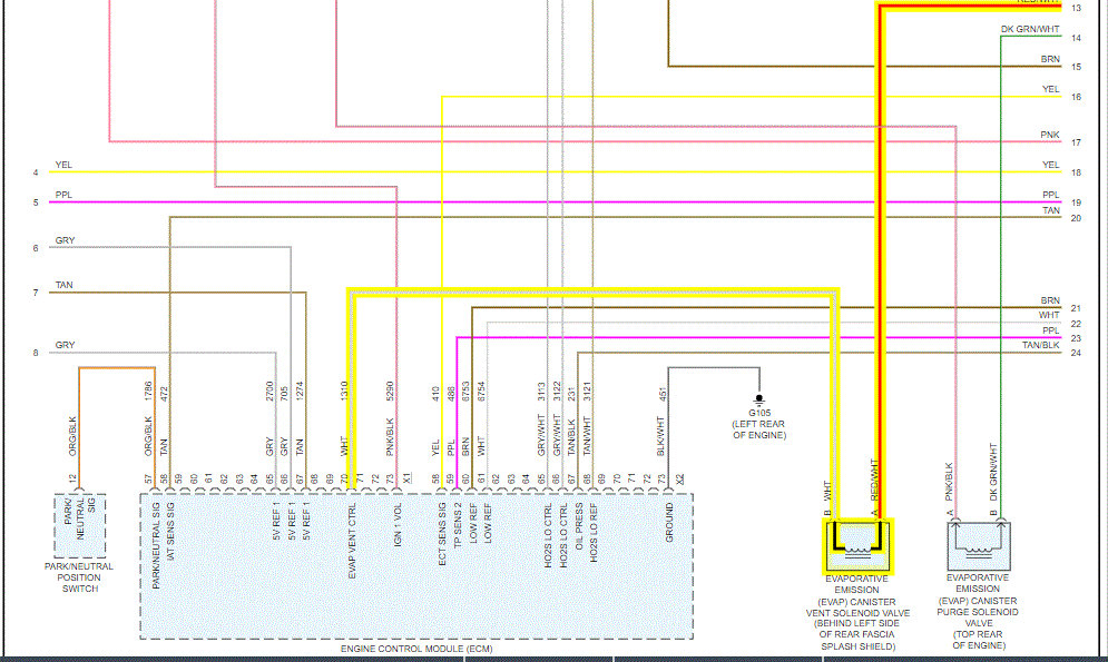

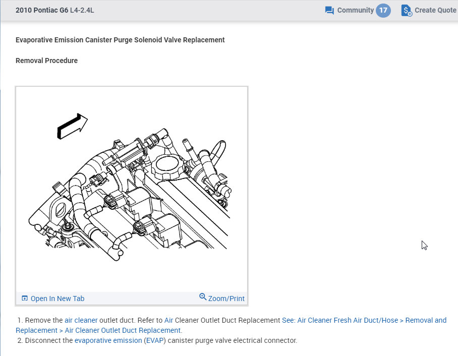

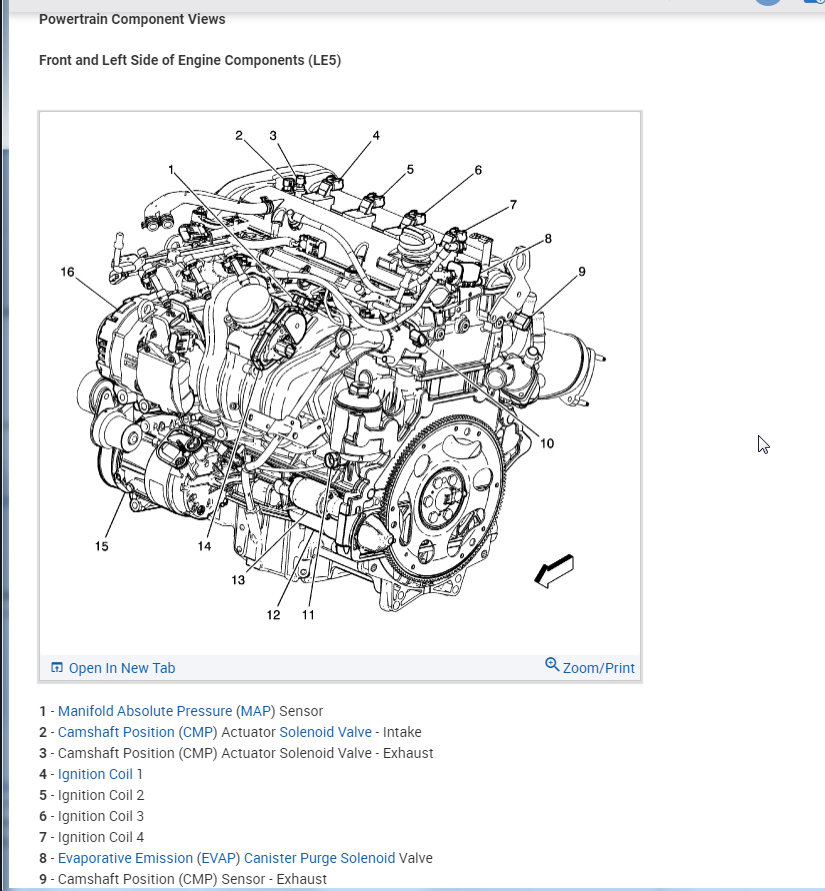

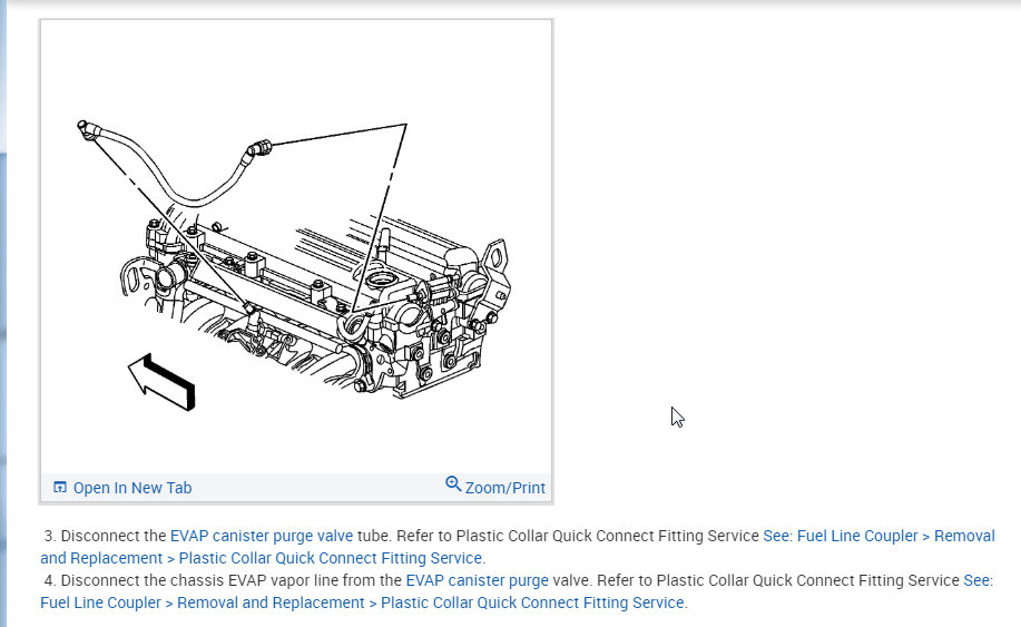

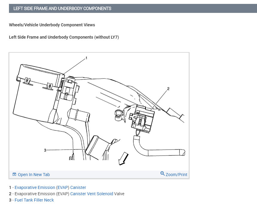

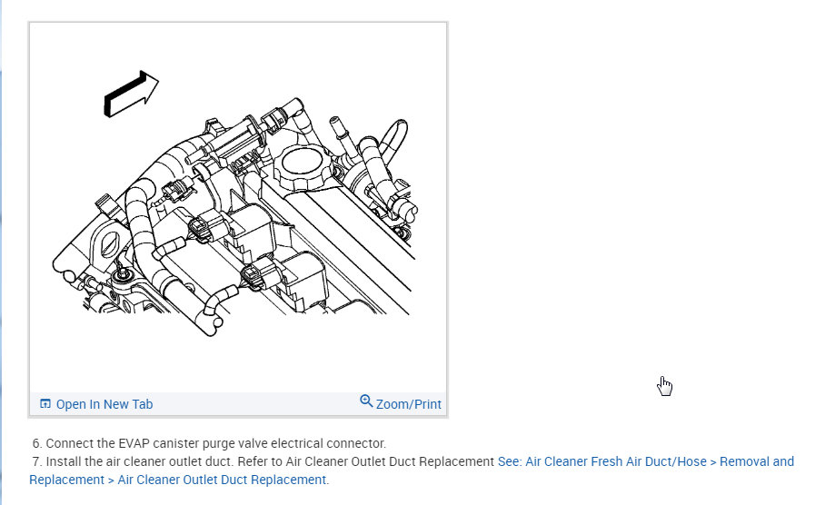

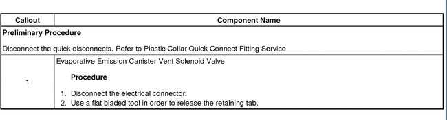

i need to know where the location for a canister vent valve for my car listed above flex fuel please. I have the part I just do not know where to remove and replace location is at.
Jul 13, 2020 at 9:12 AM
Good evening,

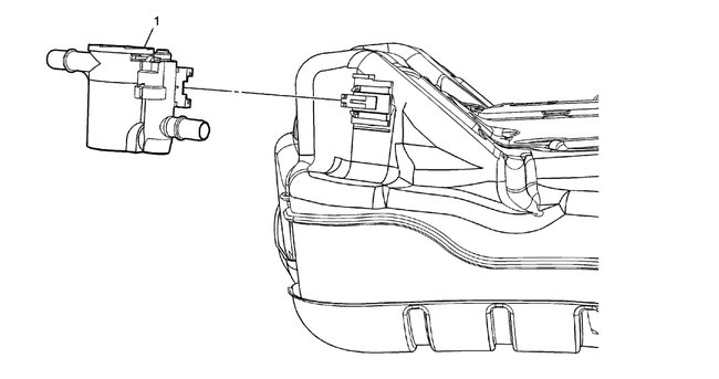

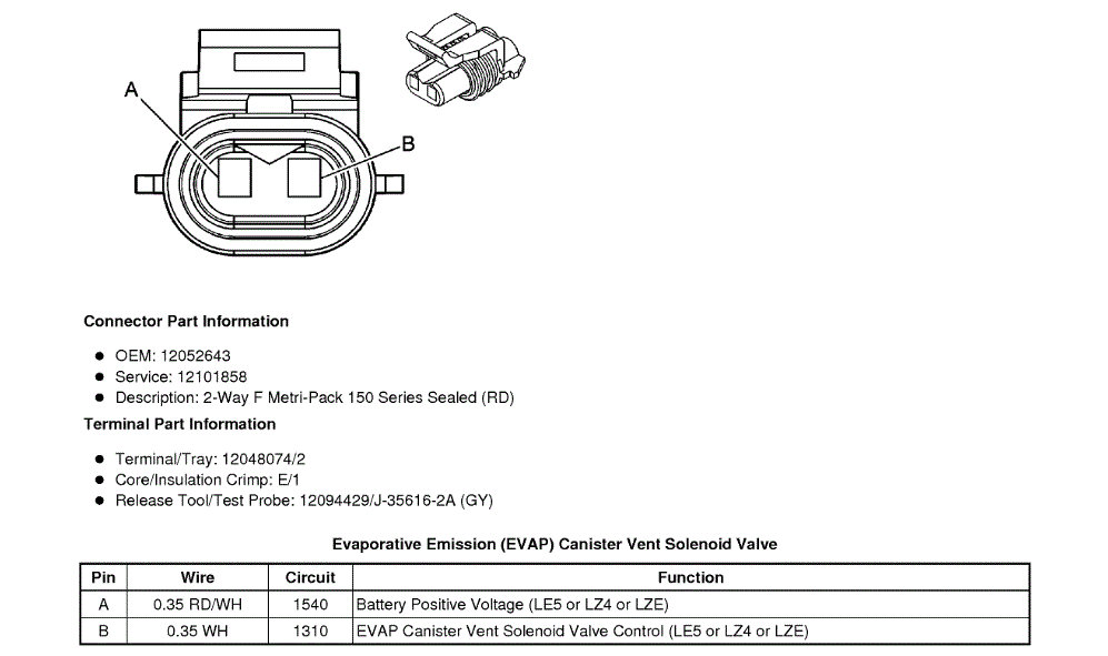

I attached a picture and procedure for replacing the valve.
Why are you replacing it? Did you have a code? Did you verify power to the solenoid?
https://www.2carpros.com/articles/how-emission-control-systems-work
Jul 13, 2020 at 9:24 AM

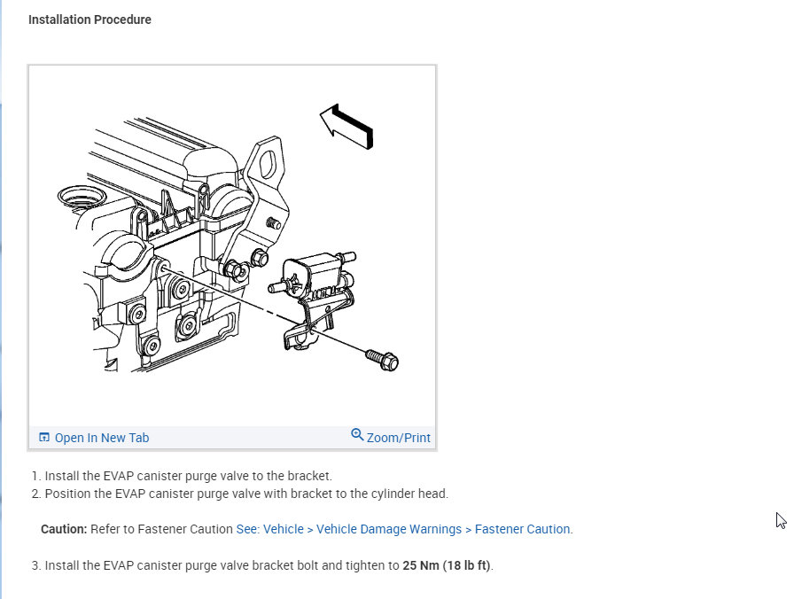

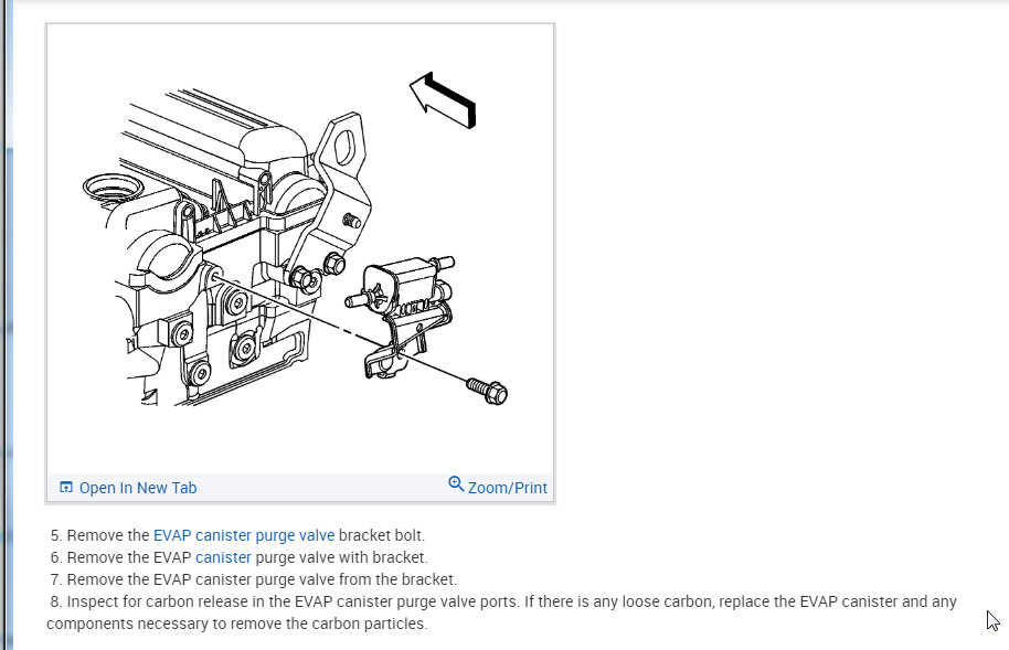

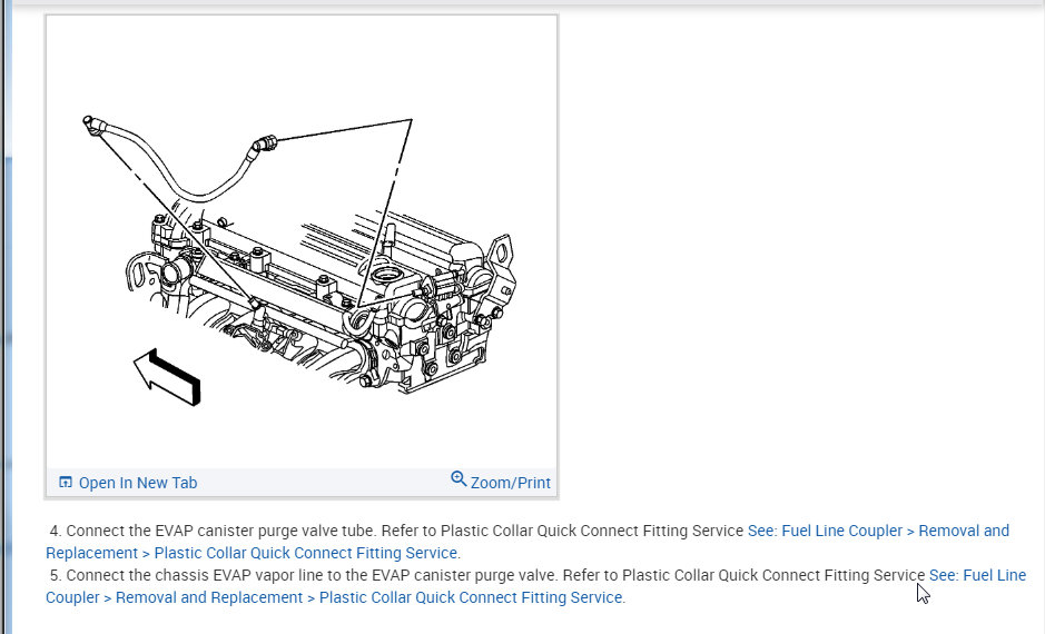

I attached the process for the vent valve as you mentioned but many confuse this with the purge valve so I attached the process for the purge valve as well.
Let us know if you have other questions. Thanks
