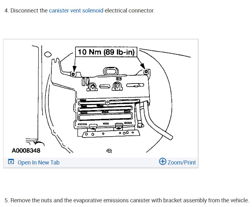

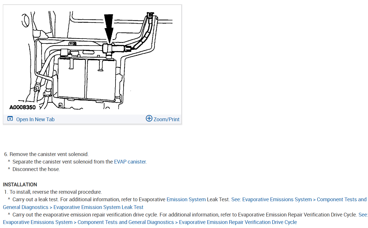

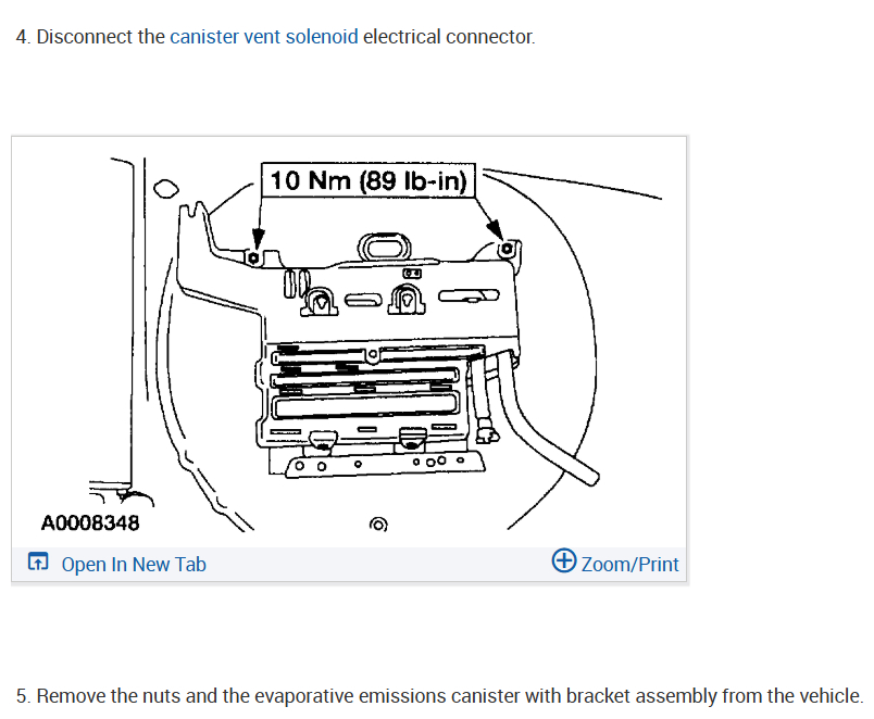

I need to know where it is located and how to access it on the vehicle listed above wagon.
Dec 13, 2024 at 3:25 PM
Experienced Mechanic
55,711 POSTS
The EVAP canister vent valve is below the spare tire wheel well. Check out the images (below). Let us know if you need anything else.
