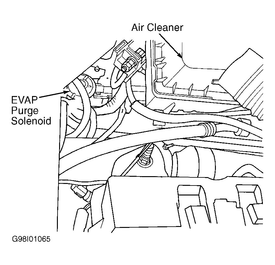

Hello, I am looking for the location of the canister purge valve.

The EVAP purge solenoid is located next to the air cleaner housing. It is mounted to a bracket right next to it. I have attached a picture to help you locate it.
Let me know if this helps.
