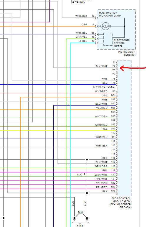

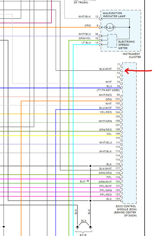

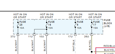

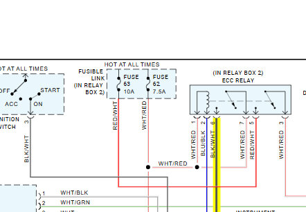

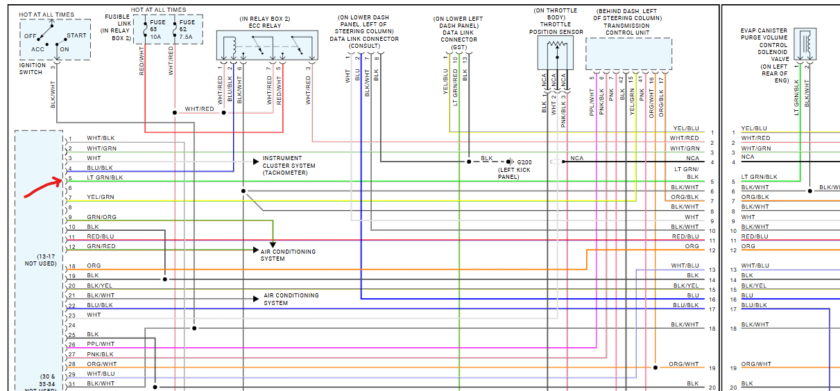

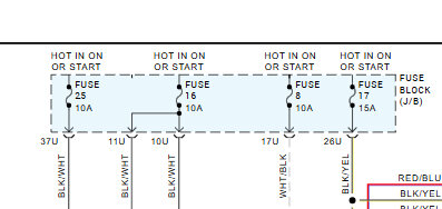

No power to the canister purge solenoid plug.
Dec 18, 2025 at 9:03 PM
  • 55,433 POSTS
So the power and ground comes from the ECCS (ECM) so I would check the fuses which I have included in the images below and I have included the wiring daigrams as well. This guide should help.
Check out the images (below). Let us know how it goes
