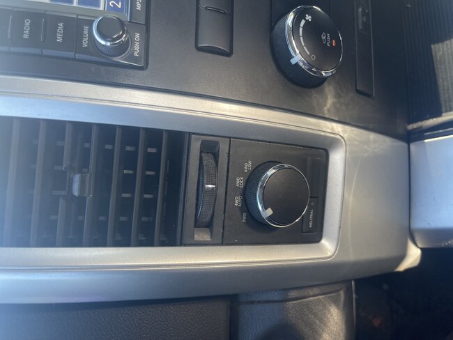

Tell Me The Difference Betwee These 2 Vs 4x4
2011 RAM 1500
150,000 MILES • V8 • 4WD • AUTOMATIC
BHAMDOC1973
  • 2,007 POSTS
A simple explanation please?
Nov 18, 2022 at 12:20 PM
CARADIODOC
  • 34,321 POSTS
In 4-wheel lock, the front and rear driveshafts are locked together all the time. Avoid that when driving on dry pavement as it puts a lot of stress on the transfer case.
4-wheel auto leaves the two driveshafts unlocked until their speeds differ due to a spinning tire, then they lock up momentarily. You are unlikely to feel the engagement, but it makes going through deep snow a lot of fun.
