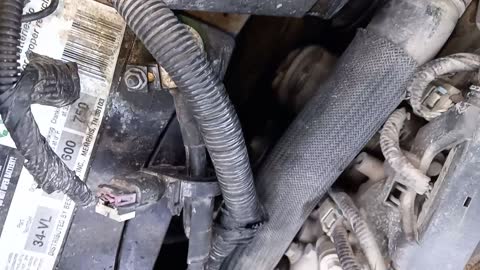

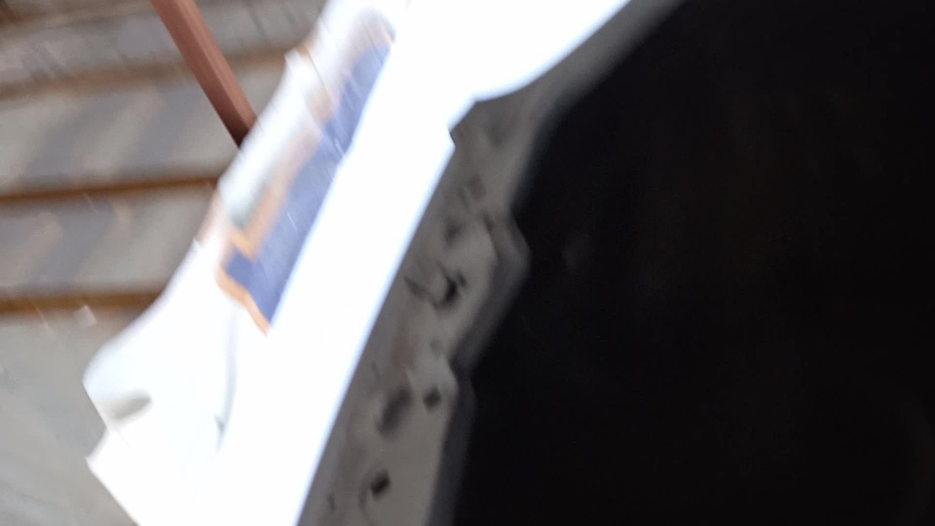

In this video you wilk notice an oil slick from a slow leak on the back passenger side of the engine. Also there seemed to be a smal bit of oil under the power steering rez. Any advice is appreciated.

Thanks for the video. It was a little jumpy, so it was hard to tell what was going on. Can you send a video of what you are looking at? It could be the valve cover gaskets, timing cover, oil pressure sensor or the intake manifold is starting to seep. Do you have drips on the ground?
This guide can help us:
https://www.2carpros.com/articles/engine-is-leaking-oil
Please upload pictures or videos in your response to the problem so we can see what's going on.
