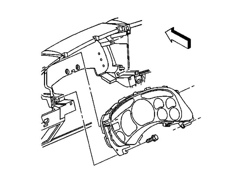

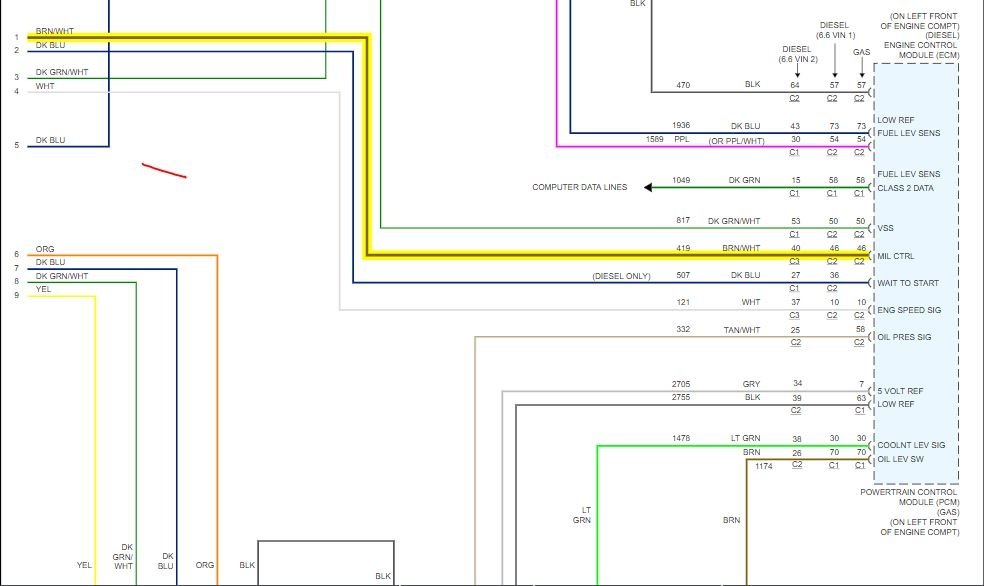

Can you change out the check engine bulb or your do you have to change out the hole cluster? I had a emission done and it said that the check engine was out.
Friday, January 10th, 2020 AT 1:56 PM
  • 52,797 POSTS
Good evening,
You cannot replace the bulb. You have to replace the cluster to get that to work.

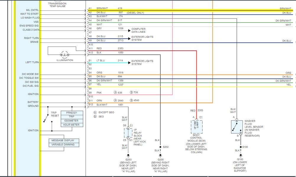

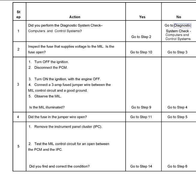

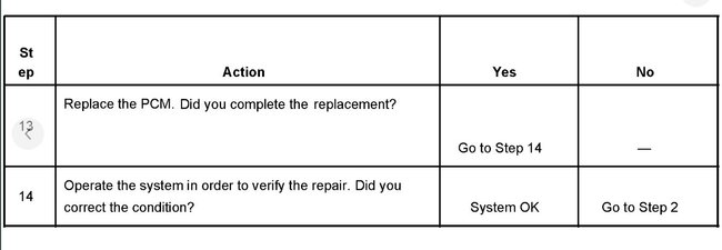

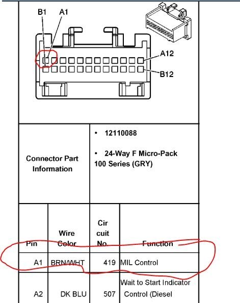

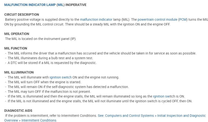

Did anyone check to see why it is not working?

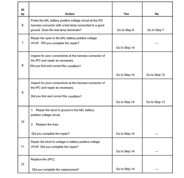

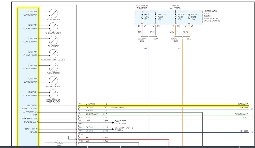

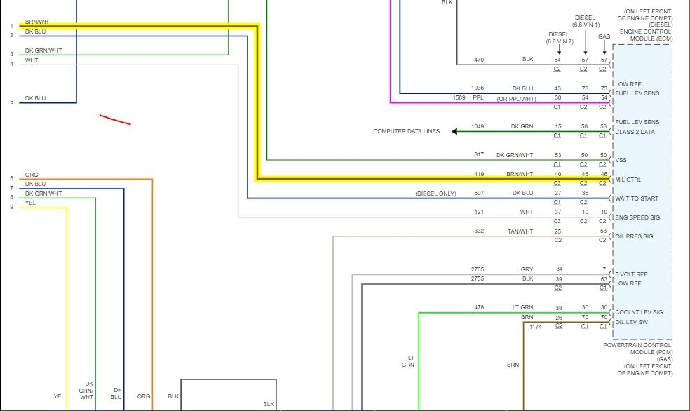

I sent a diagram for you to view. The light is controlled by the ECM. Check the wire at the cluster for power. I highlighted the wire that you need to test.
