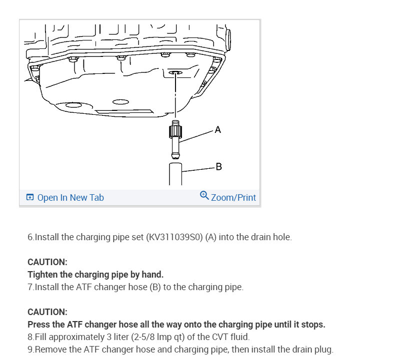

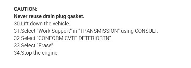

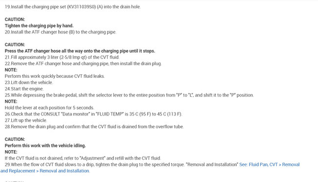

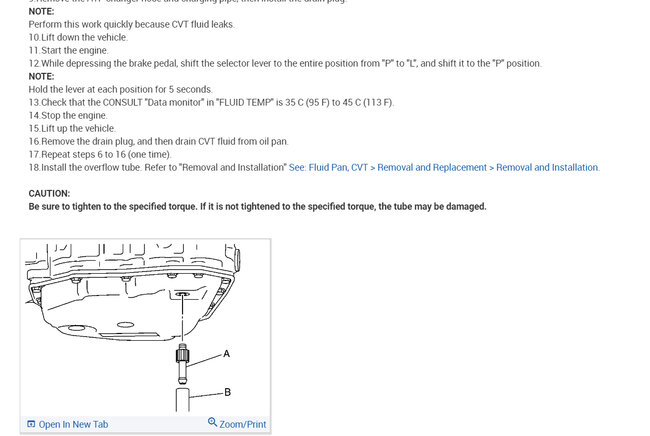

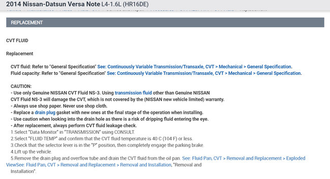

These are all separate questions, please make question with one subject. We will handle the CVT fluid change on this thread.
Fluid Types
Continuously Variable Transmission (CVT) Fluid (If equipped)
Type .................... Genuine NISSAN CVT Fluid NS-3*
*Use only Genuine NISSAN CVT Fluid NS-3. Using transmission fluid other than Genuine NISSAN CVT Fluid NS-3 will damage the CVT, which is not covered by the NISSAN new vehicle limited warranty.
Capacities
Capacity .................... 7-1/4 qt (6.9L)
This generic guide can help, and I have included the instructions for your car in the images below. Check out the images (below). Please let us know if you need more help.
