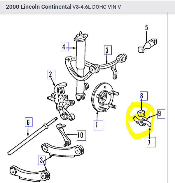

I looked underneath and everything looked okay. But I noticed some play in the sway bar (right, rear side) which is where I hear the clunking when I go over bumps. There was oil on the tire near it (again, right rear side).

If you hear the compressor running, chances are it isn't the battery. Instead, it sounds like you have an air leak.
Oil on the tire? Is the shock leaking? Could it be brake fluid? Check the brake fluid level to make sure it isn't low.
As far as the stabilizer, I attached a pic below and highlighted what I believe you are referring to. Please confirm.
If that is the issue, make sure the sway bar isn't broken. If it isn't, that is a very inexpensive part to replace.
The electrical issues in the vehicle are interesting. If you could, copy and paste that section to a new thread so someone helps you through it. We ask that the posts stay specific to one topic, so they are more helpful to others. I hope you understand. Here is the link to start a new post.
Let me know about the oil you find and the part I indicated.
See pic below.
