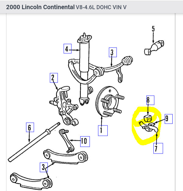

I looked underneath and everything looked okay. But I noticed some play in the sway bar (right, rear side) which is where I hear the clunking when I go over bumps. There was oil on the tire near it (again, right rear side).

As far as the stabilizer, I attached a pic below and highlighted what I believe you are referring to. Please confirm.
If that is the issue, make sure the sway bar isn't broken. If it isn't, that is a very inexpensive part to replace.

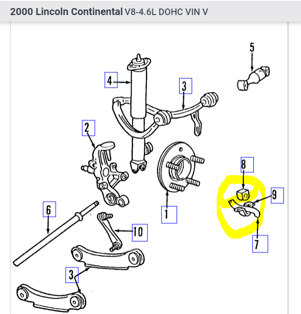

See pic below.
