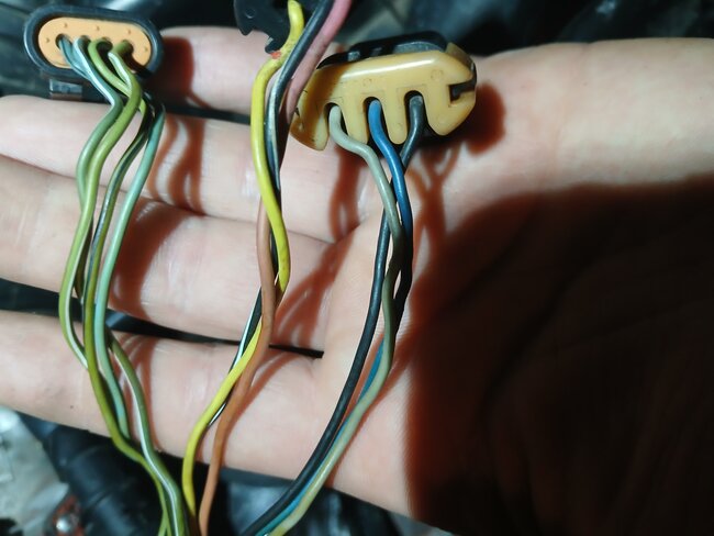

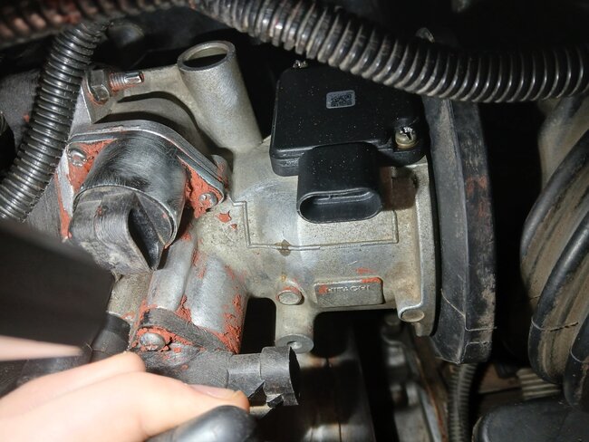

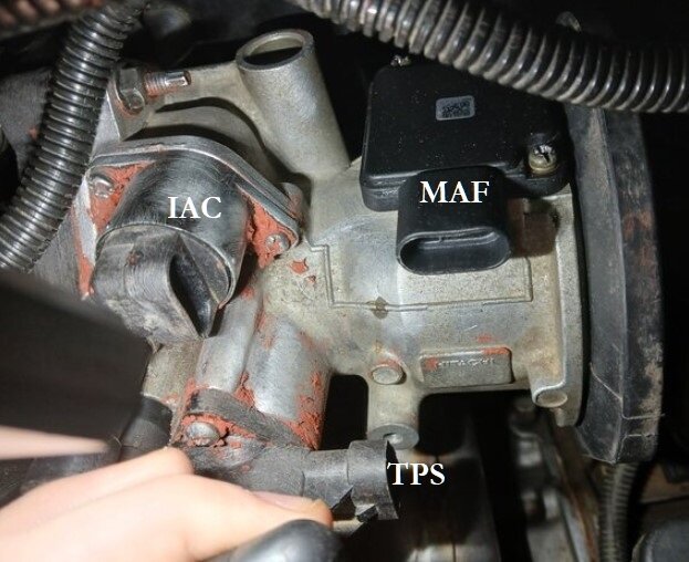

Can someone help tell me witch throttle body wire gets connected to the proper one?
1996 BUICK REGAL
150,000 MILES • 3.8L • 6 CYL • AUTOMATIC
REBIRTH98GH
  • 6 POSTS
3 connectors got disconnected on accident. Trying to make sure I plug them in the proper one. Please and thank you for the help.
Dec 6, 2025 at 4:32 AM
REBIRTH98GH
  • 6 POSTS
Picture below
Dec 6, 2025 at 8:46 AM

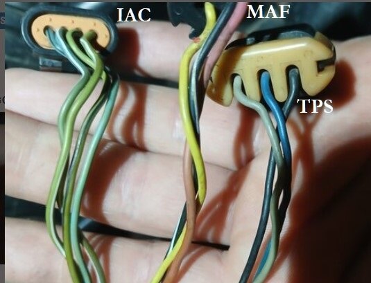

AL514
  • 5,587 POSTS
Hello, these plugs technically shouldnt be able to be plugged into the incorrect sensor in this case, since you're dealing with I can try to label them for you if that helps.
Dec 6, 2025 at 3:11 PM
AL514
  • 5,587 POSTS
Hopefully these come out ok.

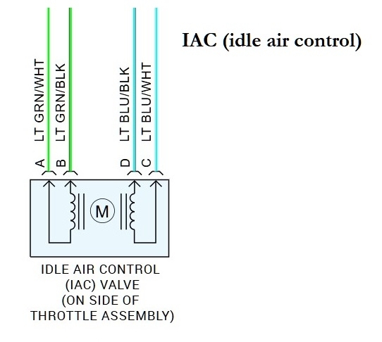

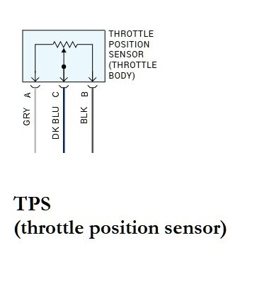

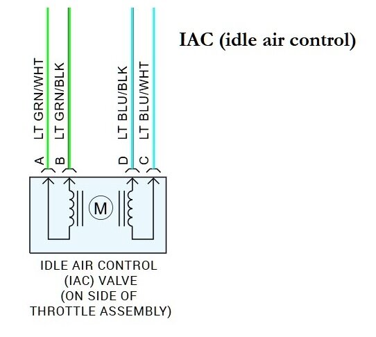

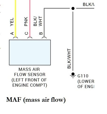

AL514
  • 5,587 POSTS
These are the wiring diagrams that show the wire colors for those 2 sensors and the IAC motor. But you shouldnt have any trouble getting these back in their correct places.
