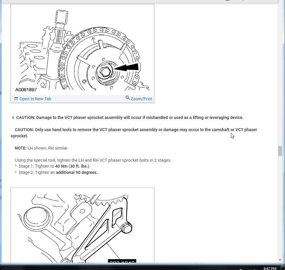

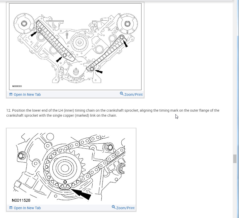

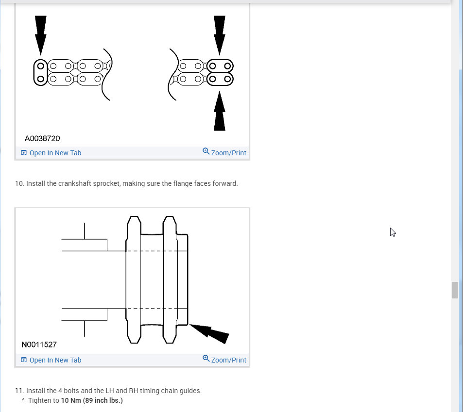

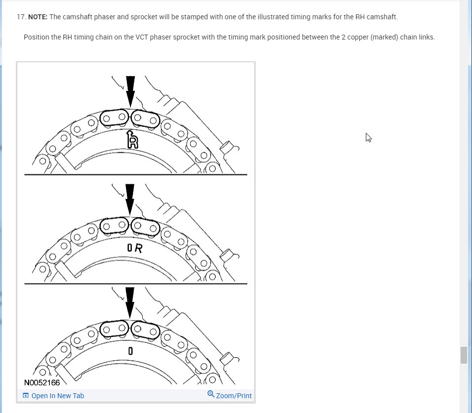

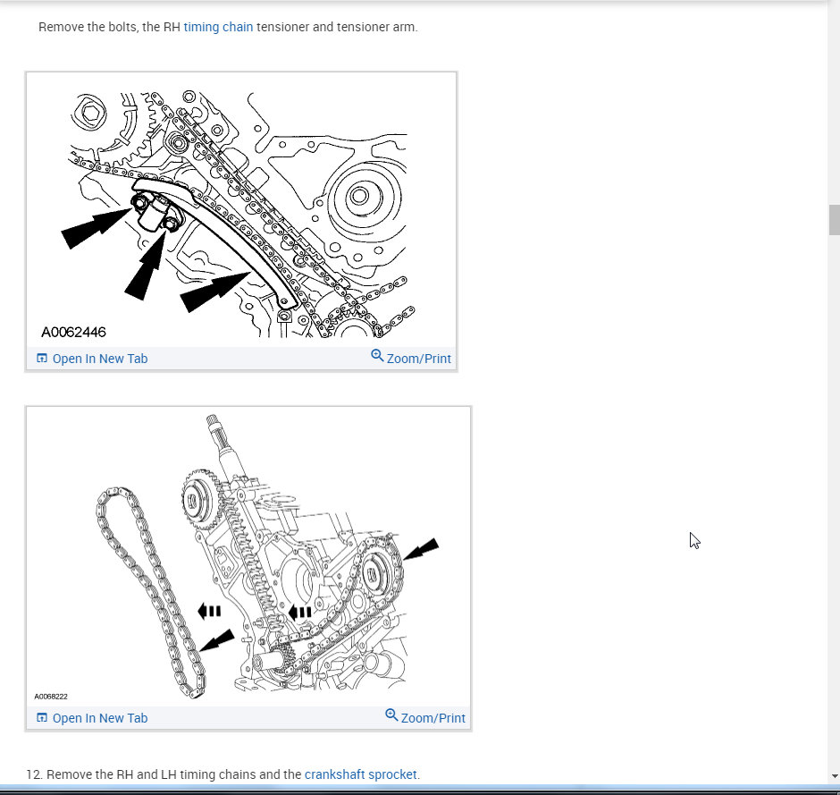

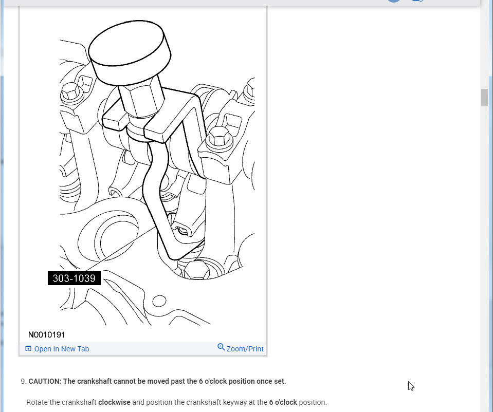

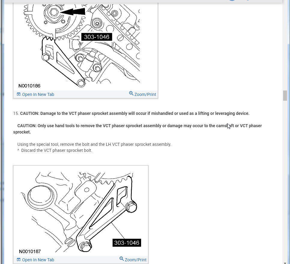

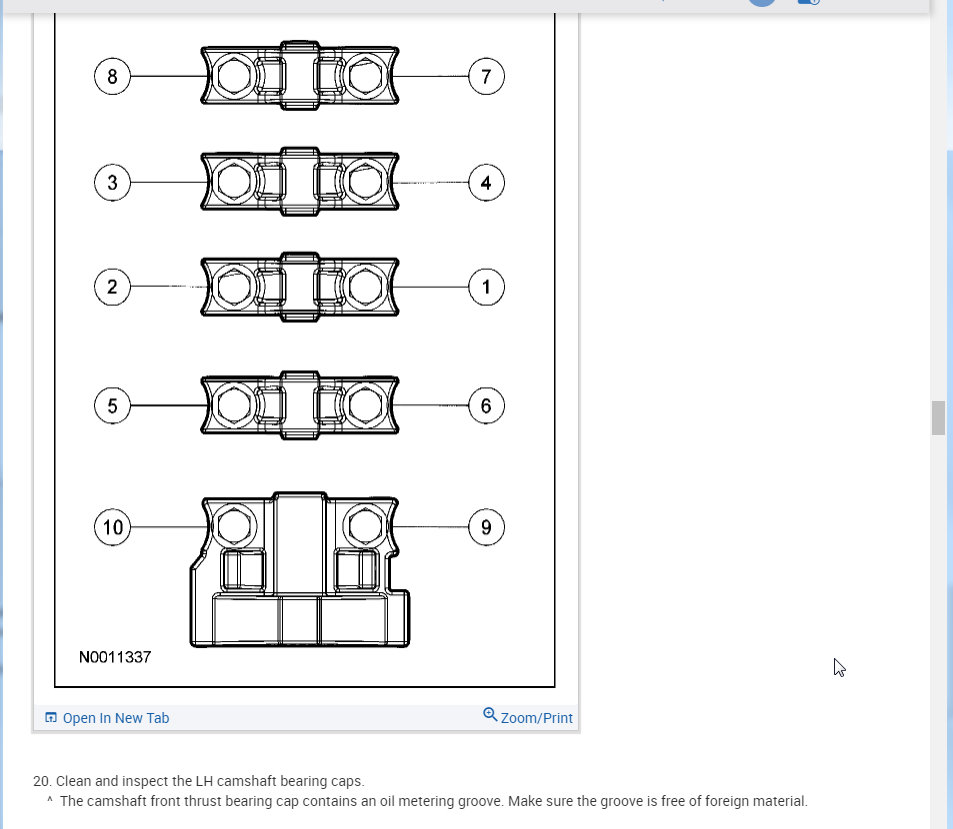

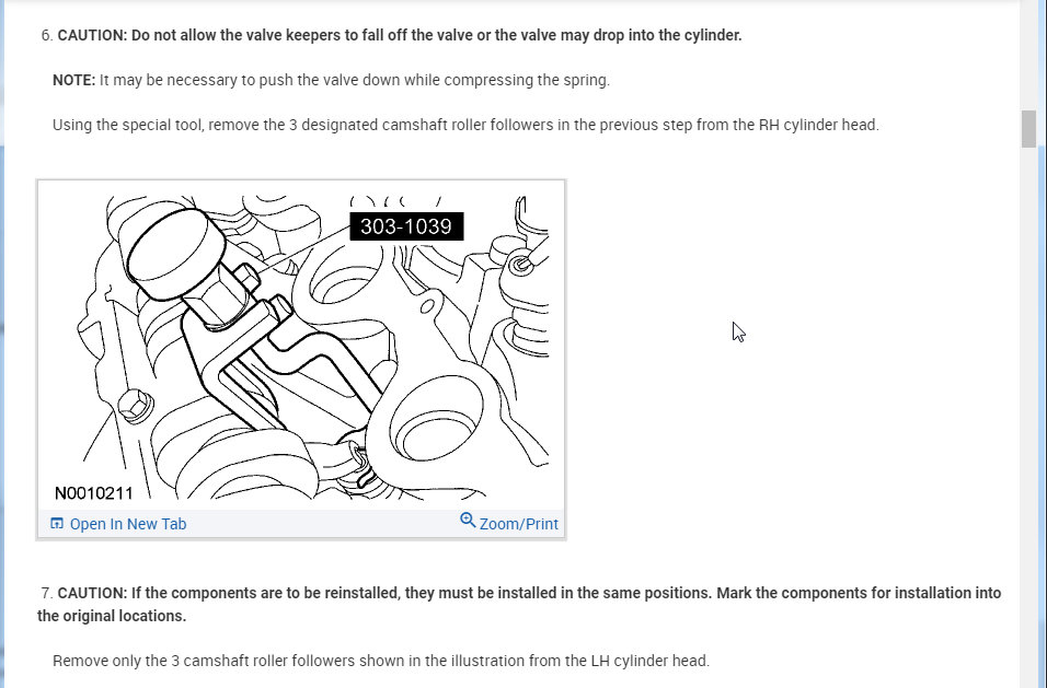

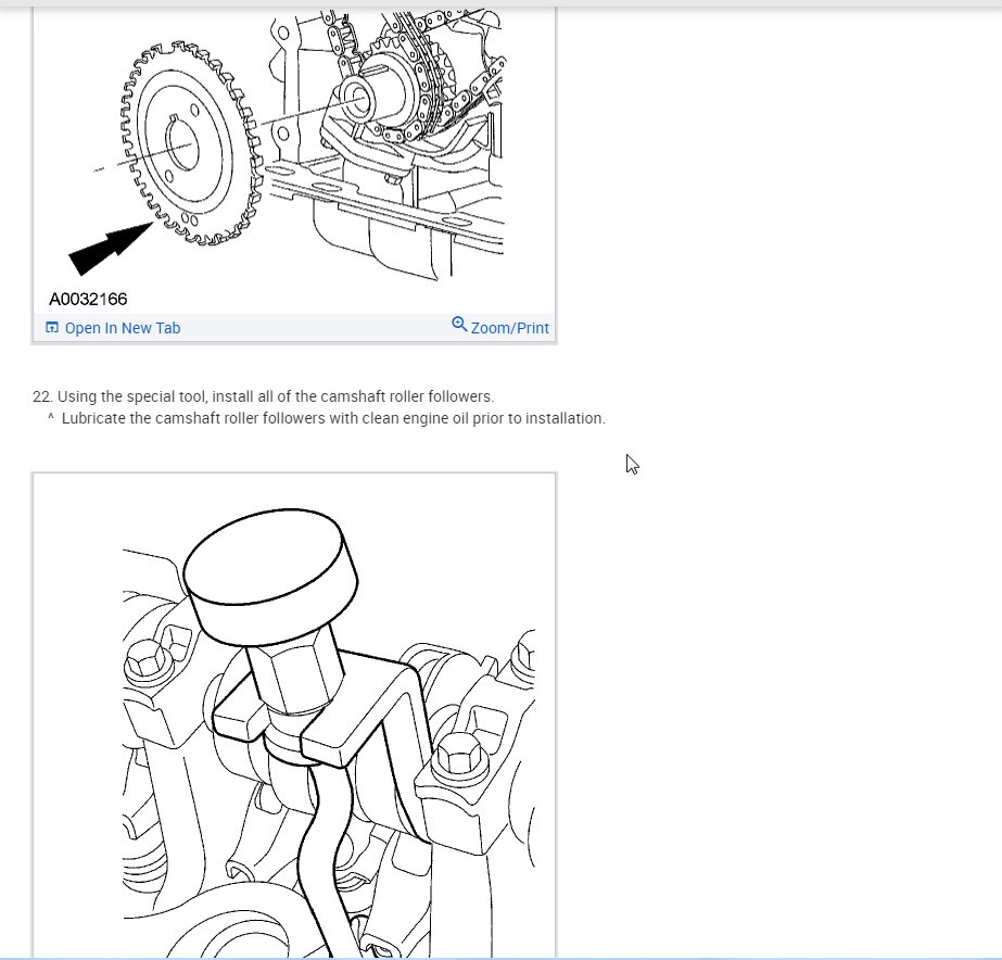

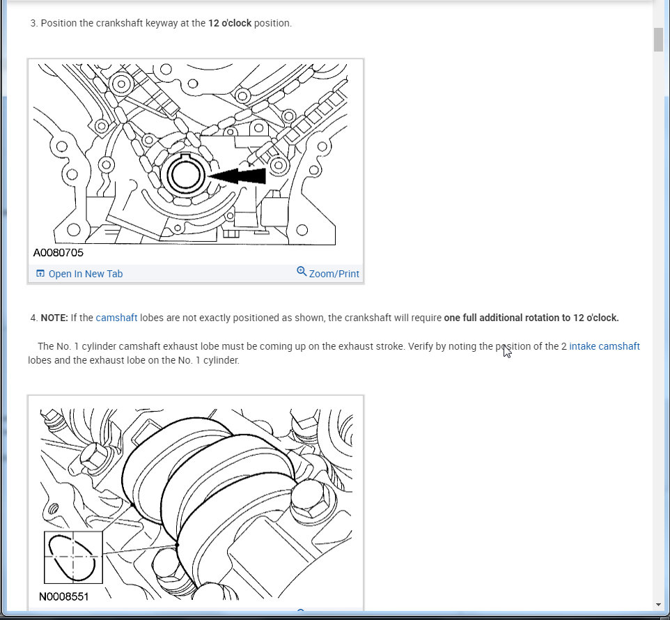

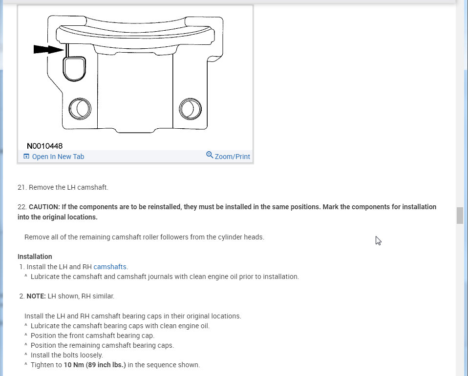

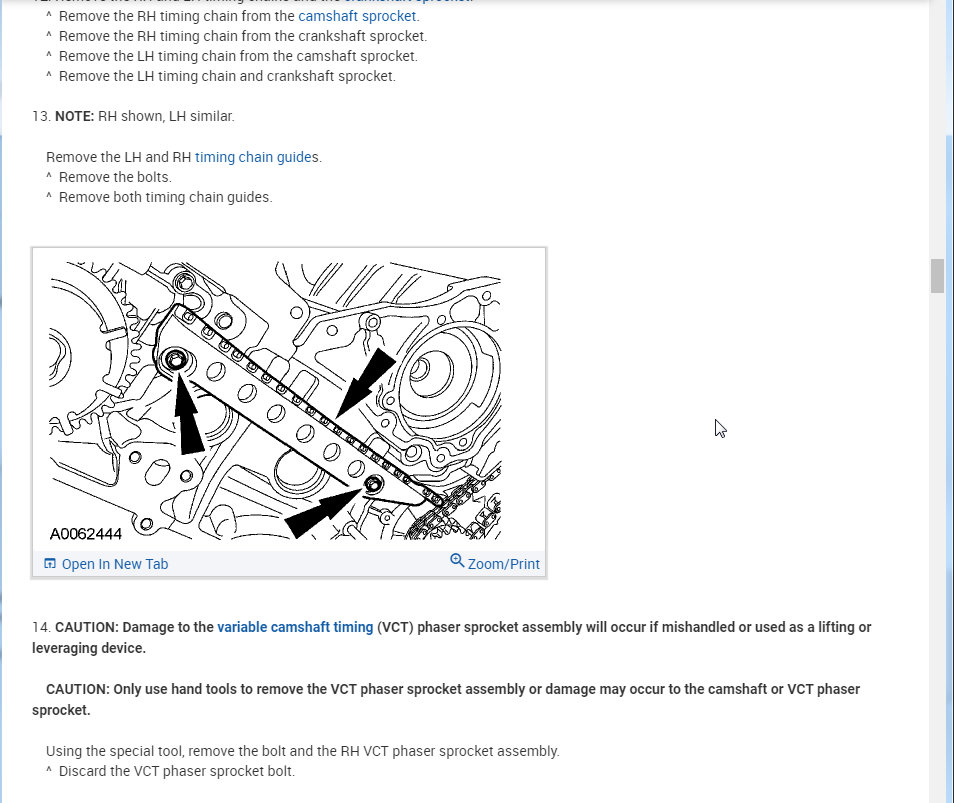

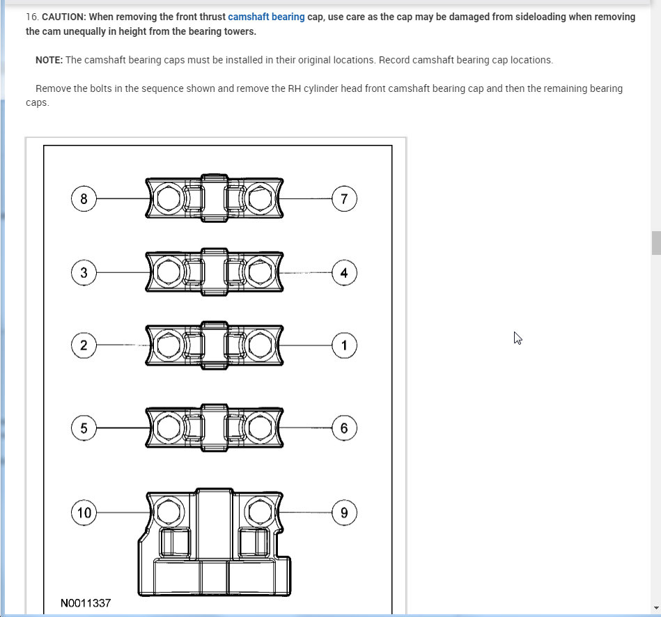

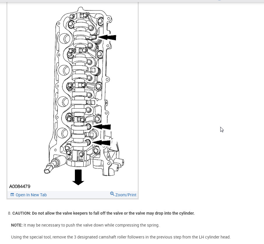

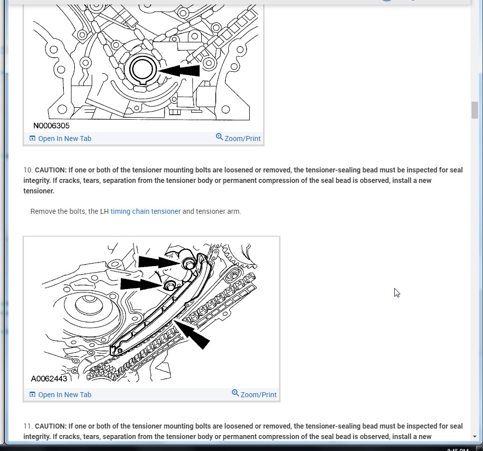

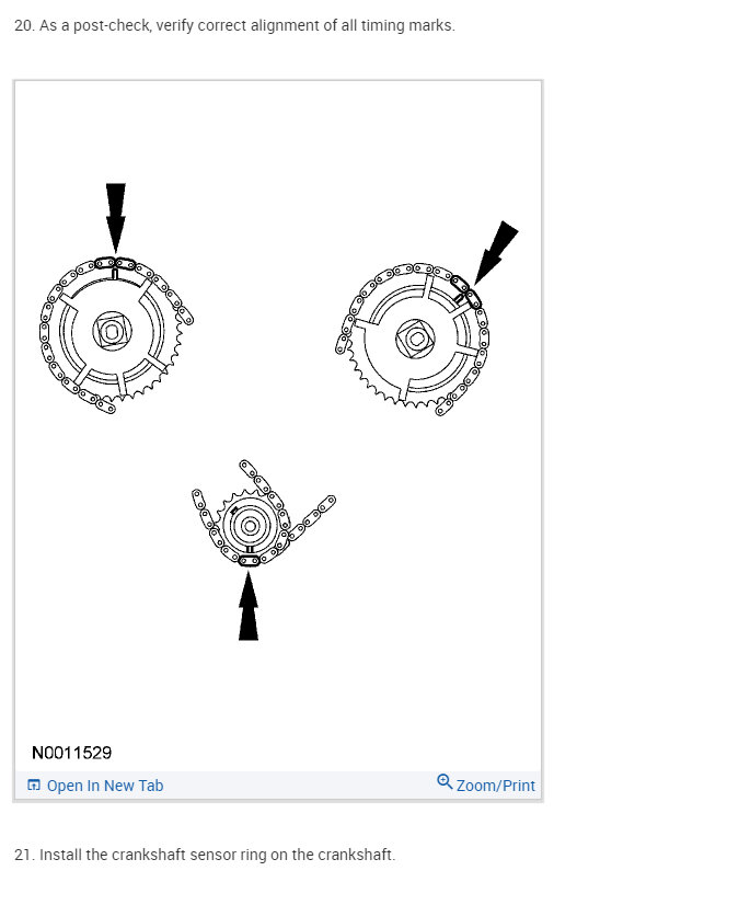

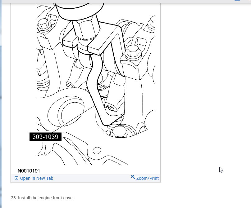

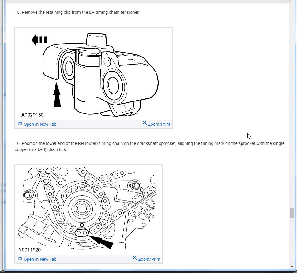

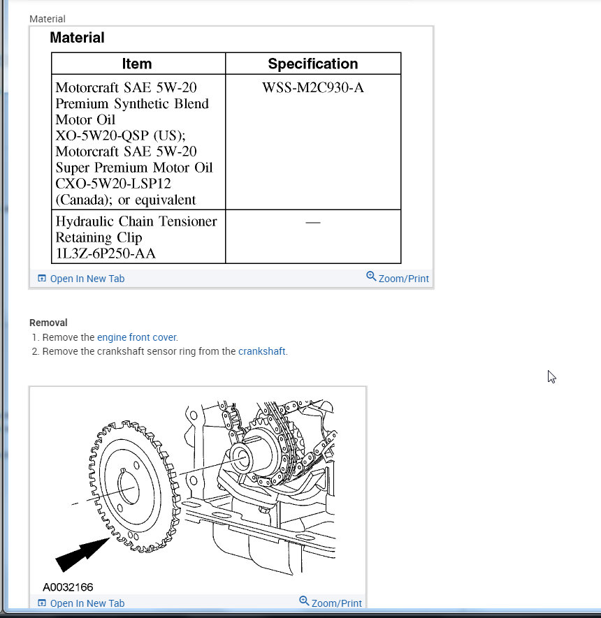

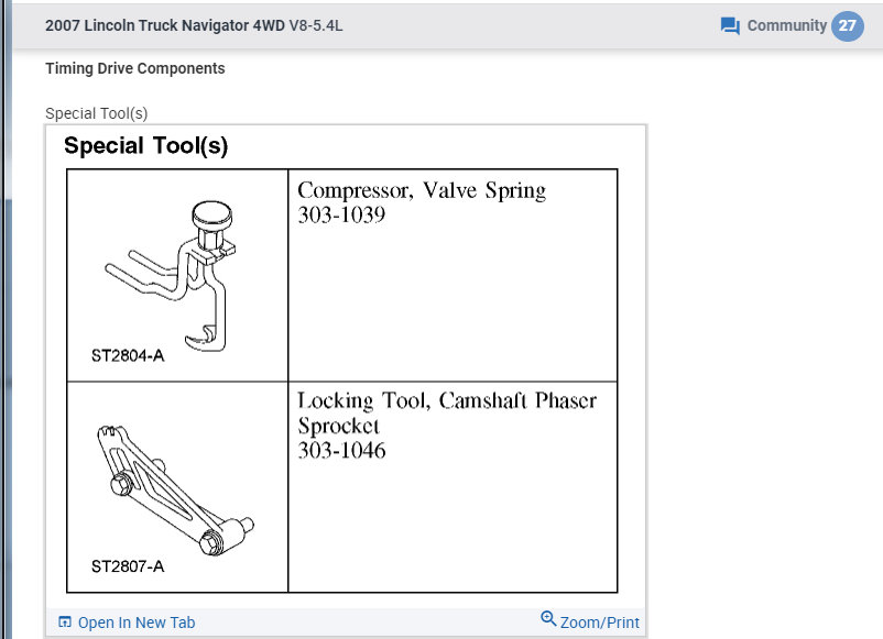

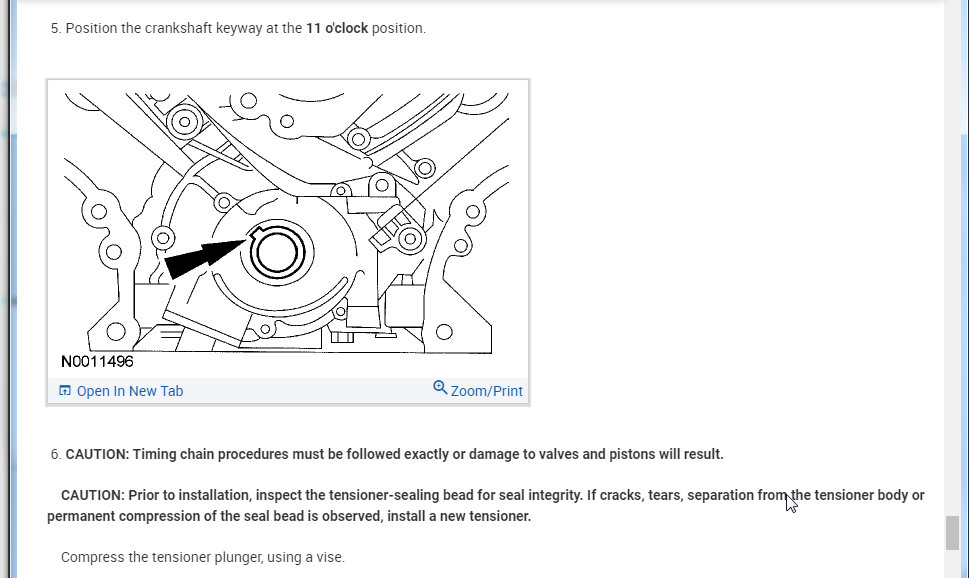

That sounds just like a timing chain rattle. Which means the tensioner is most likely weak. So when you start the engine it rattles and then the slack is taken out.

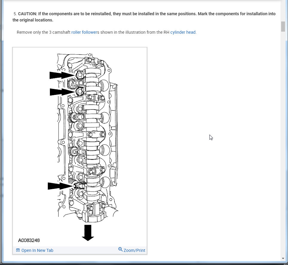

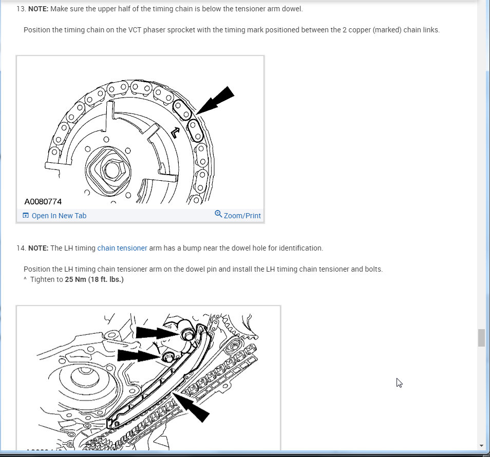

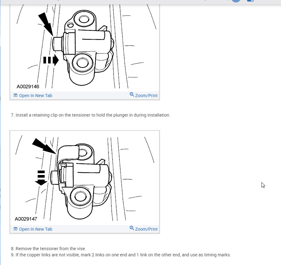

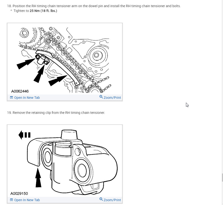

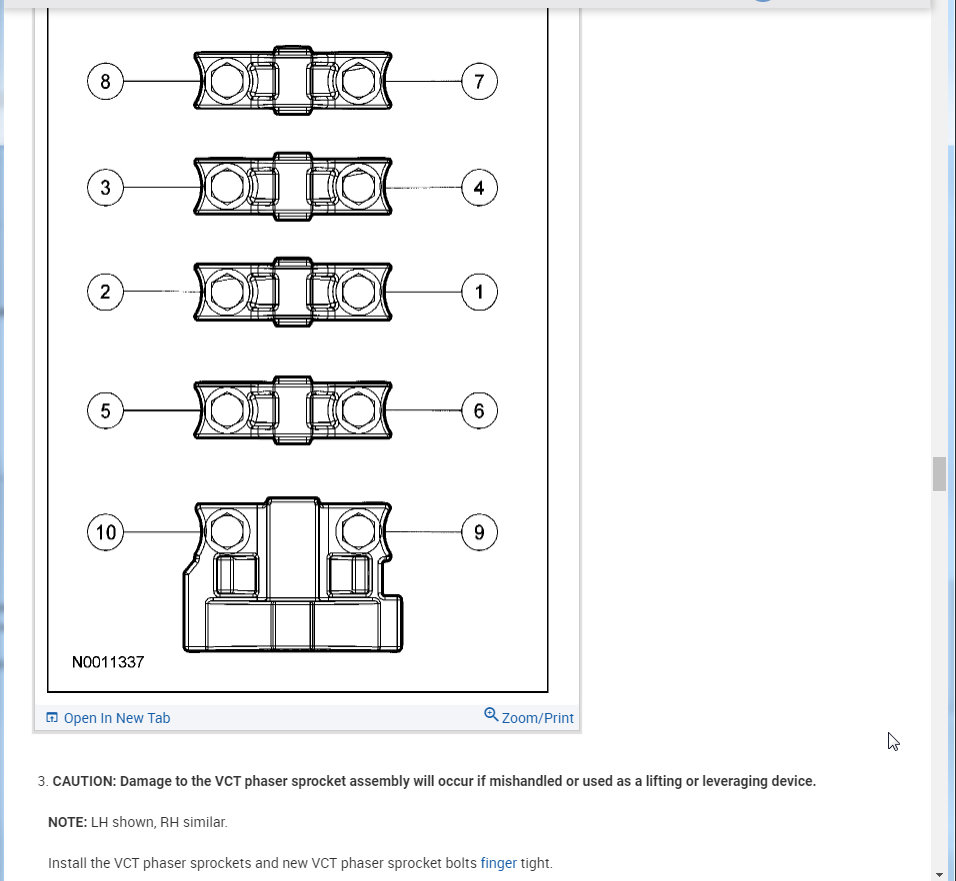

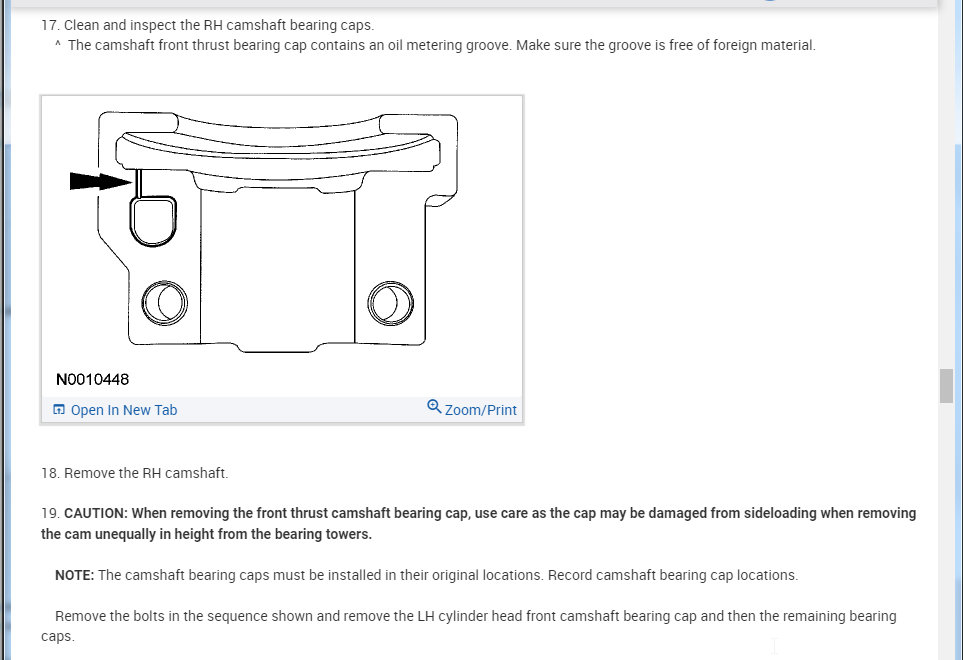

I attached the process for replacement so you can review it. It is very extensive so I wanted you to see it before proceeding.
Take a look at this and we can go from there. Thanks
