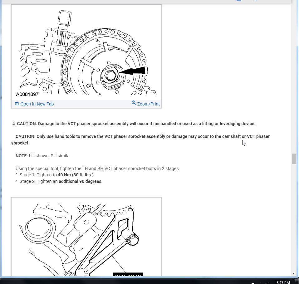

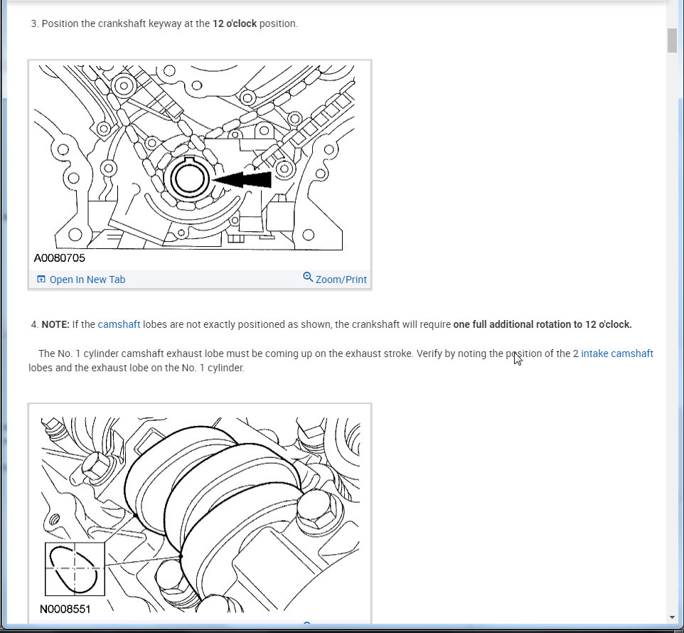

This video explains my problem. I've done research and found where people say it is the timing tensioner and timing gaskets?
On cold starts only it will do this knocking? for a second or two then runs perfectly fine until next cold start. It has a mild oil pan gasket leak but I make sure to keep oil in it. Does anyone have and ideas?
Jul 29, 2020 at 2:23 PM

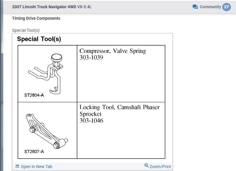

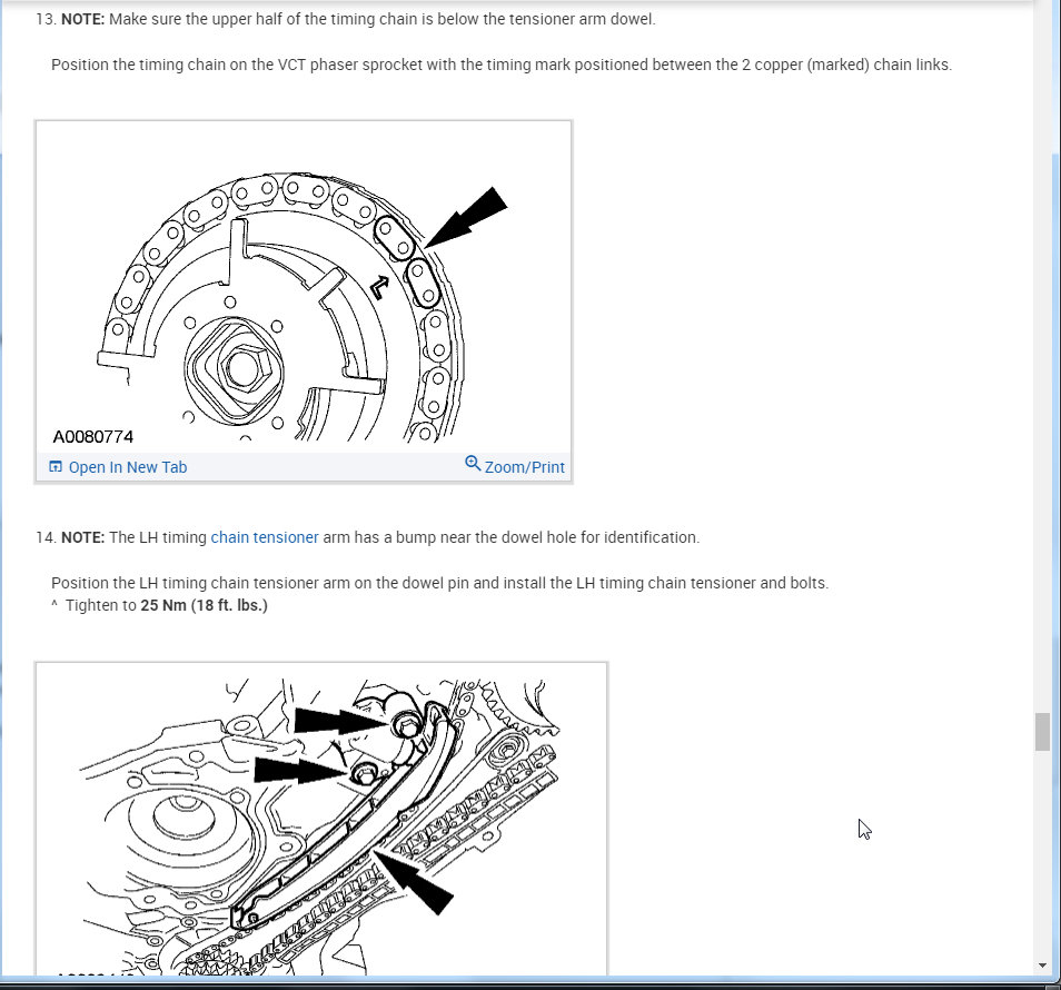

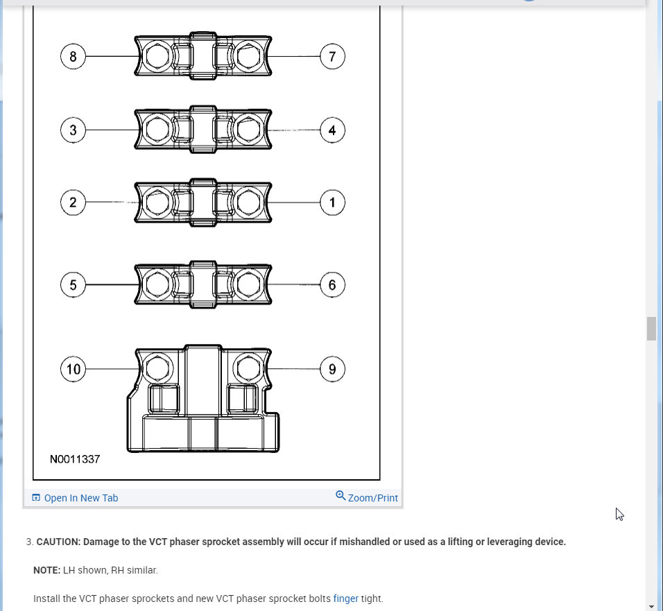

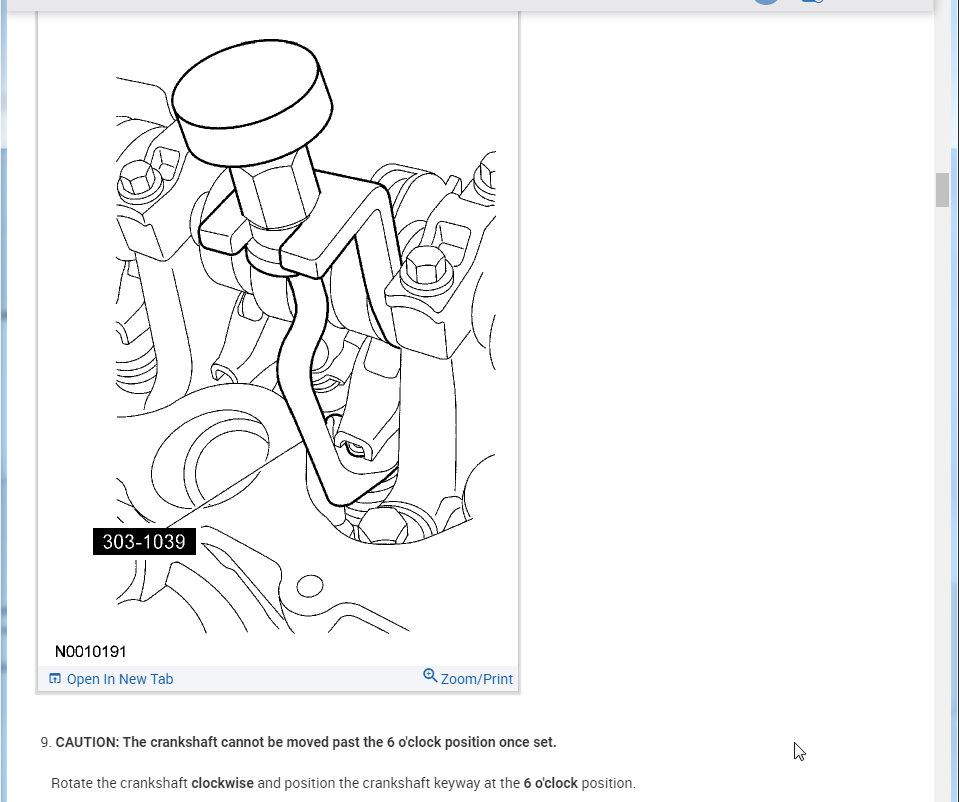

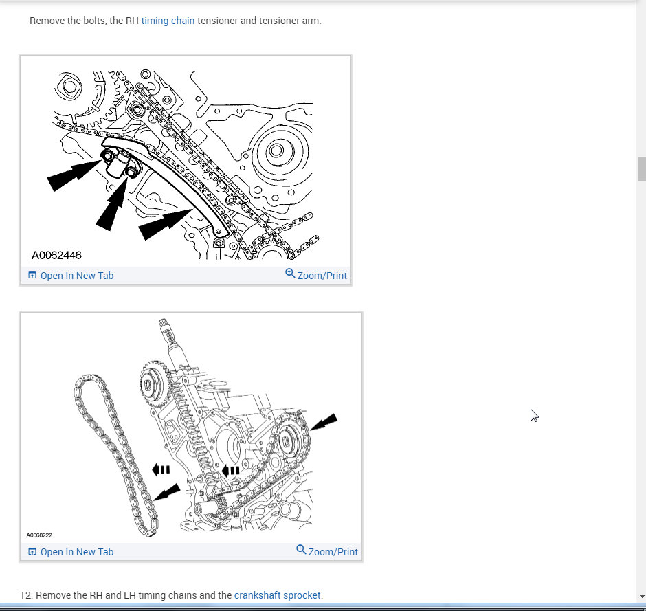

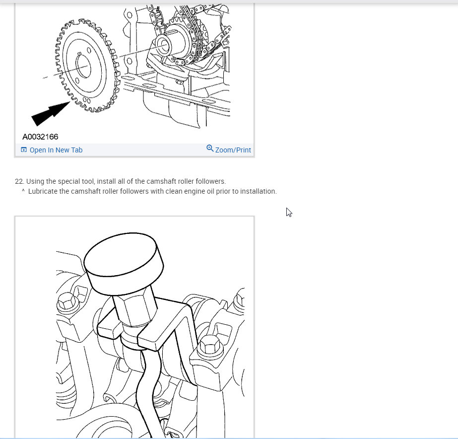

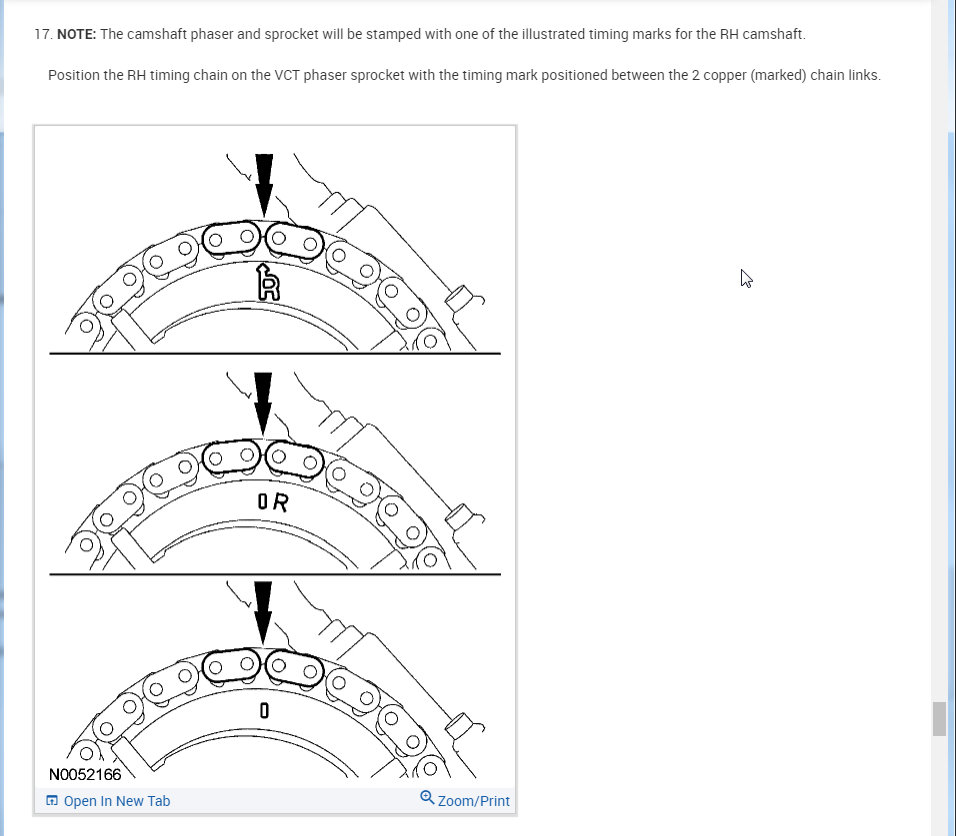

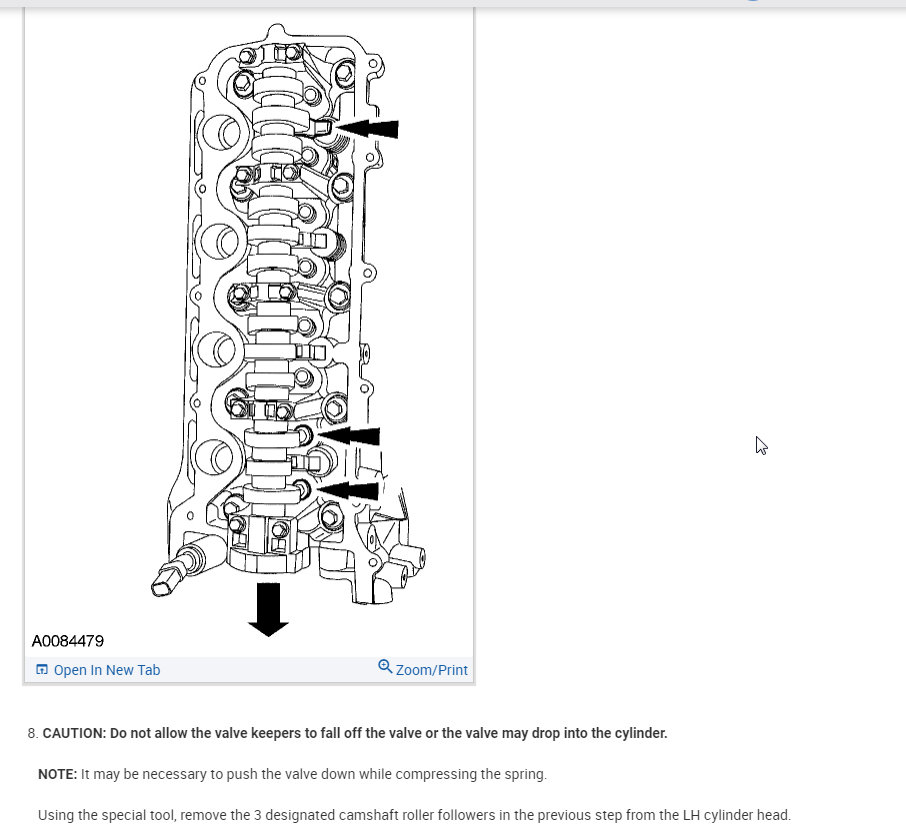

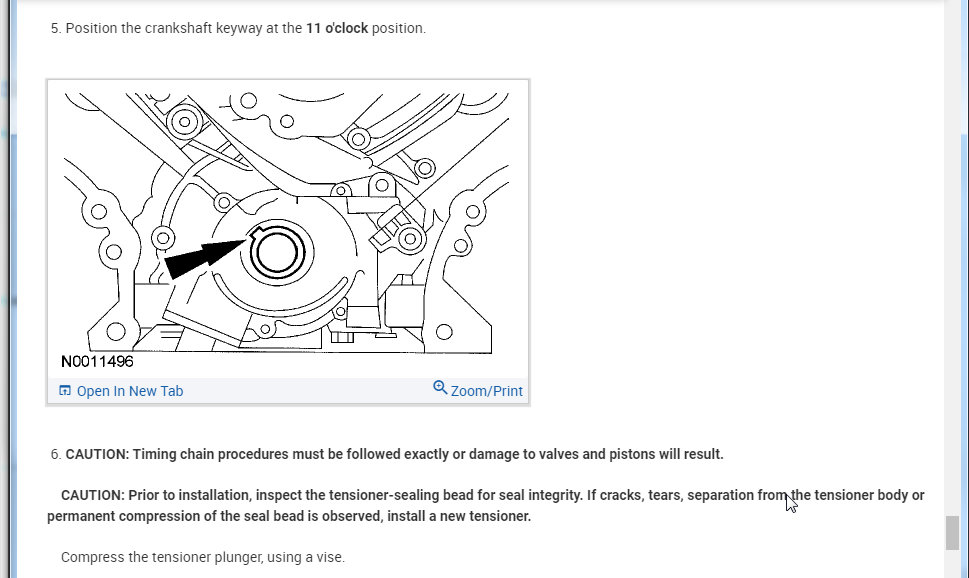

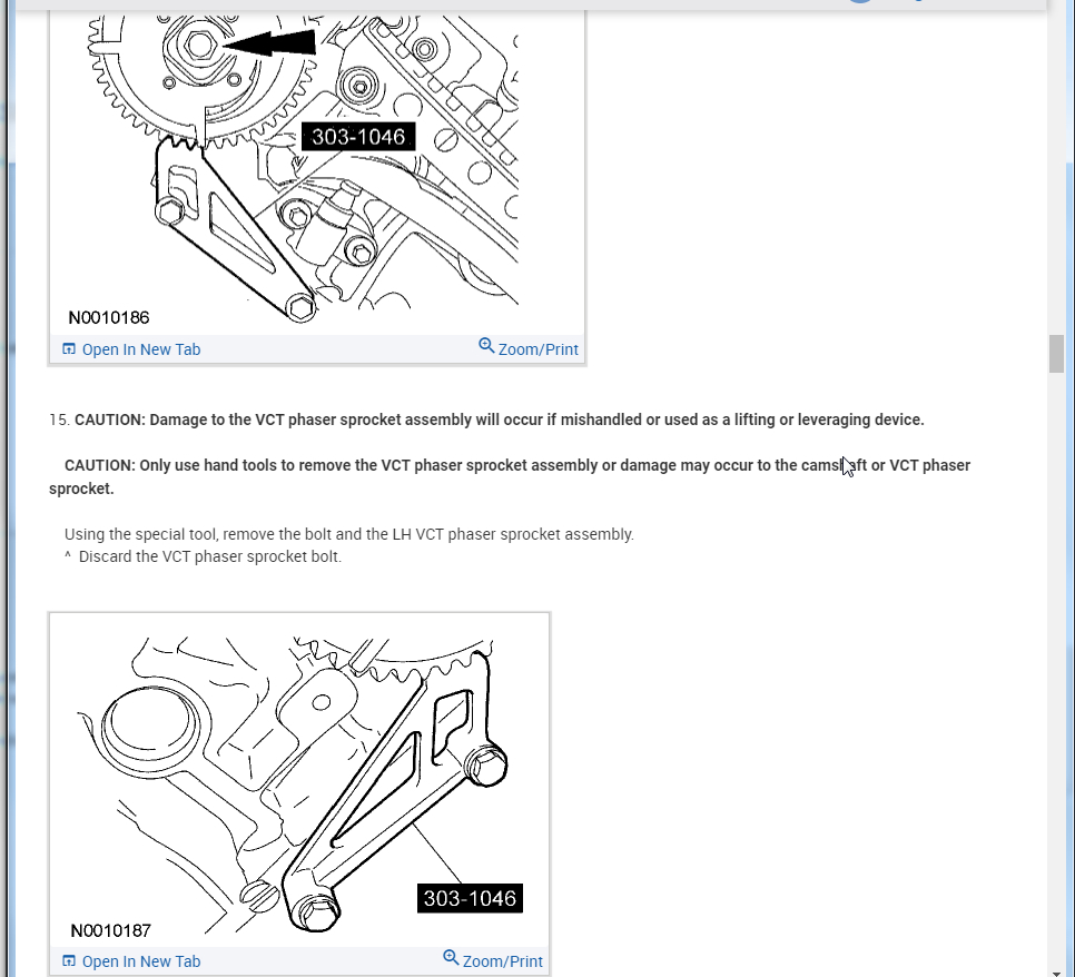

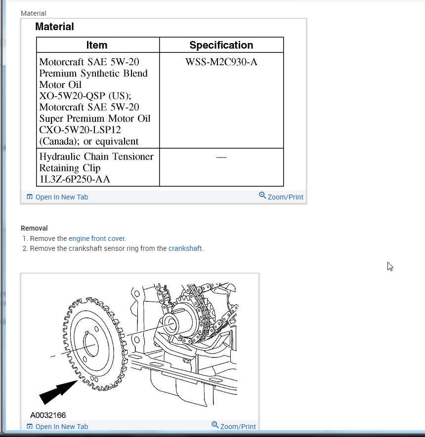

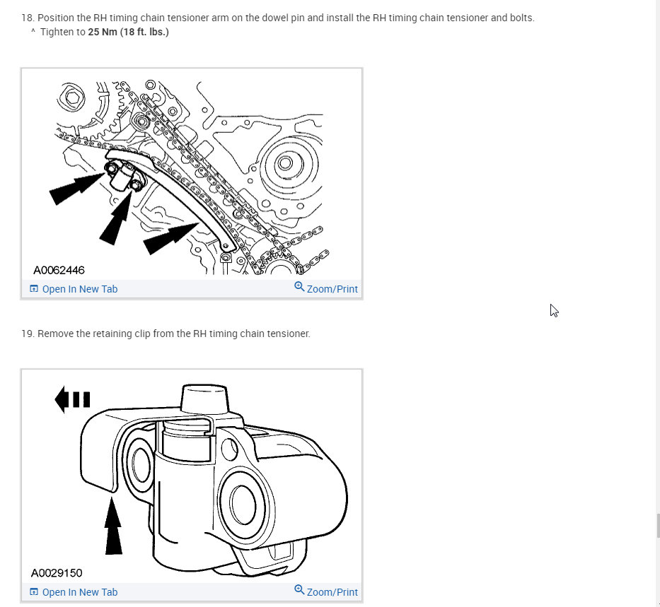

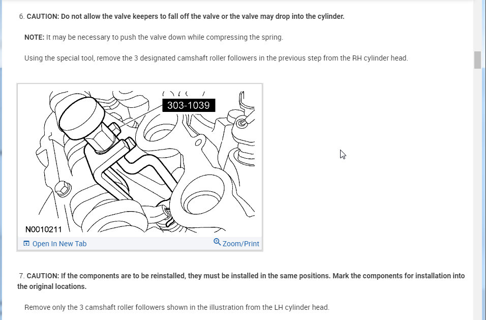

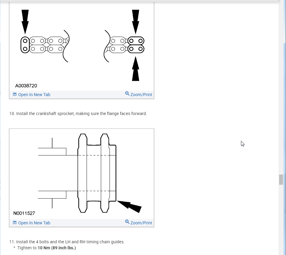

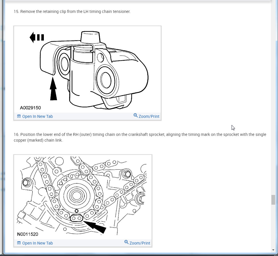

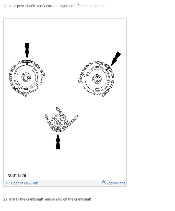

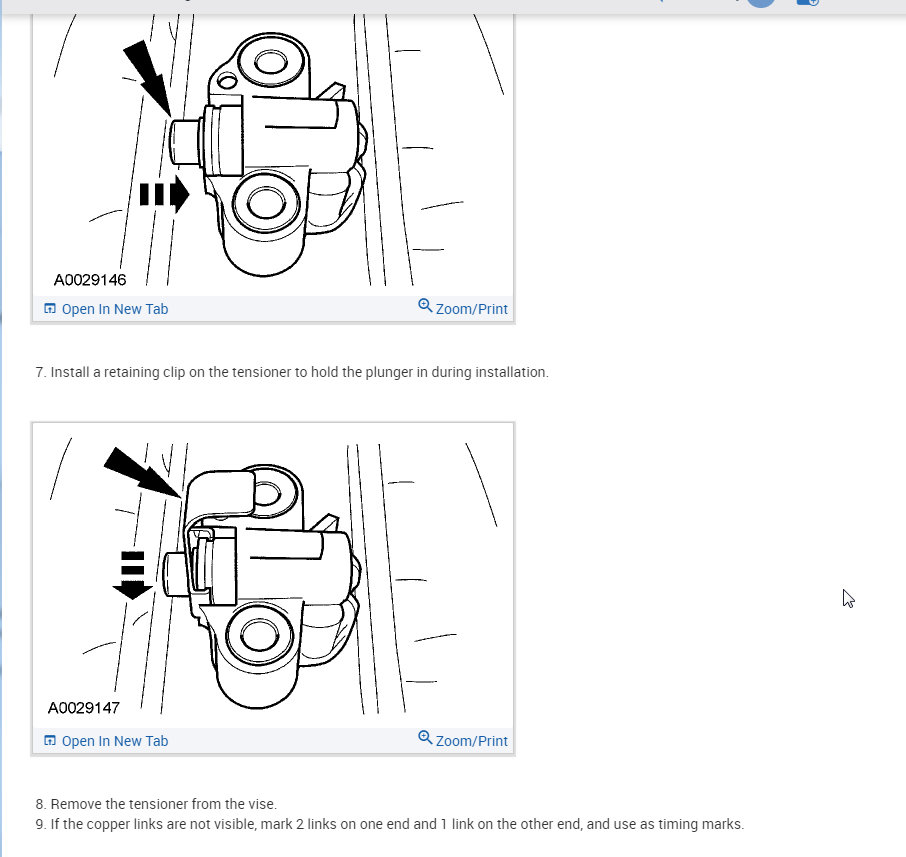

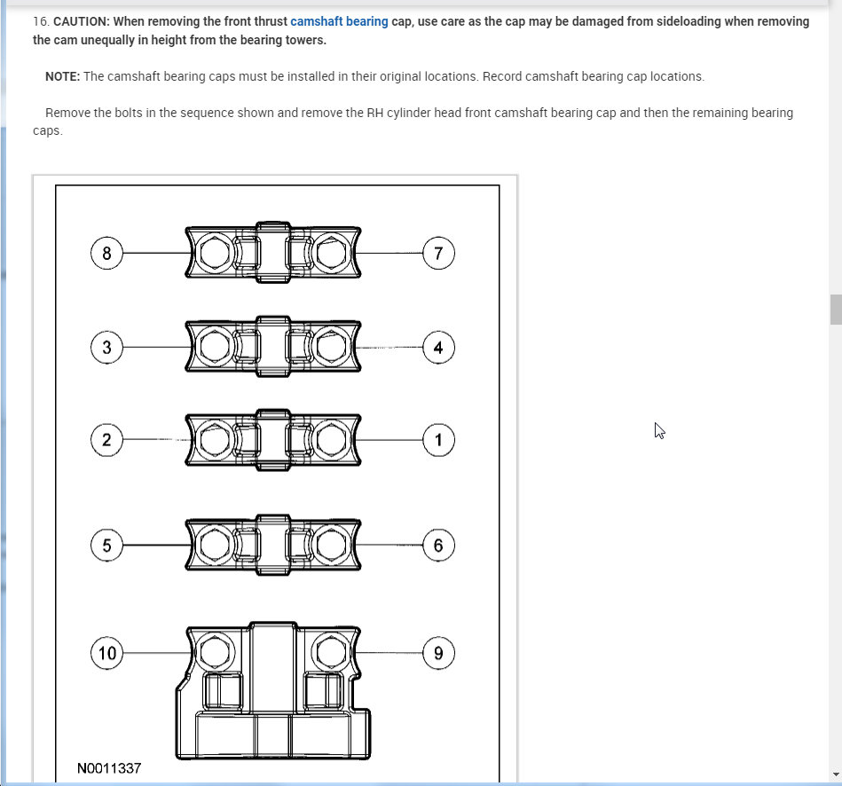

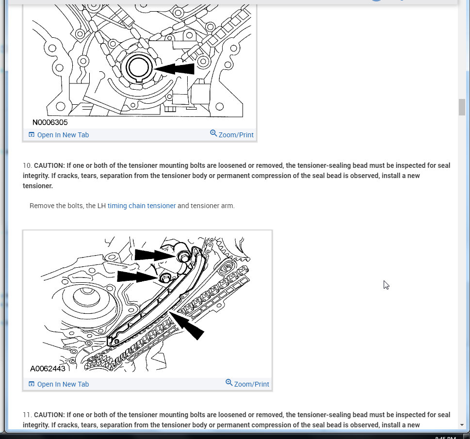

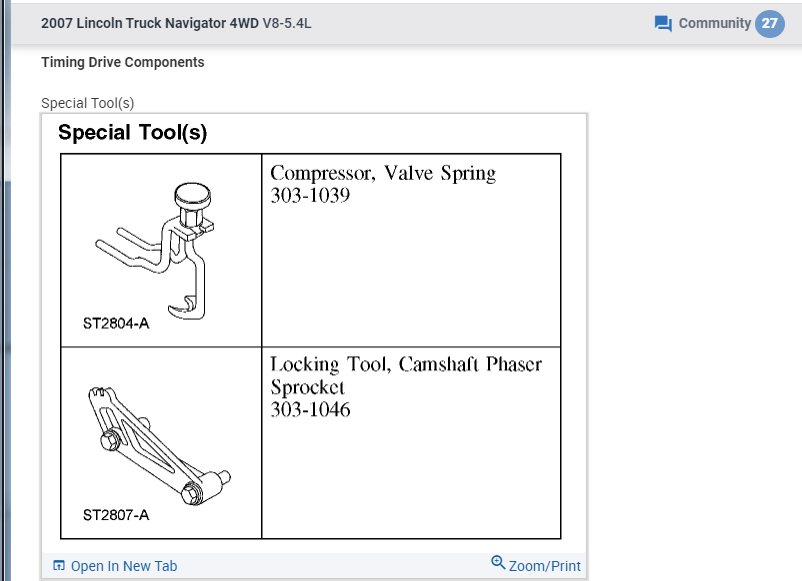

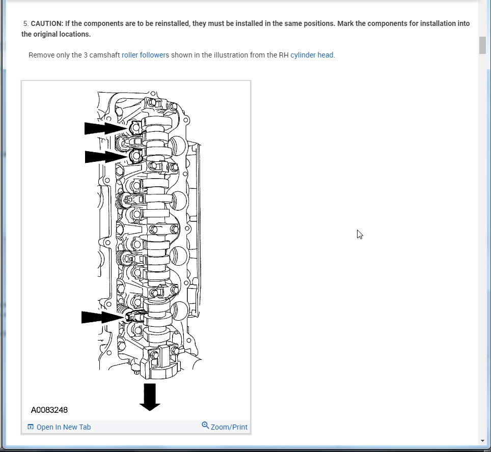

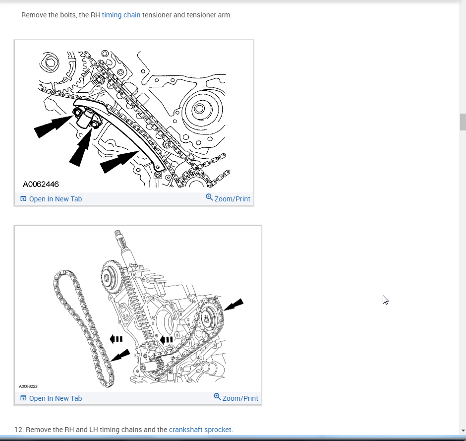

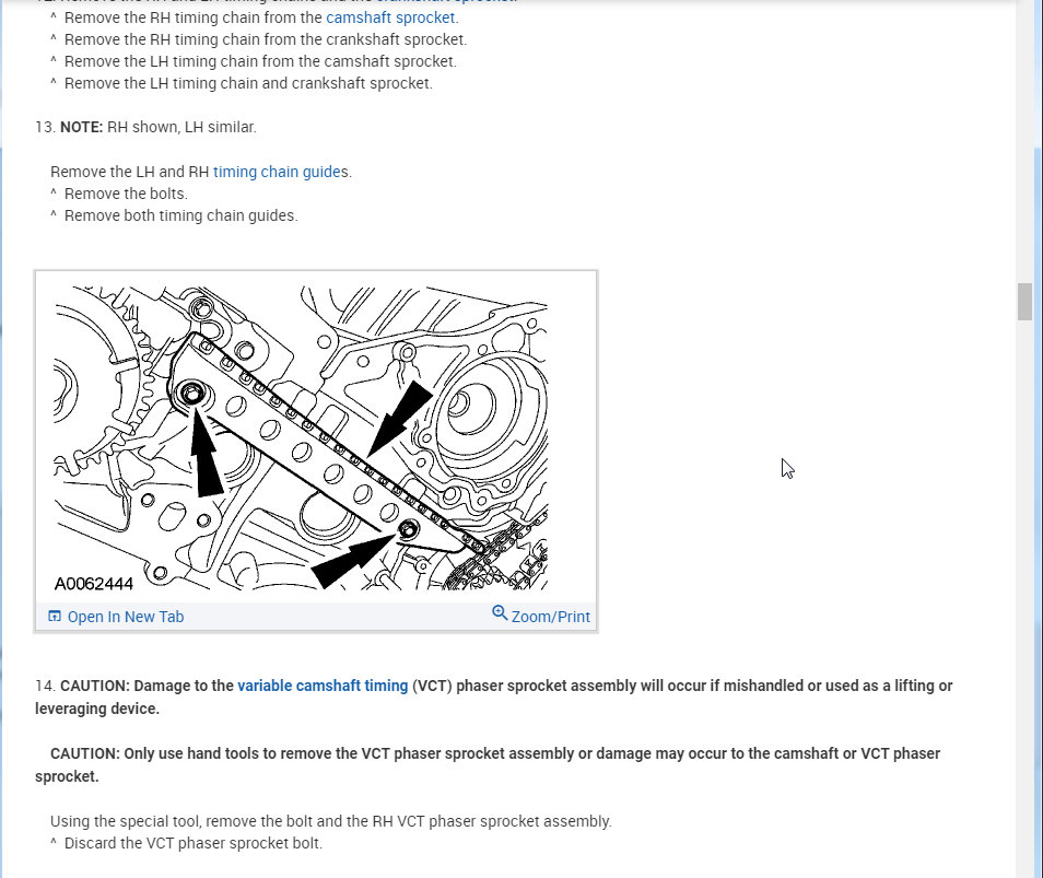

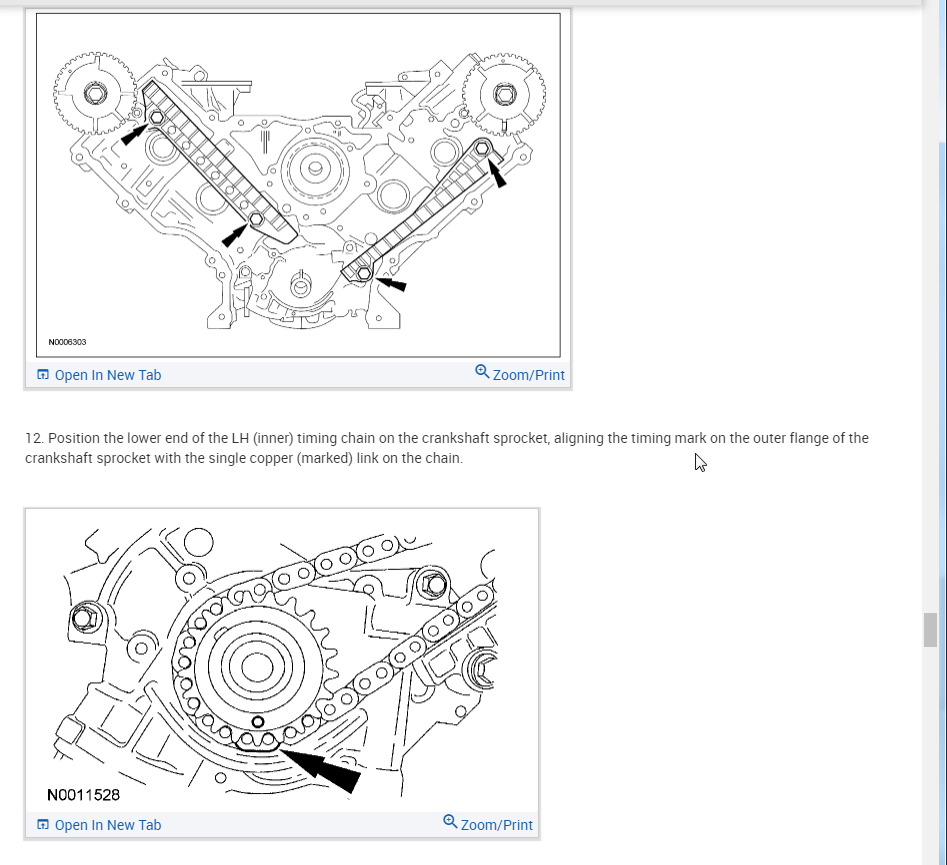

That sounds just like a timing chain rattle. Which means the tensioner is most likely weak. So when you start the engine it rattles and then the slack is taken out.

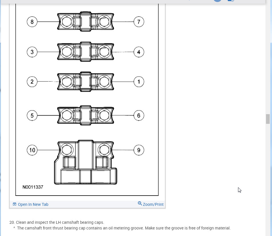

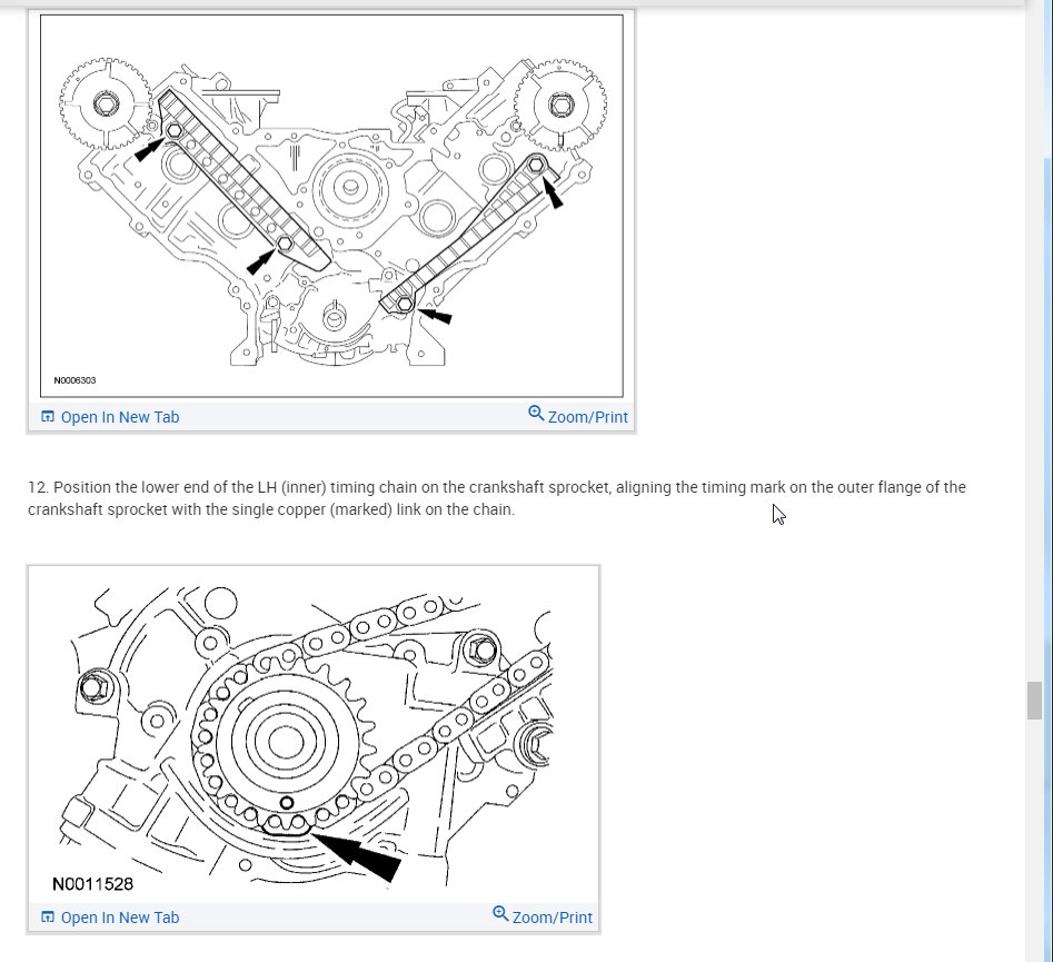

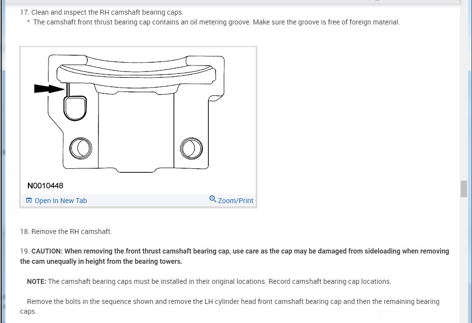

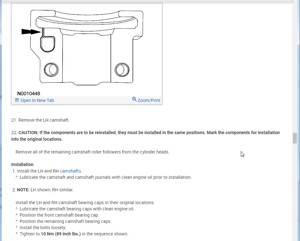

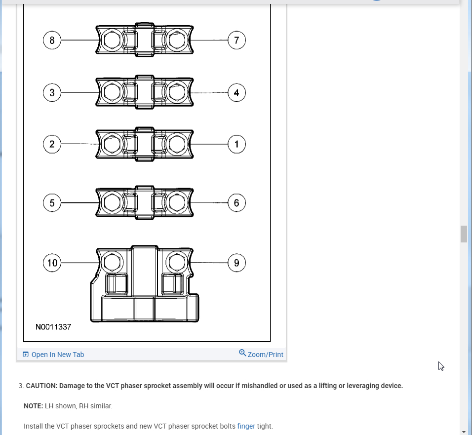

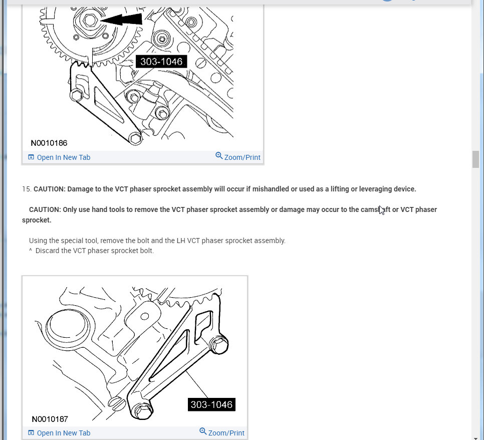

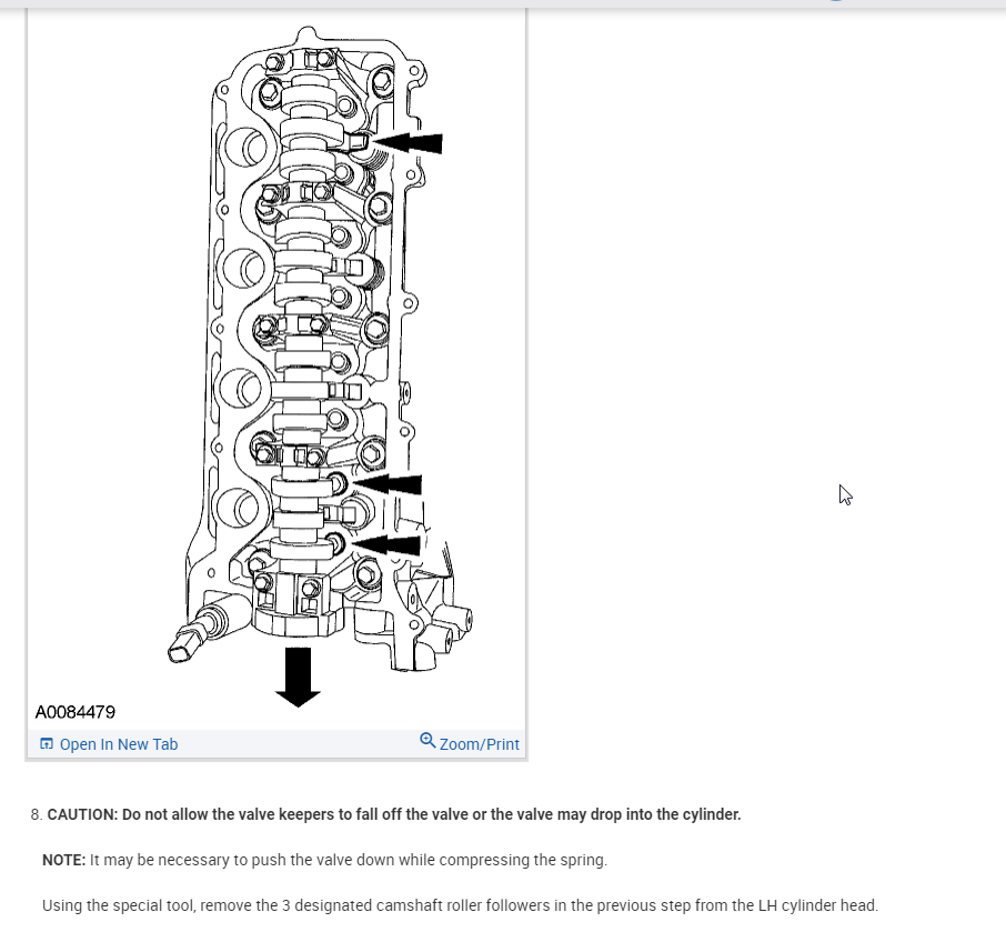

I attached the process for replacement so you can review it. It is very extensive so I wanted you to see it before proceeding.
Take a look at this and we can go from there. Thanks
