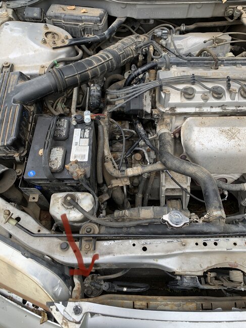

Can someone tell me what this car part is called?
2002 HONDA ACCORD
250,000 MILES • 4 CYL • 2WD • AUTOMATIC
AVID LEARNER
  • 13 POSTS
A piece of metal pipe that was connected to something that looked like a mini gas water heater broke off. The thing that looks like a mini water heater is in front of the car and the metal tube that broke off connects to it by going under the coolant reservoir tank. I posted a video and a picture of where it is so can someone tell me what the thing that looks like a mini water heater is called and can I drive it even though the metal pipe broke? thanks.

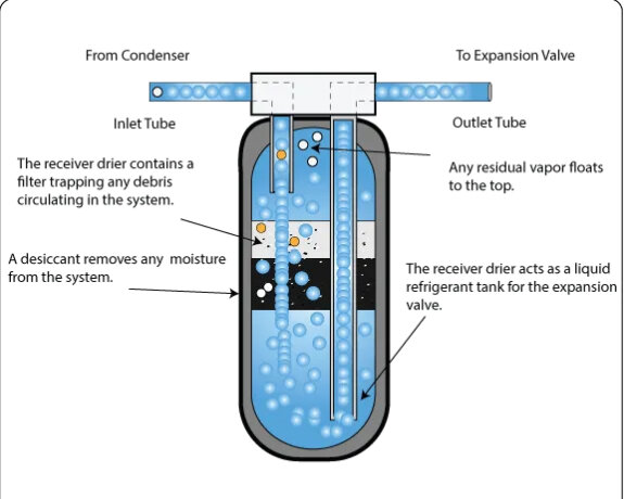

The little water heater looking thing is called a Receiver/Dryer. It is used for vehicles that have a Thermal Expansion Valve as part of their A/C System. It is responsible for separating gas from liquid since the A/C Compressor would be destroyed if liquid gets in. It also removes moisture using desiccant. It is similar to an Accumulator. The Receiver/Dryer is located on the high-side of the system and the Accumulator is on the low-side of the system. A vehicles A/C system will have either one or the other depending on its design.
Most companies make you replace this part when you buy a new A/C Compressor otherwise they won't warranty the new part.
Here is a good article explaining the 5 major parts of your A/C system:
