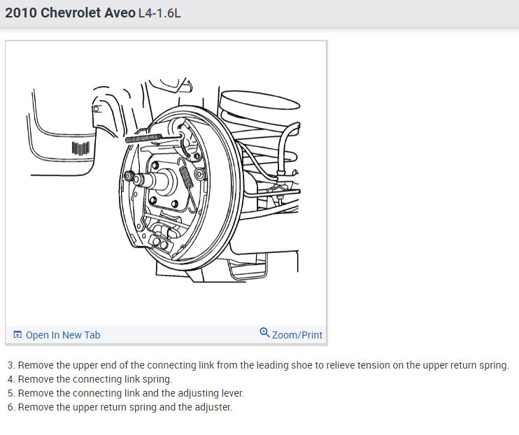

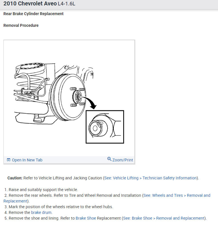

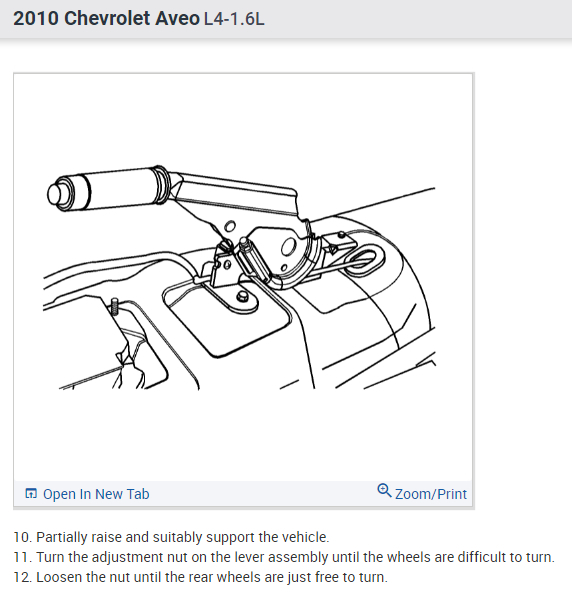

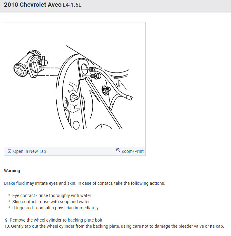

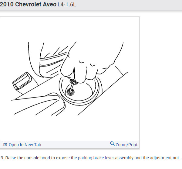

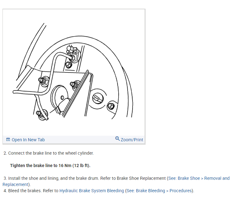

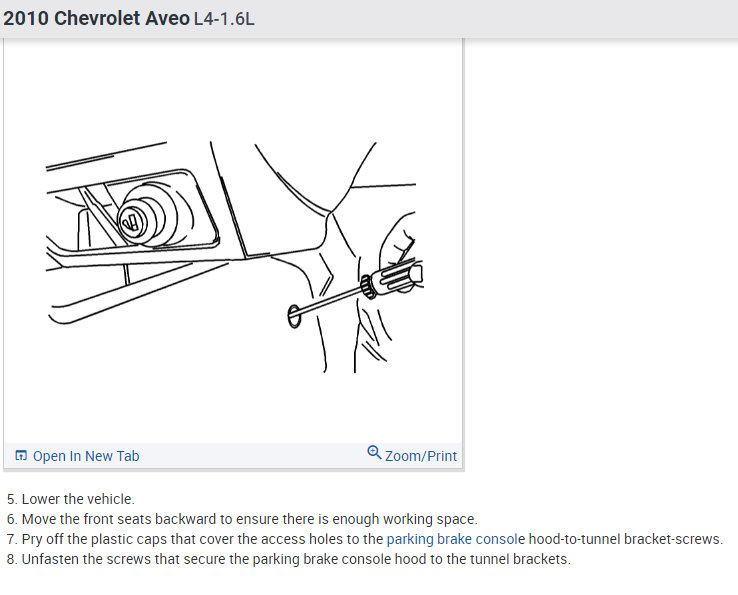

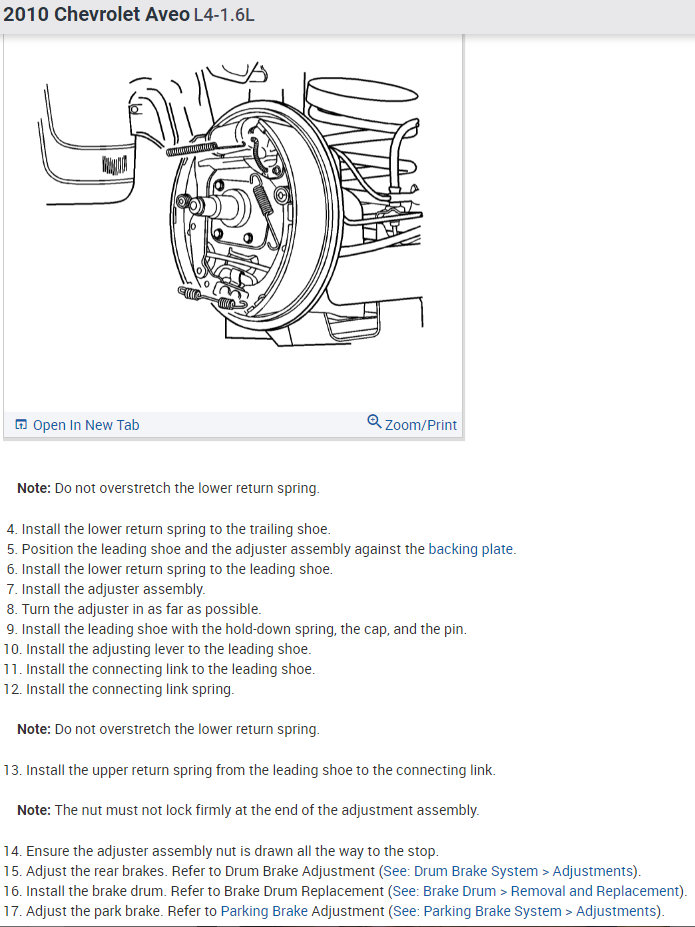

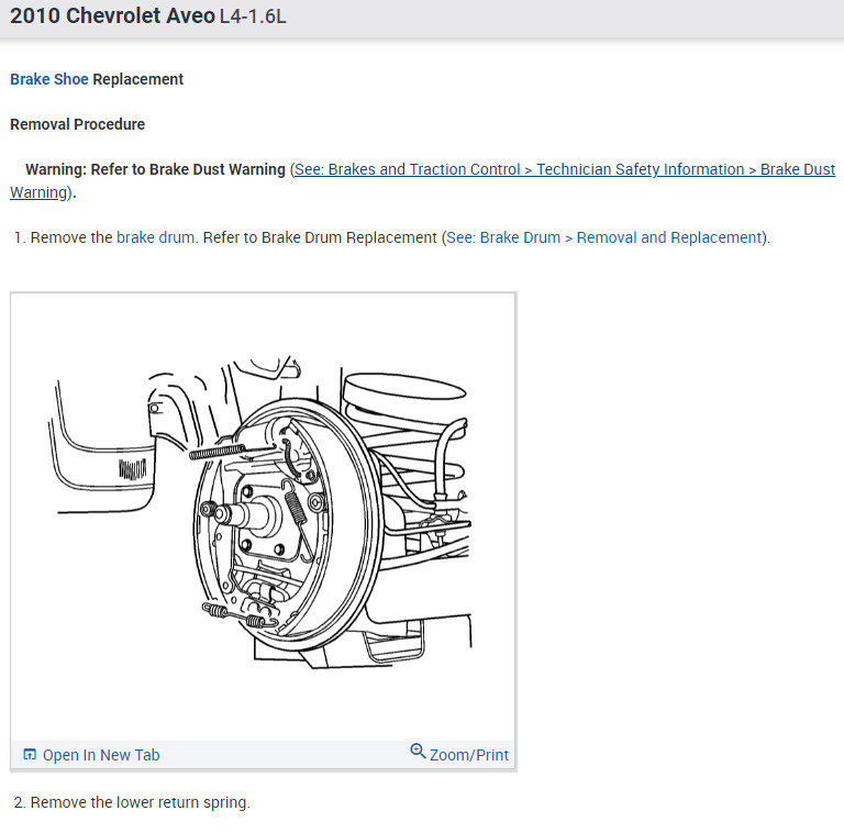

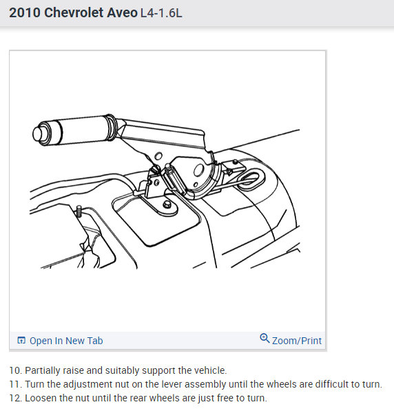

It has been a long time since I worked on a drum brake system. To refresh my memory, do you have factory information on how to replace brake shoes step by step? I would appreciate it. Thanks
Jul 31, 2021 at 5:41 AM
SQM
  • 6,383 POSTS

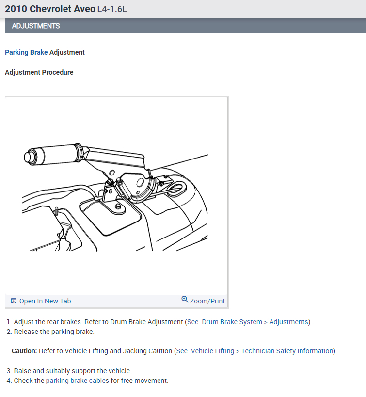

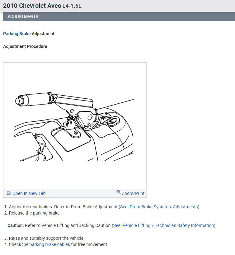

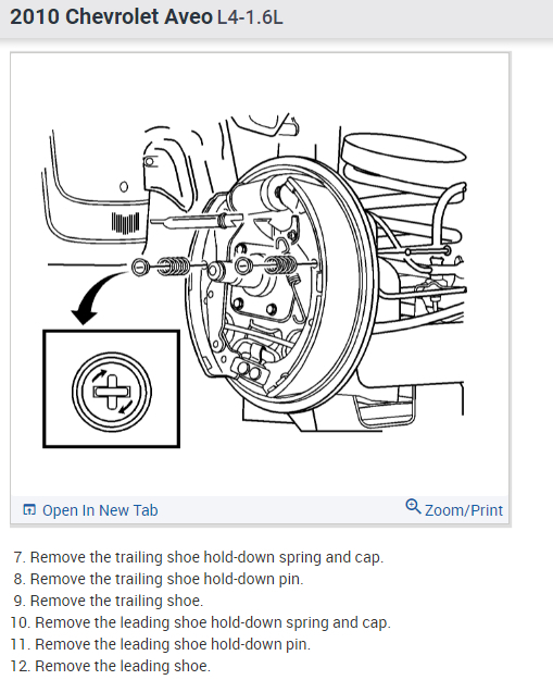

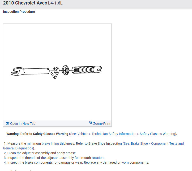

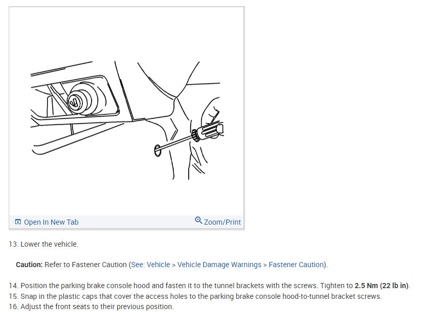

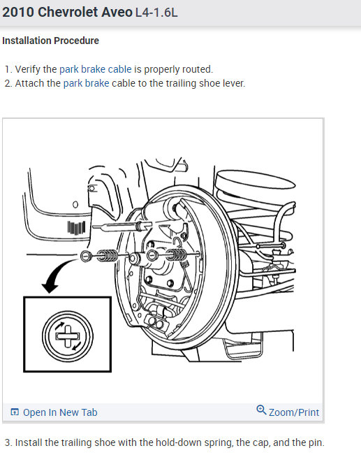

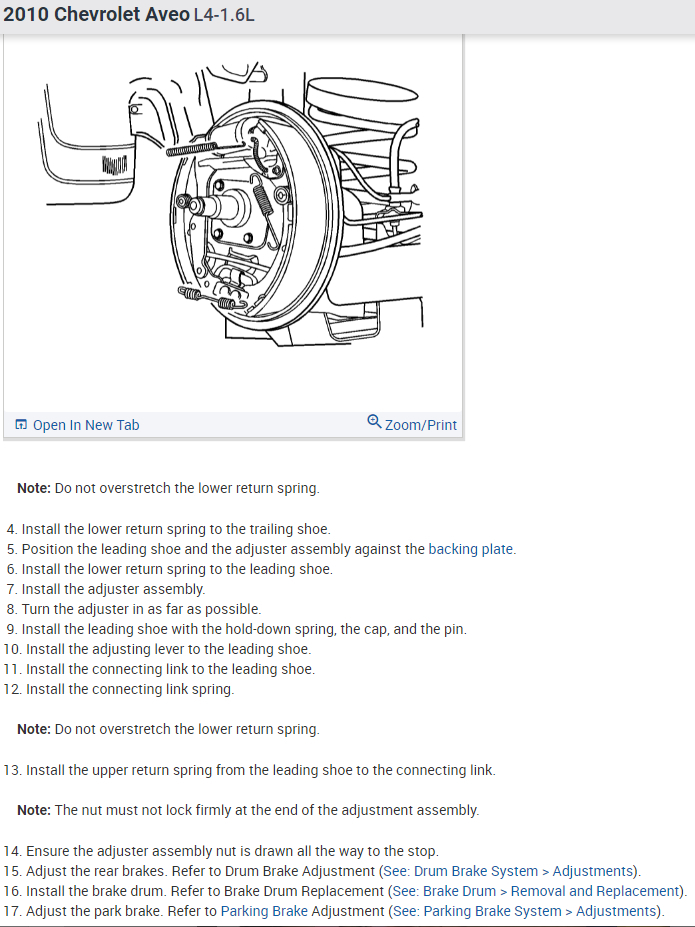

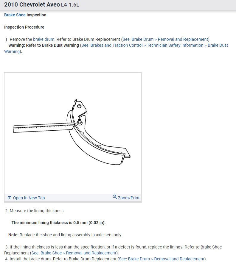

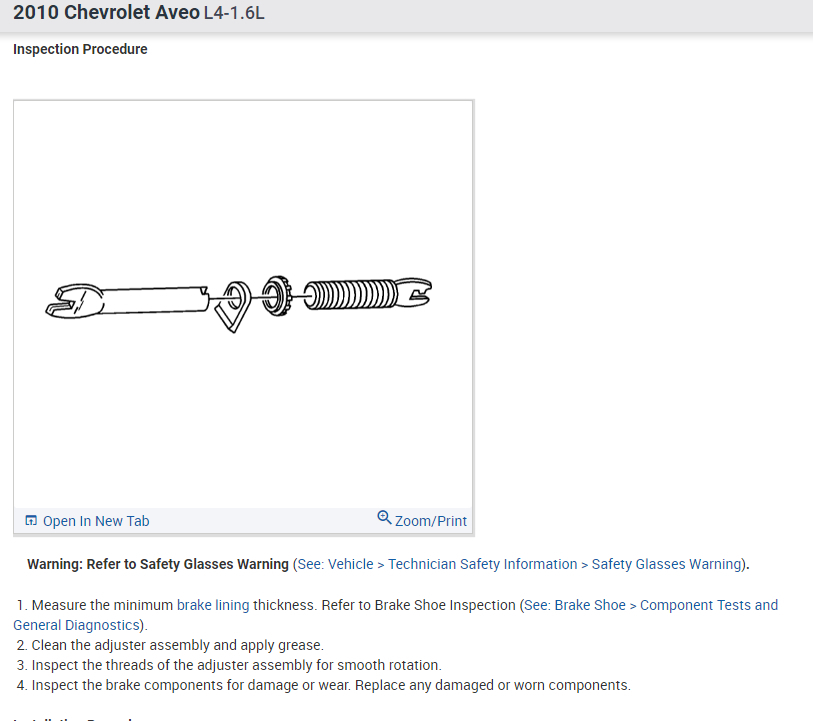

See the diagrams below for rear shoe replacement procedures. I have also included the parking brake adjustment instructions as well.

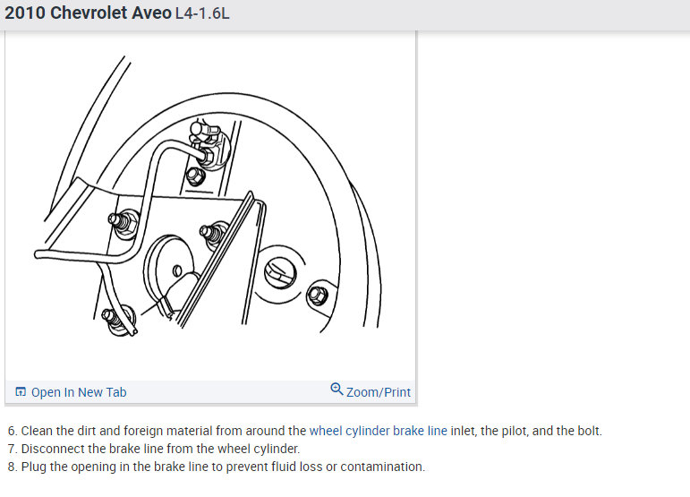

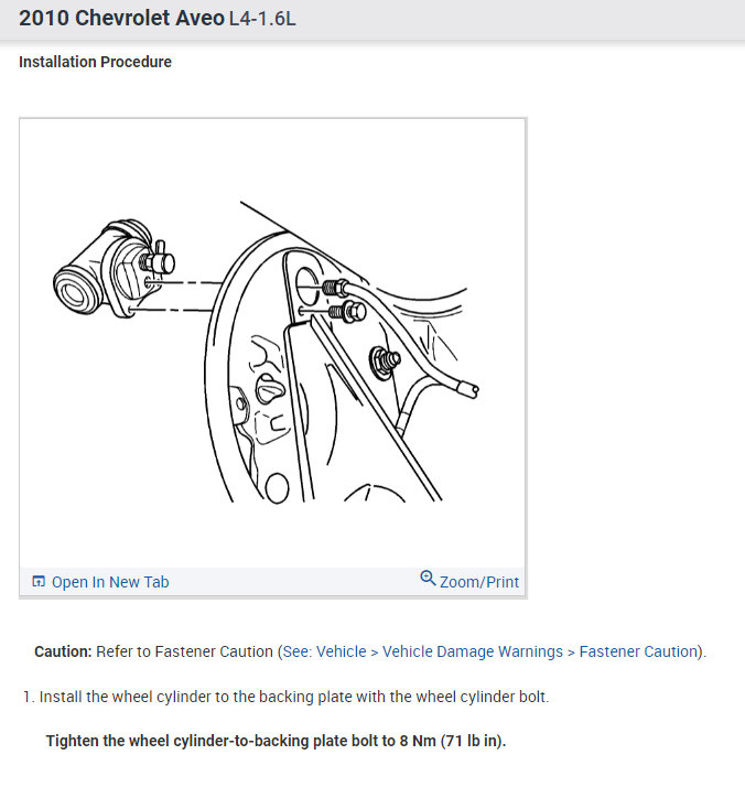

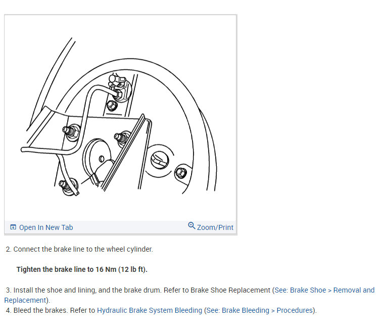

Also included the wheel cylinder replacement procedure as well, just in case you run into a issue with the cylinder.
https://www.2carpros.com/articles/how-to-replace-rear-brake-shoes-and-drums
https://www.2carpros.com/articles/how-to-replace-a-wheel-cylinder
https://youtu.be/UV0kfP17Co0
Just a note, you probably want to get a new bake hardware kit when you change the shoes, that will make it easier to finish.
