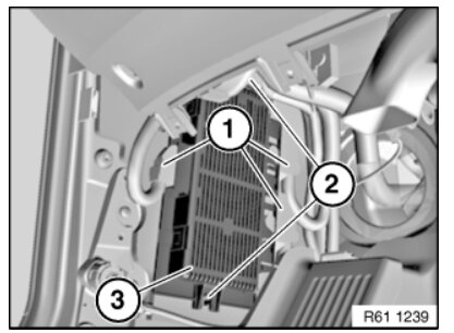

These are a lot of codes, I would clear them and then turn the system on without cranking the engine over, then run the codes again, this will give us the most prevalent codes.
E7146F K-CAN Message
440100 CONTROL UNIT: Error Complete System, 0 PERMANENT
FEM-BODY - Front Electronic Module
Also, I would check all fuses again with the systems on and if they are okay, I have seen the front control module cause all kinds of strange problems like you are having.
I would also look for water damage by looking under the carpet which is where many modules are located. Here is the footwell module location, I would disconnect the battery and remove the module electrical connectors and look for corrosion. Check out the images (below). Let us know how it goes.

Battery is fine and I have checked every fuse twice. I replaced the relay that's in front of the fuse box under the hood on the passenger side. There is no corrosion. There is no water damage. The abs, transmission codes, cylinder 2 misfire, and vvl low voltage are the ones always there.
Apr 14, 2025 at 1:06 AM
  • 54,840 POSTS
It sounds like the footwell module is out, please check out the post above, I updated it. You can get a preprogrammed unit by searching Google or Ebay. I would clear the codes and then turn the system on without starting the engine and run the codes again to help confirm the failure.
