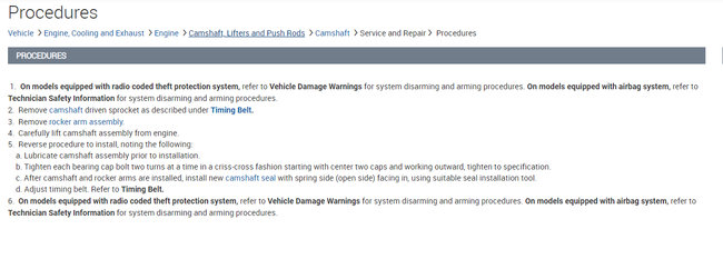

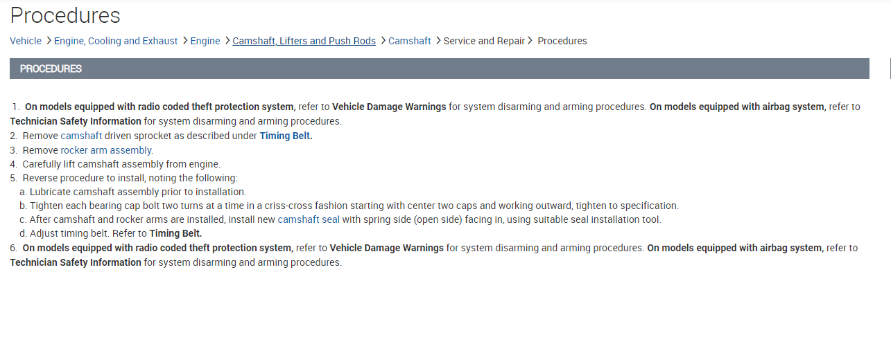

I put in a new head cylinder and now my camshaft is not rotating.
May 19, 2021 at 2:18 PM
NICKOLAOSF
  • 69 POSTS
Hi Yololife100,
Can you explain what the issue was and whether you replaced complete headset with cams or did you use old ones? please give us run down of issue. Let us know what happens and please upload pictures or videos of the problem. I am glad to help you, If there is anything else we can help you with please contact us again. Thank you for choosing 2CarPros.
also is engine 16 valve or 8 valve?
Cheers, Nick
