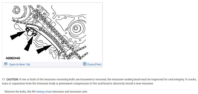

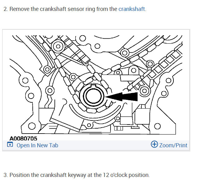

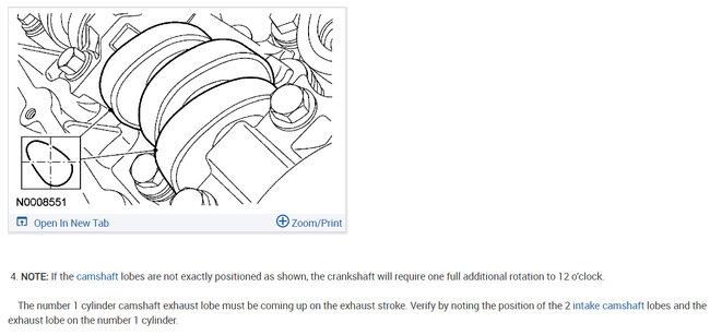

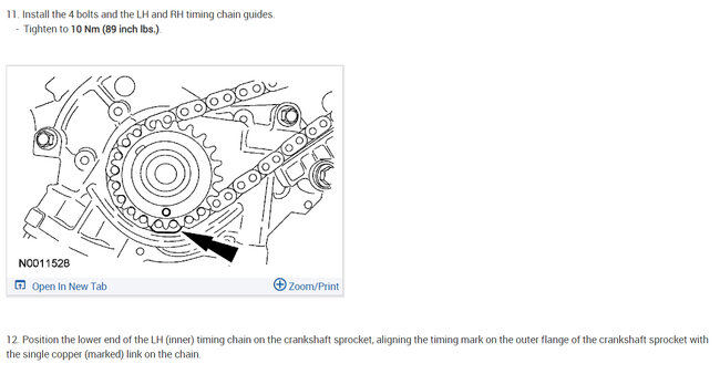

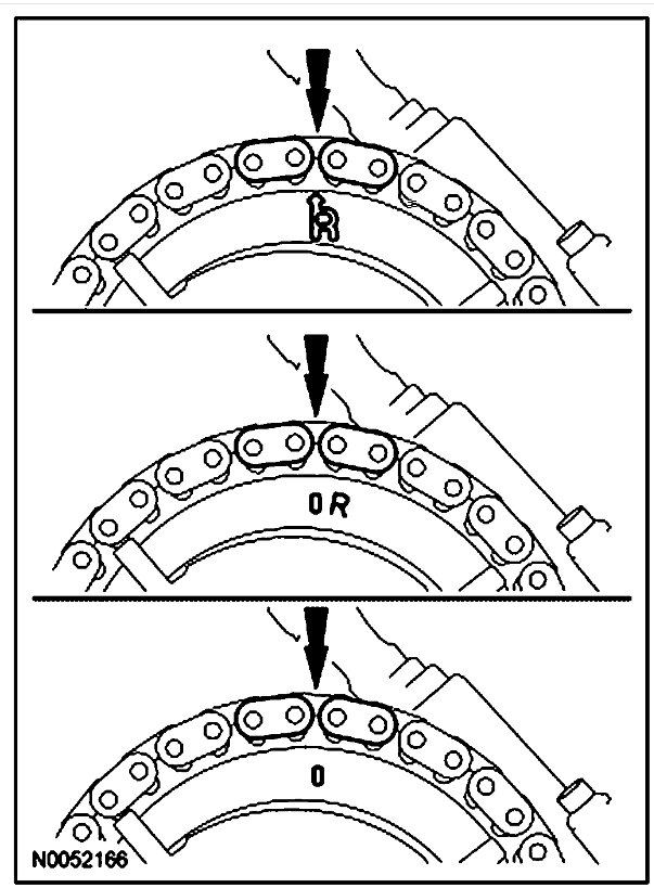

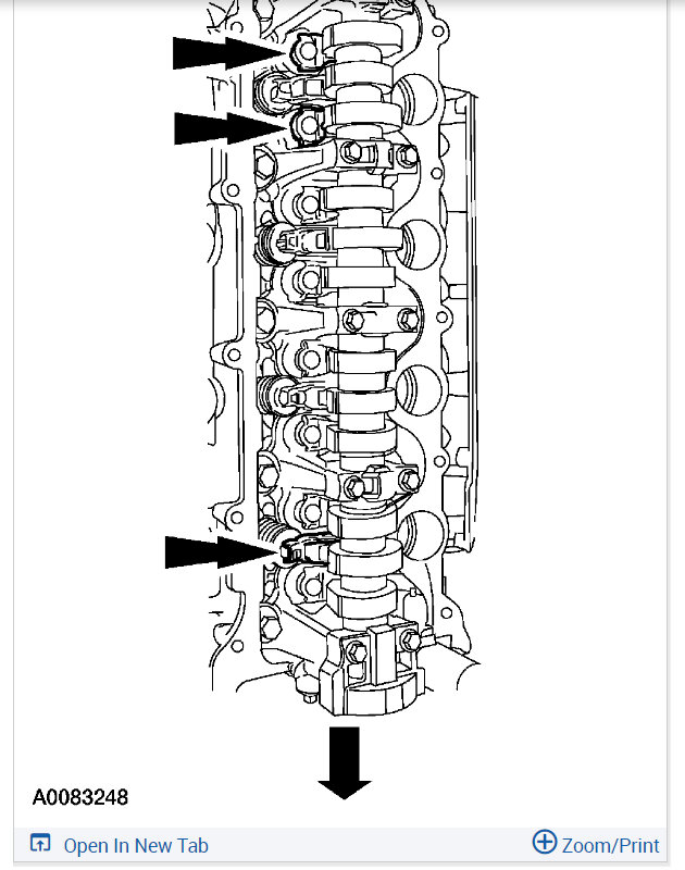

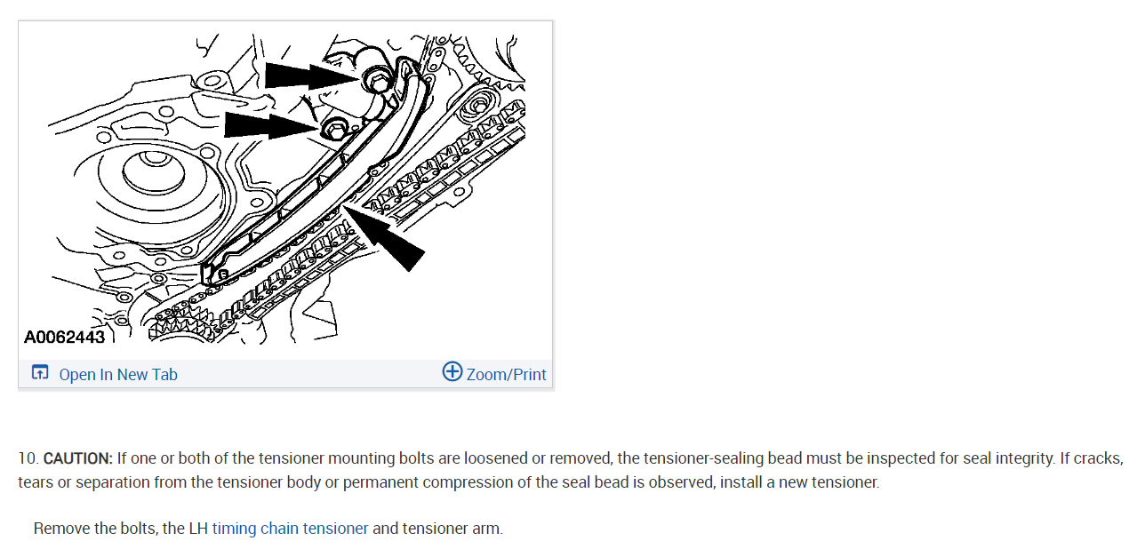

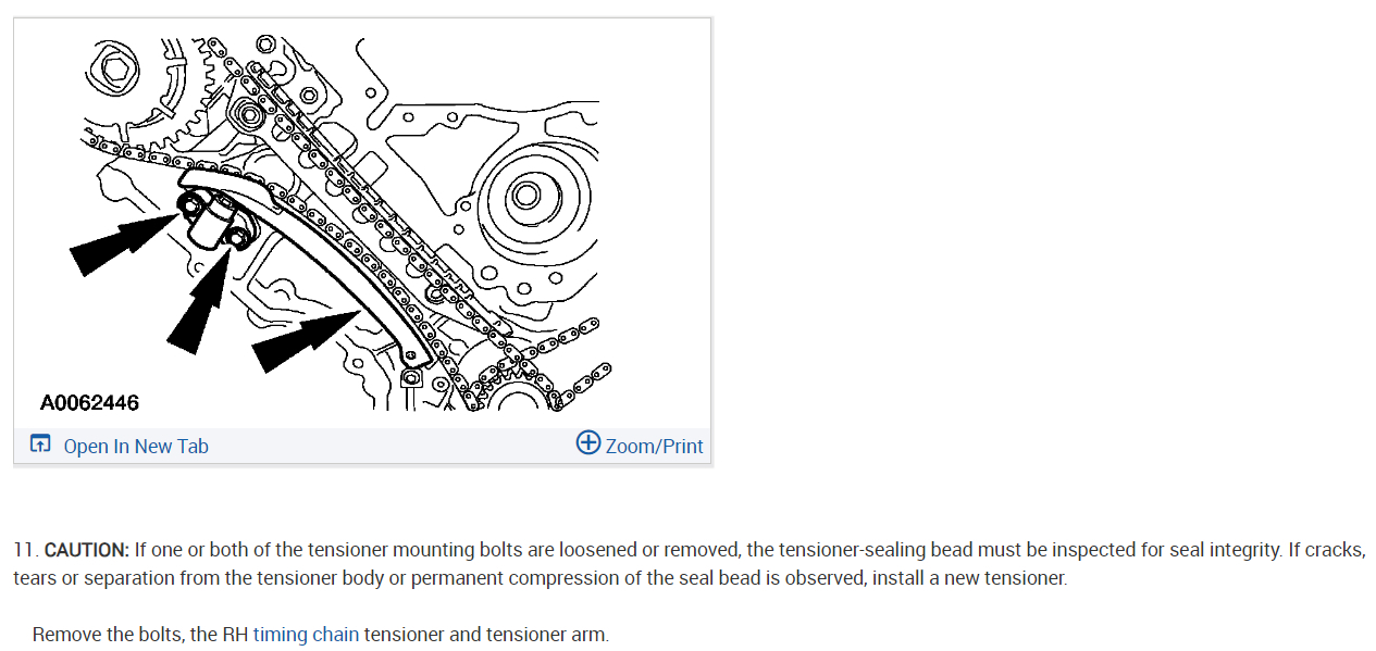

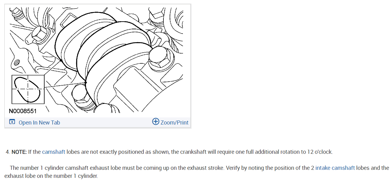

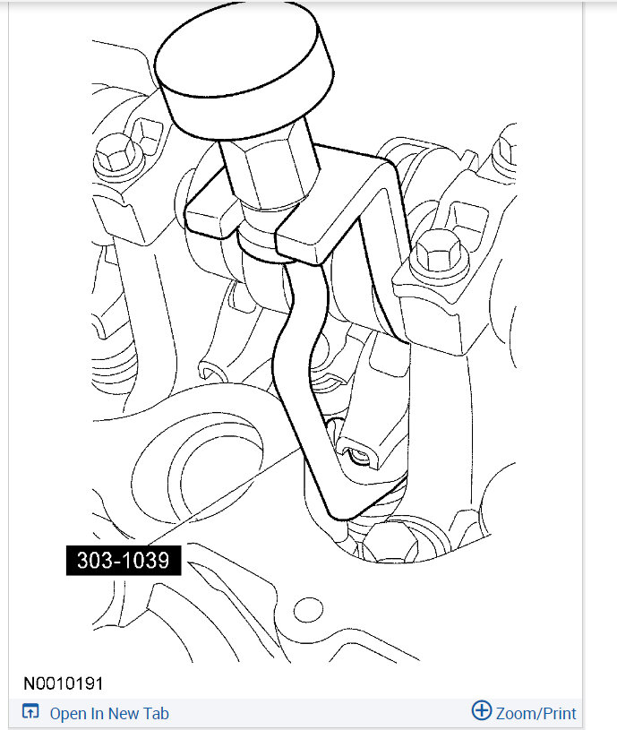

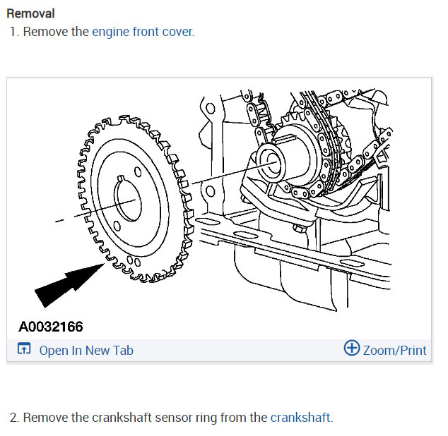

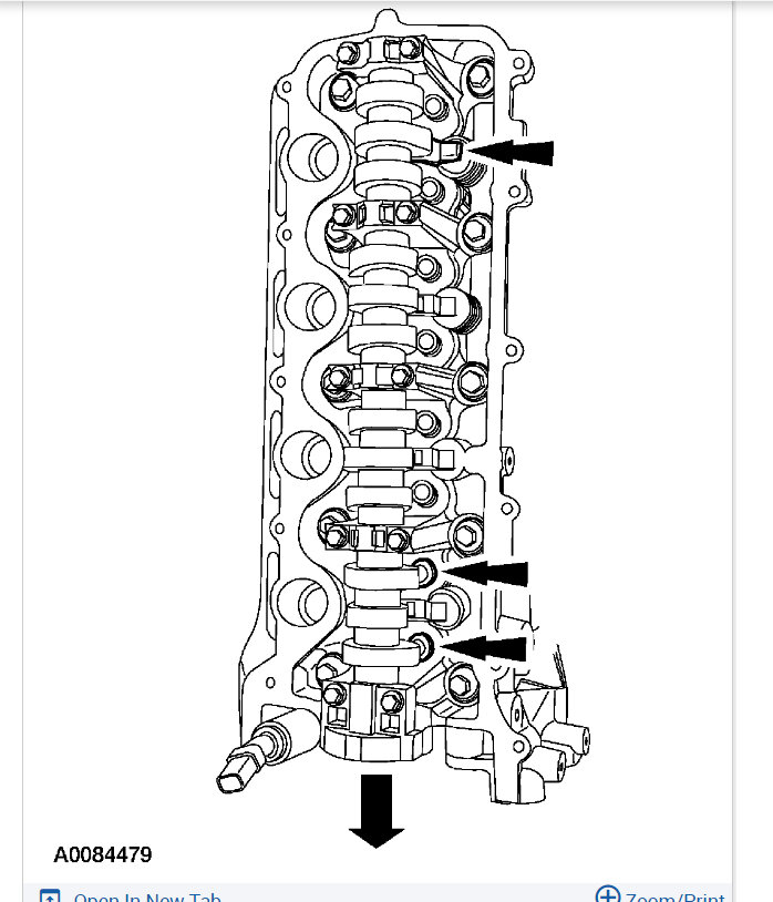

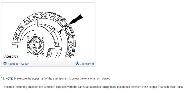

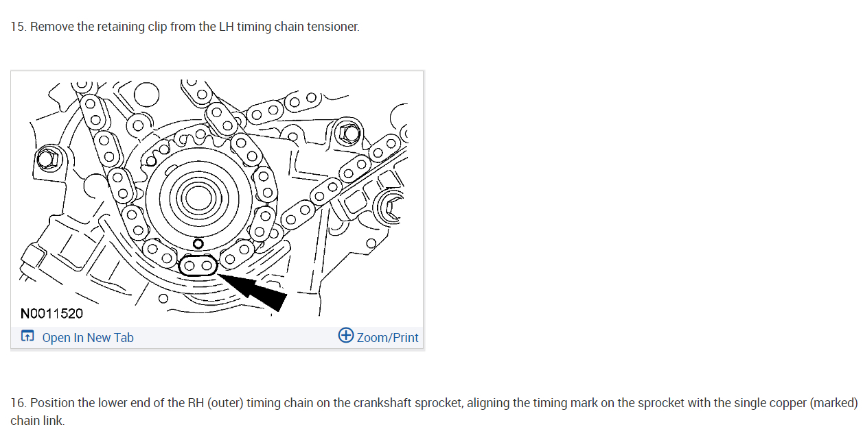

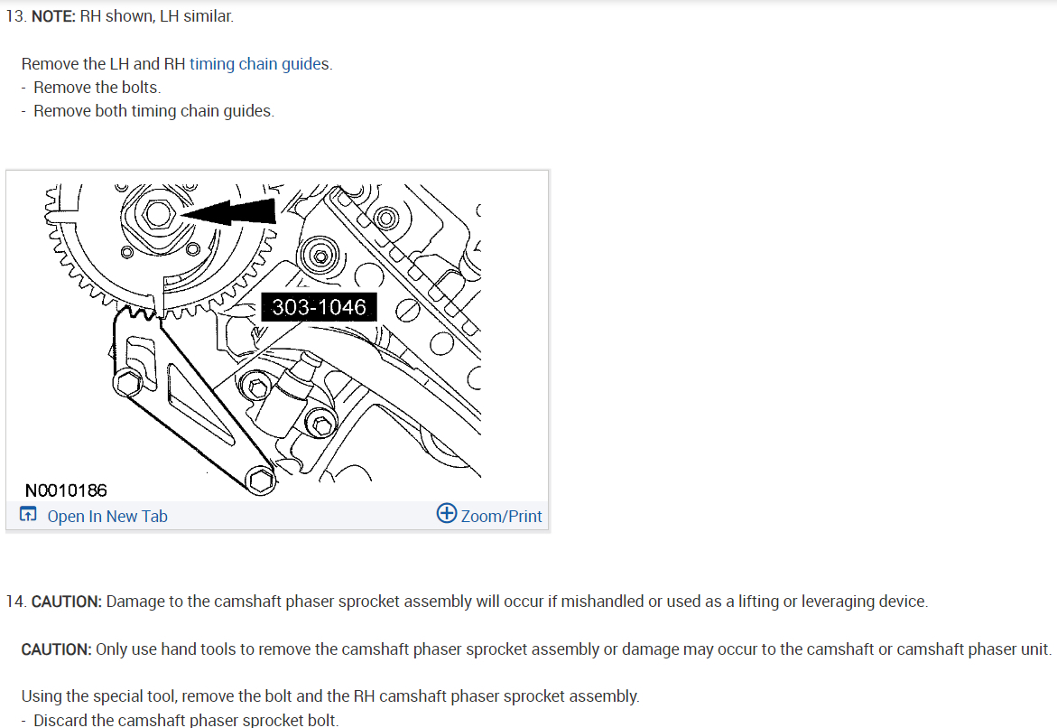

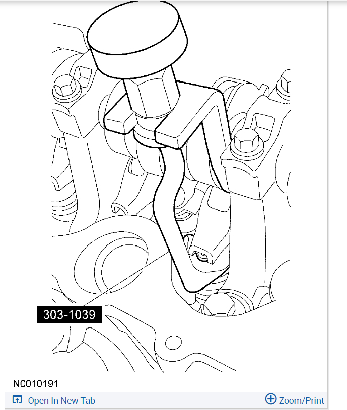

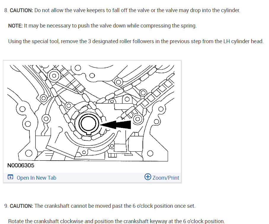

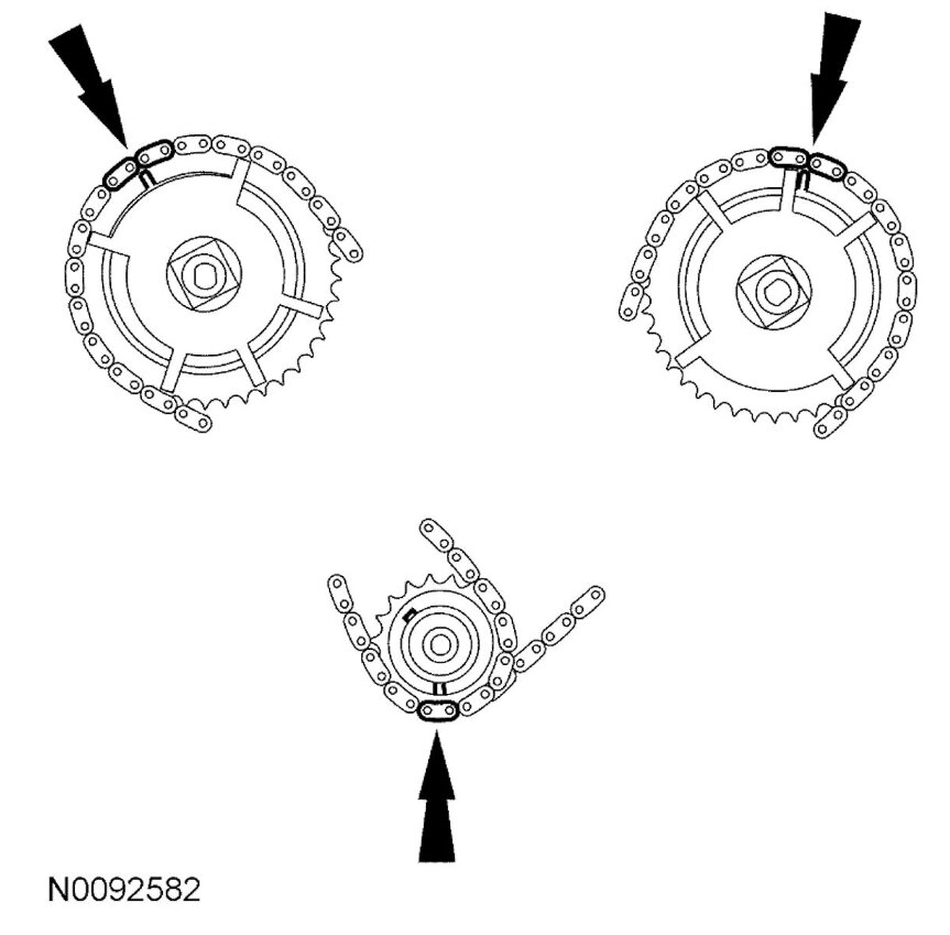

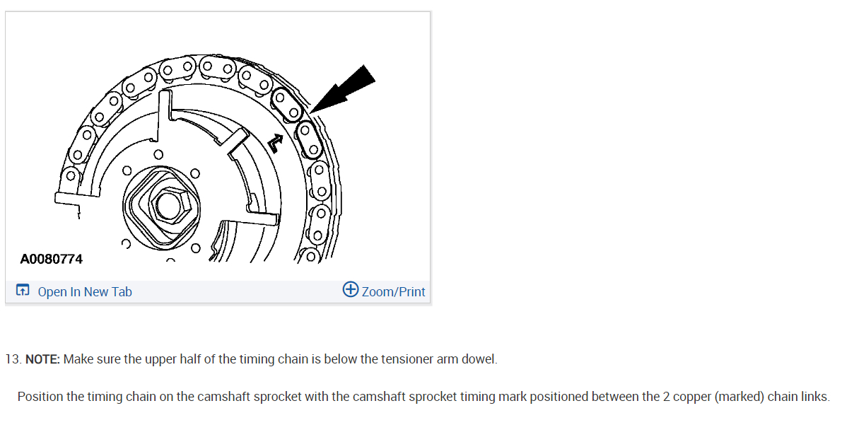

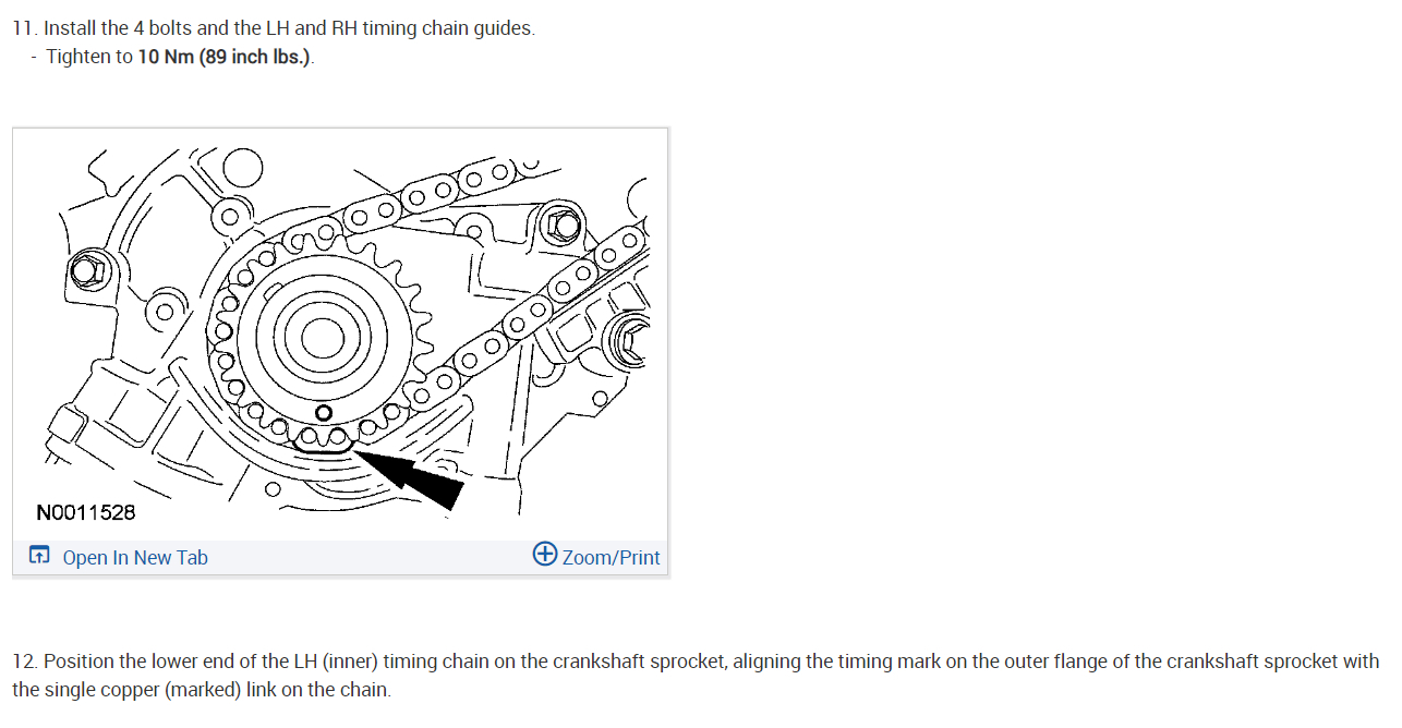

Had no oil pressure suddenly while driving highway speed. Units engine has a lot of tic and rattle noise especially at start up. But is loud as long as it's running. I have researched a bit and learned that oil pump can be faulty/weak and there's a change up. Also, that failure of cam phaser system parts can cause oil psi issues. I'm going to delete the cam phasing system. Can I get the procedures for doing that as well as oil pump replacement?
Apr 29, 2024 at 6:09 PM
  • 55,421 POSTS
Yep, the timing chain guides break and can cause this noise. You can just replace the camshaft phasers with non-movable units.
Here is a video series that will show you how to do the job:
https://youtu.be/dler2t2e4Zw?si=AhTRCnvA75mMDNdZ
Check out the images (below). Let us know if you need anything else.
