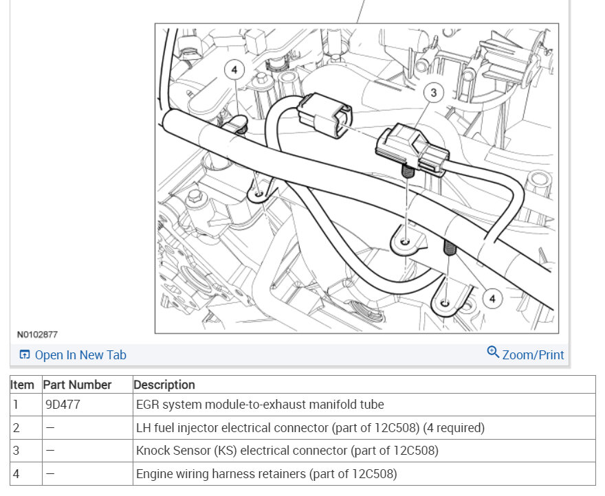

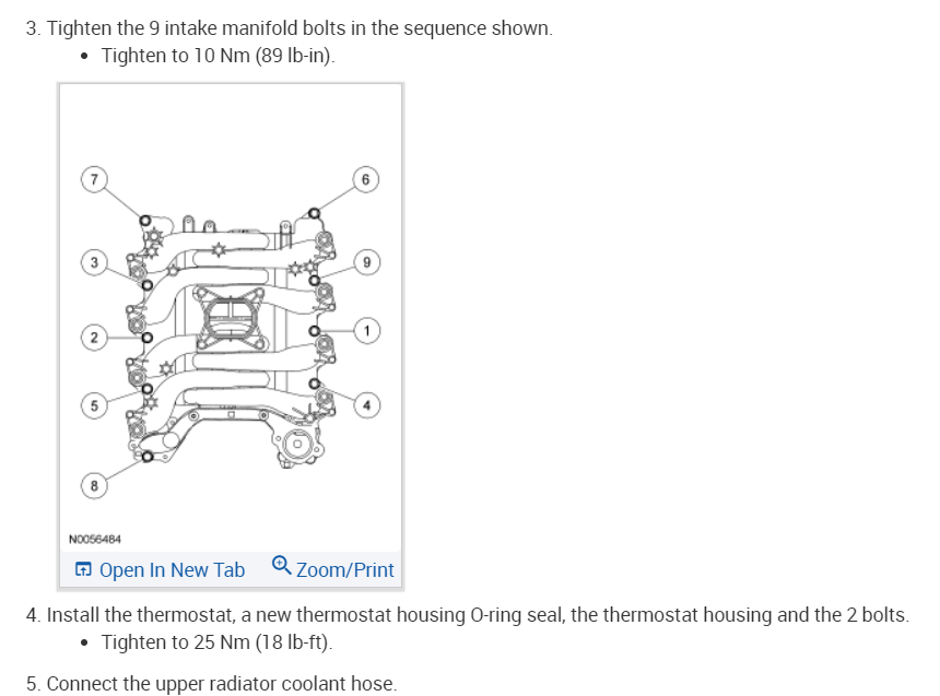

Where is the engine coolant temperature sensor located?
2010 FORD F-150
189,322 MILES • 4.6L • V8 • 2WD • AUTOMATIC
GMAN75

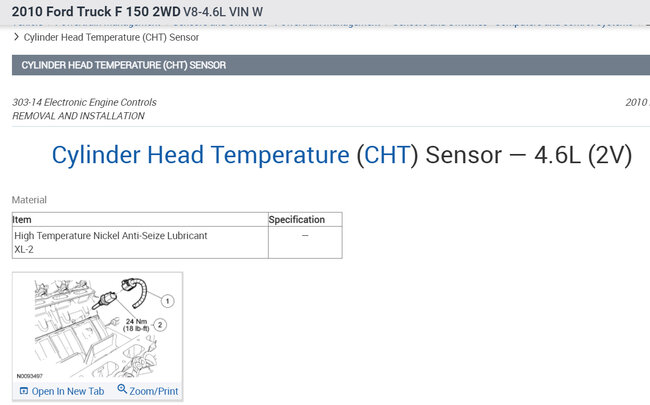

I have the truck listed above XL Triton 4.6 V8.Radiator fan turns on but not overheating. No check engine light but a wrench indicator shows up after driving for 30/45 minutes.
Oct 23, 2023 at 5:04 AM
  • 55,456 POSTS

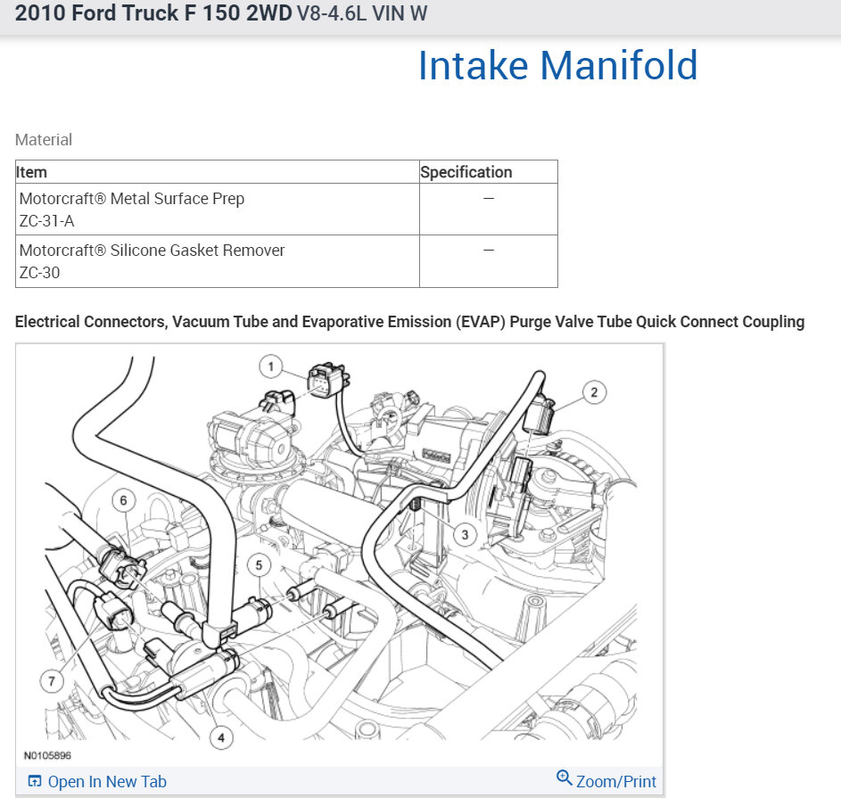

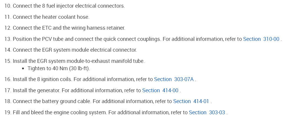

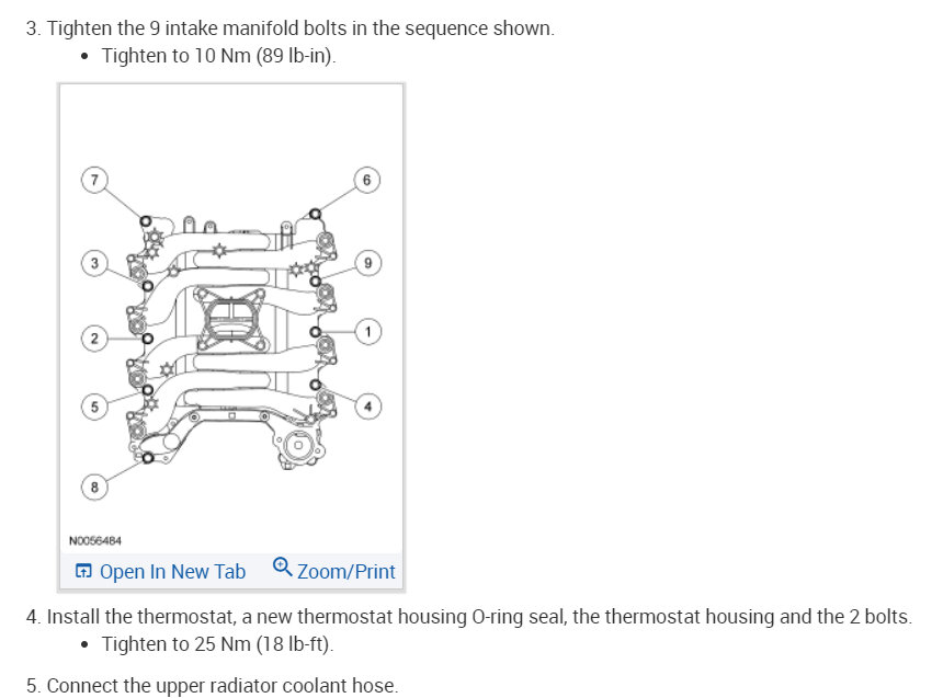

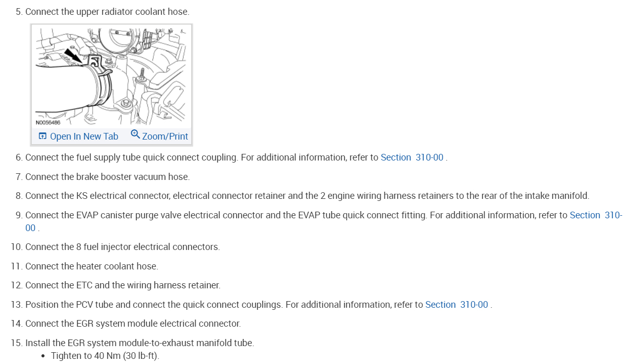

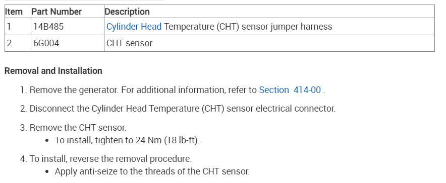

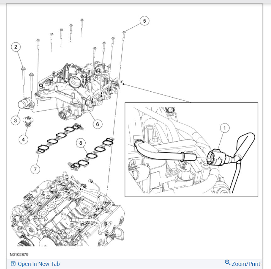

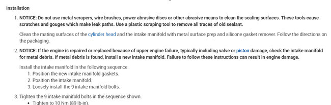

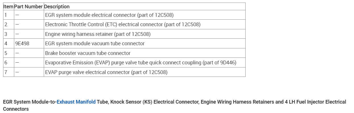

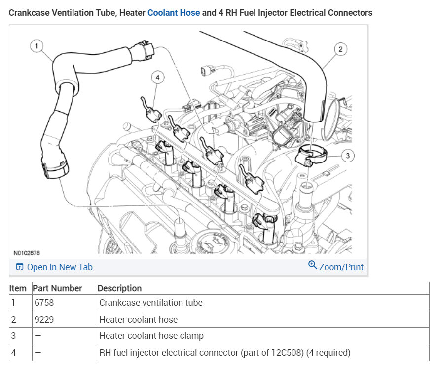

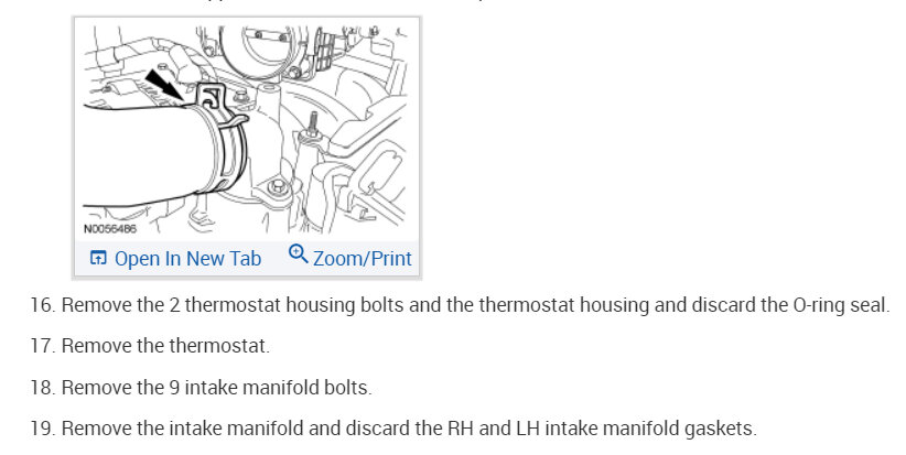

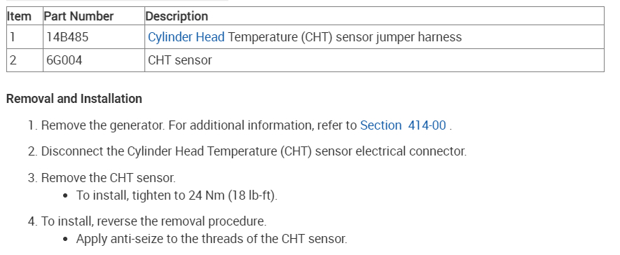

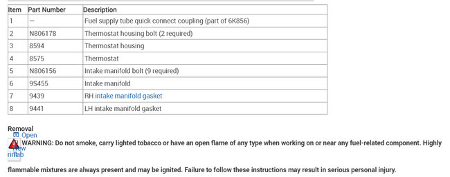

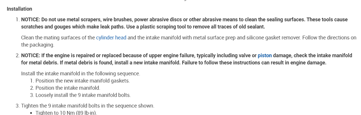

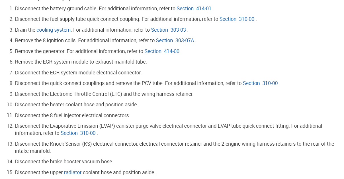

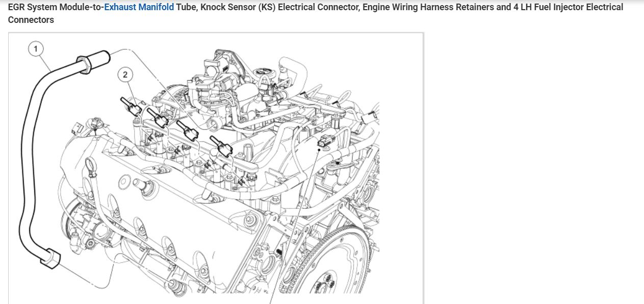

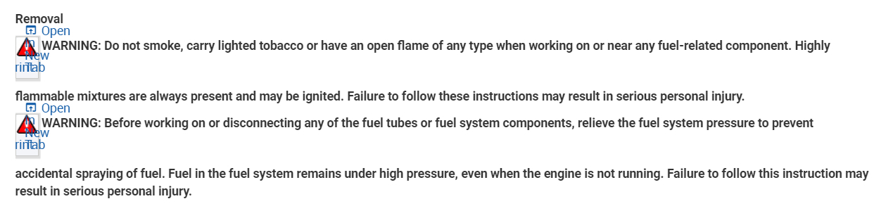

Ford changed the coolant temperature sensor into an engine temperature sensor which is under the intake manifold of the engine. The intake will need to be removed to change the sensor. Here are the instructions and how to change the sensor out. Check out the images (below). Please let us know what happens.
