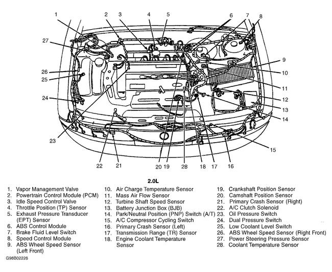

where is the crank sensor located?

This is from Mitchell ProDemand online service manuals. The sensor is number 19, near the back of the engine.

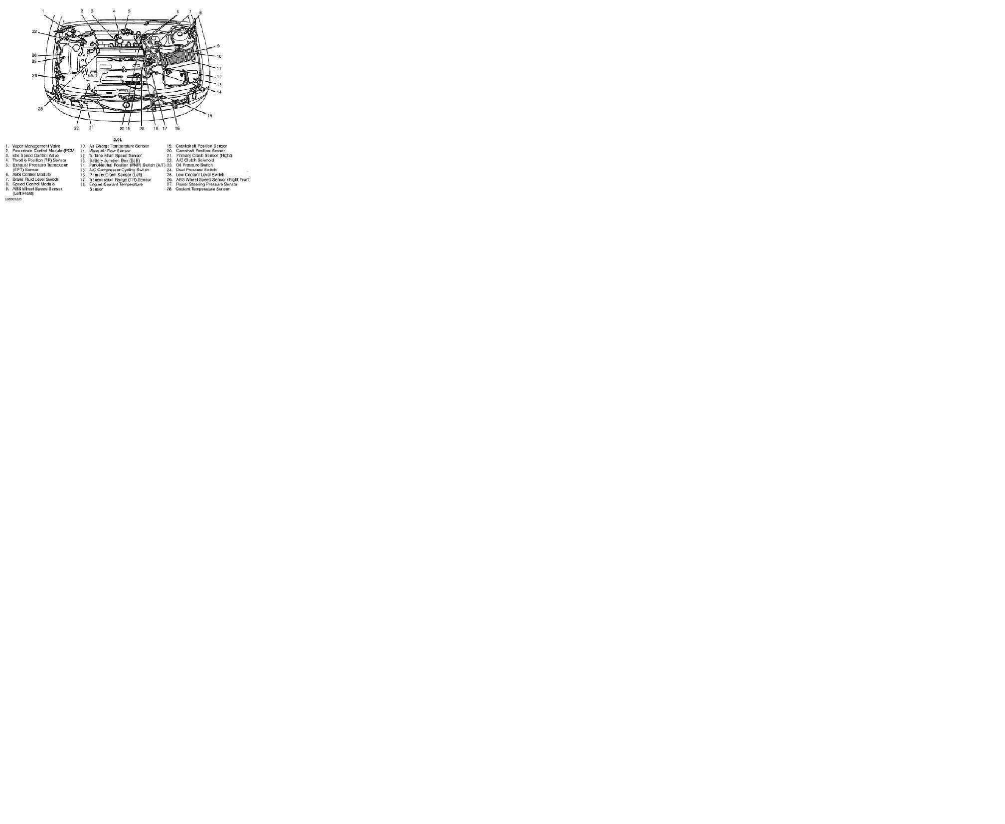

Let me try that again.
