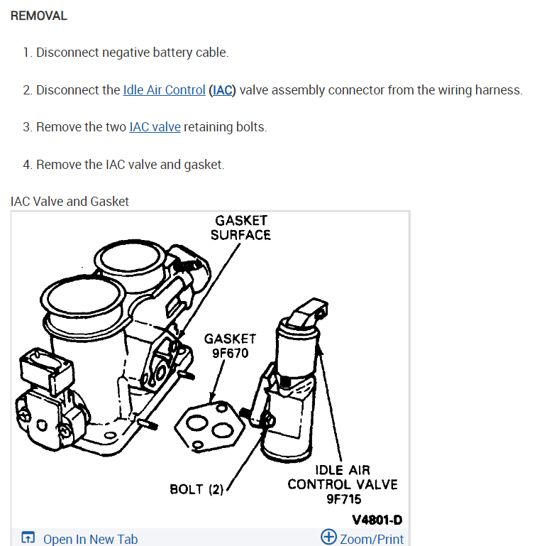

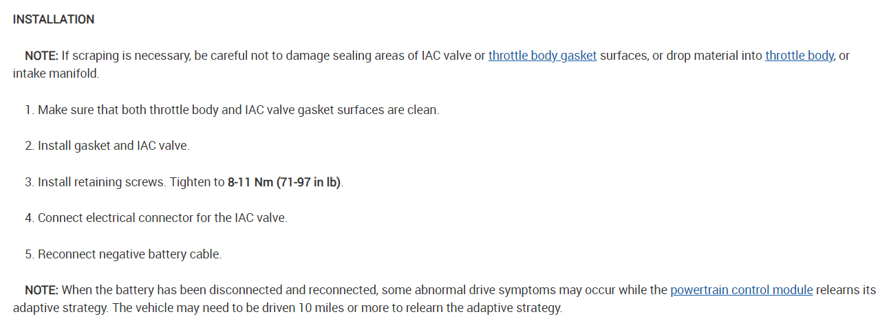

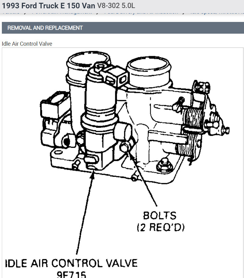

It sounds like you have a vacuum leak like the PCV hose has a hole or the IAC motor needs to be replaced. Here are two guides to help us and the location of the IAC motor in the images below:
and use this guide when the engine is cold only:
Please check the gasket of the IAC as well. Check out the images (below). Please upload pictures or videos of the problem so we can see what's going on.
