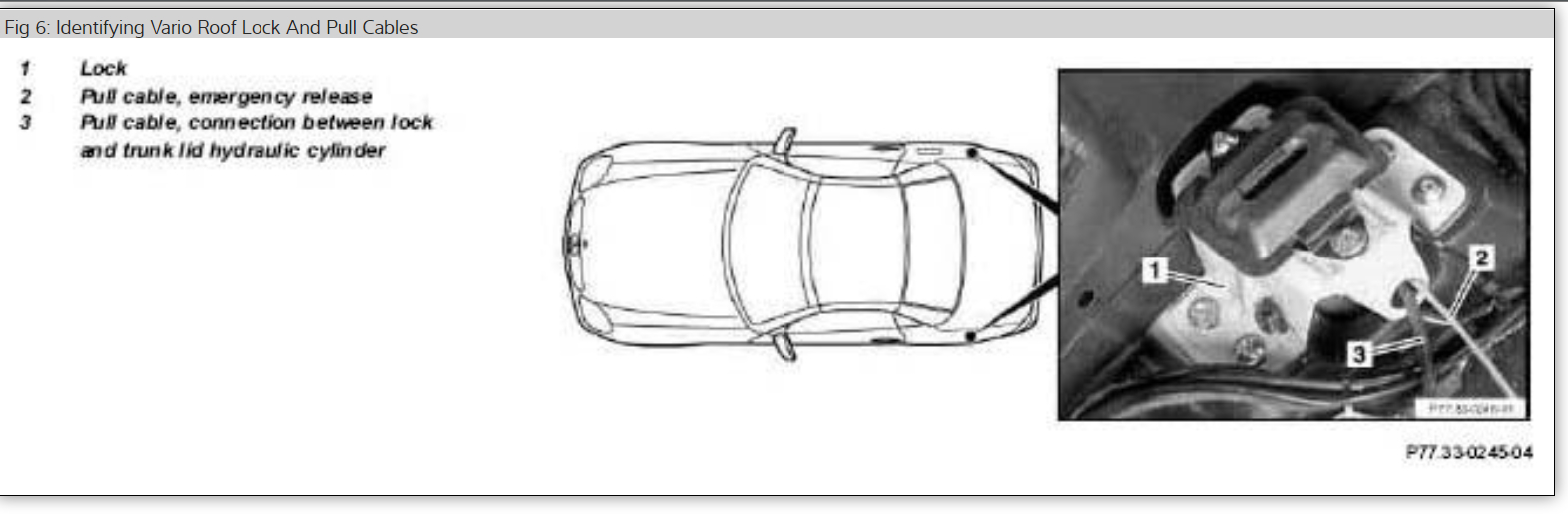

The central locking system appears to be locked down. Can access the front door with the key, but the key fob does not unlock anything (batteries are good). I cannot access the trunk with the key fob or the key. I recently replaced (few months ago) the central locking module in the trunk due to water getting into the trunk area and was working fine. I may be having an issue with the module again, however I have no idea how to get into the trunk. Tried putting in the trunk key and turning it left and pushing, that did not work. Any recommendations?

These car have a battery powered alarm module that goes out in these cars. Here is a video of the job being done.
https://youtu.be/3S0Ns3O3ULA
Here is a release guide for the trunk (below)
